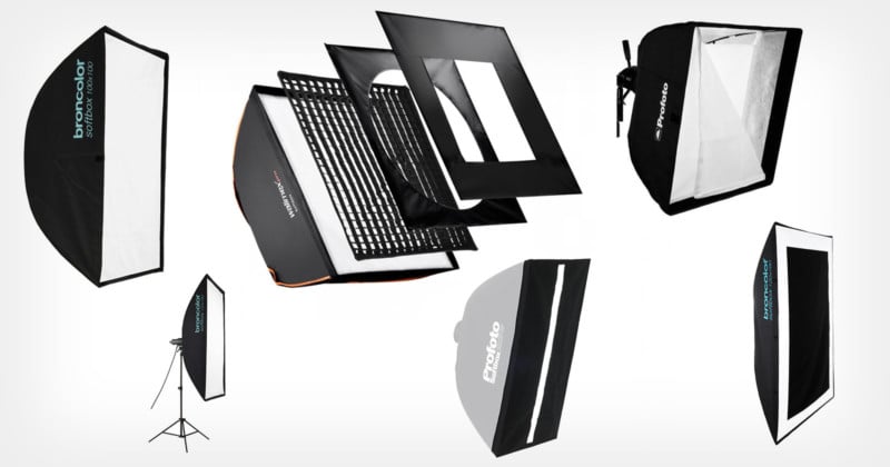

In the simplest terms, a softbox is a light modifier that is shaped like a box and produces soft light. Softboxes come in different shapes, with each one having a distinct function and look to them. Here are the most popular ones:

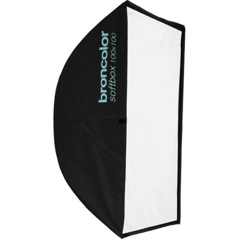

Rectagonal
As one side gets smaller and the other bigger it will produce a somewhat narrower light spread. The light will cover a larger area on one side while covering a smaller one on the other. This shape is very popular among fashion and portrait photographers for it allows to light a half-body shot without spilling light on the background too much.
A word of caution: this softbox will create softer shadow edges on the larger side while creating harder edges on the smaller side. Nonetheless, if you’re using a 4×6 softbox to light a portrait that will be barely noticeable, this will be predominantly seen when using a smaller softbox on longer distances.

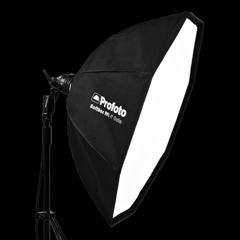

Octagonal
A classic among softboxes, the octagonal softbox is preferred to the square one for the round catchlights in the eyes. For all intents and purposes, it gives off a very similar, albeit slightly rounder and wider, light as a similarly sized square softbox.

Grid
Softbox grids often are 50deg, meaning that they limit whatever light spread the softbox has (often 180deg) to a much finer one. This, however, makes the light harder.
Soft light is defined as a light that hits the subject from a large family of angles which causes the shadow edges to be gradated. Since the grid limits that family of angles, the light becomes slightly harder. Often it is advised to move the softbox closer to compensate for this.
Stripmask
Stripmasks are made primarily for stripboxes. They make the edge finer and the light source smaller (in one dimension) This can be useful when trying to create fine reflections or horizontally hard but vertically soft light. A common use for a stripmask is on automotive photography when long but fine highlights are required.
Round Mask
A round mask will, as the name suggests, make the softbox perfectly round. Another way to control how light modifier reflections look, the round mask has its use in fashion and portrait photography. Using a round mask will make the softbox smaller, and in order to achieve the same level of softness.
Other Masks
There are also custom masks that exist for softboxes. Some will block out the center, while others can be customized. In fact, you can make your own softbox masks by creating custom gobos or using flags. The way you mask your softbox is just a matter of imagination.

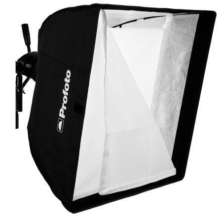

How Does a Softbox Work?
The principle behind every softbox is that it produces a light that hits the object from a wide family of angles. This is achieved by taking the point light source and reflecting it inside the modifier first through the first and then the second diffuser.
The role of the first diffuser is to take the direct specular rays and modify the angles at which they travel. However, with particularly large softboxes, this will still leave a hotspot in the middle. Often the difference between the center and side is 2-3 stops. This is unwanted, so a second layer is necessary.
The second diffuser further diffuses the light, which produces a much more even corner to corner illumination. The distance between the two layers of diffusion is relatively unimportant, but if you fancy diffusing the light even further you can shoot the softbox through a scrim placed a meter or so from the softbox.
