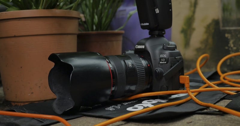

I saw the upgrade to a 5D Mark IV as a leap to new horizons. It was better in every way than a 5D Mark II, and this was truly an upgrade I wanted for quite some time. The camera had plenty of new features and improvements that made it incredibly well suited for shooting events, especially in low-light. The improved resolution was great for cropping, ergonomics made it well suited for my large hands, and the viewfinder never failed to warn me that I’m doing something wrong.
The camera is also built very well, and despite me using it in the nastiest conditions, it’s holding up. I had it dropped, soaked, and abused. So far, it’s fine and I hope it stays that way. The shutter count is approaching a milestone of 100,000. Soon, I will be adding a 5DS to my arsenal, as beauty work requires extra resolution.
The Good
The 5D series is quite special to me in general. My first big milestone job was shot on a 5D camera. The 5D Mark II, which gave me fond memories showed me that it was built to be a workhorse. The 5D Mark IV builds on that incredible legacy. It offers great build quality, with the body feeling solid. The magnesium alloy that it’s made out of survived many dings, and large crashes. So far, the only part I had to replace was the hot-shoe. If you have a screwdriver, it’s a 10-minute repair.
