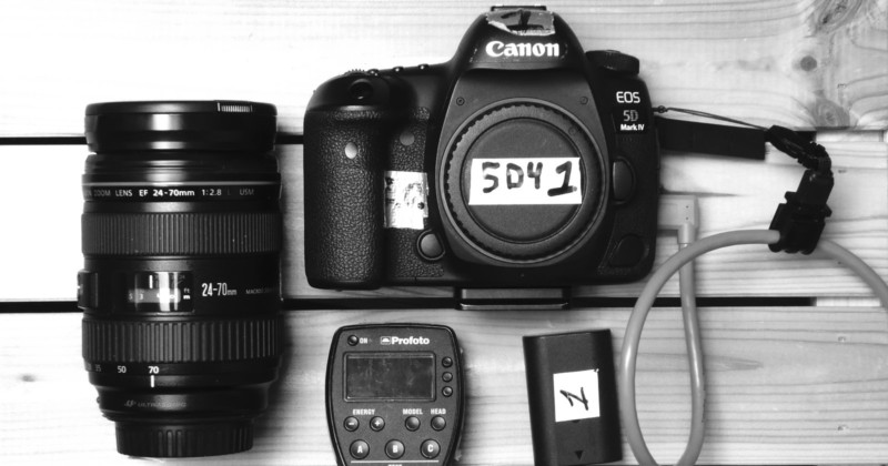

Last year, just before things got slightly out of hand, I upgraded from a 5D Mark II to a 5D Mark IV. As a fashion photographer who still shot events for a living, I was seeking an upgrade for two reasons: more resolution, higher ISO, dual card slots.
In the Canon ecosystem, the 5D Mark IV was the most reasonable camera. Come pandemic, I lost all my event work and decided to sack off that branch completely, as I had been meaning to for some time. Having shot all sorts of work on the 5D Mark IV and having seen how it performed for me, I am prepared to share my thoughts on this camera. (Spoiler: it’s a great camera.)

The first item on my list was decent zoom lenses that could do f/2.8. While it took me several years to get to, I first invested in glass, only then came the good bodies. At the moment, I own three lenses: a 16-35mm f/2.8 II, a 24-70mm f/2.8 I, and a 70-200mm f/2.8 IS I. As you can see, I don’t chase the latest and the greatest — I chase only the bare minimum I need to confidently do my work.
Overview
I saw the upgrade to a 5D Mark IV as a leap to new horizons. It was better in every way than a 5D Mark II, and this was truly an upgrade I wanted for quite some time. The camera had plenty of new features and improvements that made it incredibly well suited for shooting events, especially in low-light. The improved resolution was great for cropping, ergonomics made it well suited for my large hands, and the viewfinder never failed to warn me that I’m doing something wrong.
The camera is also built very well, and despite me using it in the nastiest conditions, it’s holding up. I had it dropped, soaked, and abused. So far, it’s fine and I hope it stays that way. The shutter count is approaching a milestone of 100,000. Soon, I will be adding a 5DS to my arsenal, as beauty work requires extra resolution.
