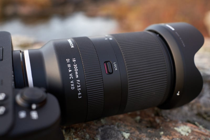

While the 18mm to 300mm zoom range in an APS-C lens (27-450mm full-frame equivalent) is very handy for traveling, it’s hard to ignore its size and conclude it’s indeed a travel-friendly lens in a traditional sense. When Tamron calls it a “compact design” and “ideal for travel” in their marketing, I think it’s plain to see the company must be speaking comparatively against carrying a bag of lenses that match everything this all-in-one zoom does. It’s not compact, but I can see it being more compact overall than dealing with that.

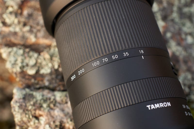

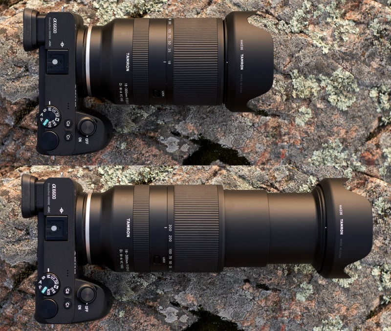

The lens measures three inches (7.6 centimeters) in diameter and is 4.9 inches (12.4 centimeters) long when set to the 18mm focal length. Extending out to 300mm, the lens increases in length to eight inches (20.3 centimeters). Overall, the 18-300mm weighs in at one pound, six ounces (620 grams).

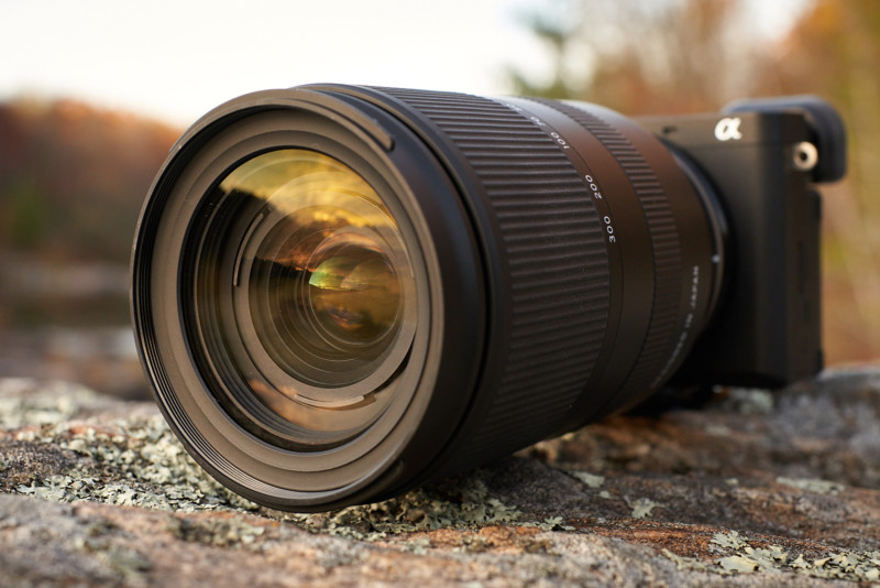

The exterior of the lens is plastic and has a large rubberized zoom ring on the end, a zoom lock switch, and a thin plastic focus ring. Although the lens does feature vibration compensation (VC), there is no on-off switch on the outside, nor is there an AF/MF switch or any other control; these are toggled using the camera’s menu system.
Tamron does mention the lens has a weather-sealed construction, including gaskets for the front element, zoom and focus rings, and rear mount. A lens that zooms out an extended three inches is sure to pick up some dust and moisture eventually, so it’s good to see Tamron add in protection here for when it’s collapsed. The front element features a fluorine coating for easy cleaning, which is nice but fairly standard.
