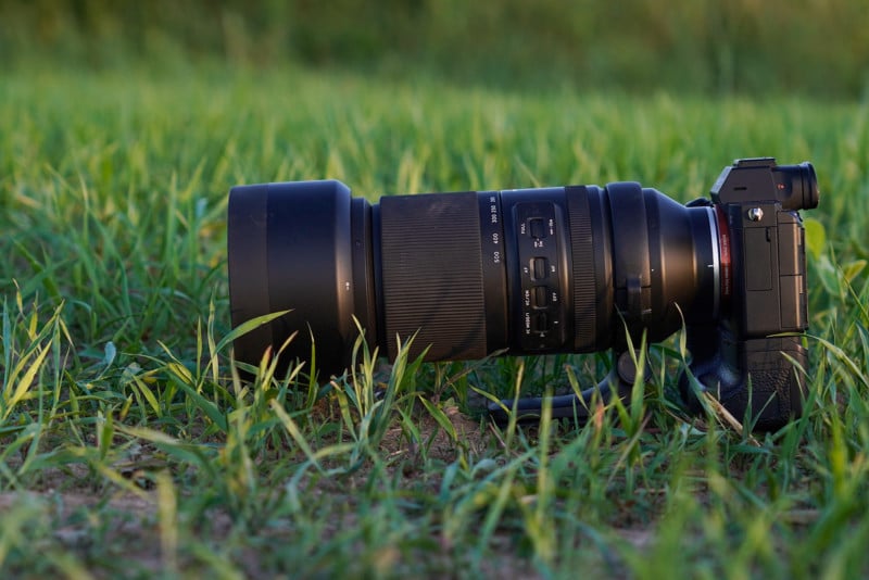

Design and Build Quality
My first impression of the 150-500mm is that it’s a great-looking lens. I appreciate the black semi-matte finish on the plastic exterior which blends in much better than the off-white that is not uncommon for these focal lengths. The removable tripod collar is metal and has a texture that matches extremely well with my trusty Sony a7R III camera, which I used for this review.
This lens does extend physically as it zooms. At the short end, it’s 8.3 inches (209.6 millimeters) long and all the way out its 11.1 inches (283 millimeters). In total with the tripod collar included, the lens weighs 4.1 pounds (1.86 kilograms). Overall, it has a comfortable balance and throughout my shooting time with it, it was only used handheld (aside from aperture tests). Even more modestly-sized camera backpacks should be able to fit this in with the hood reversed and camera attached.
Taking a closer look, I noted a number of interesting features in the design and functionality that are worth discussing.

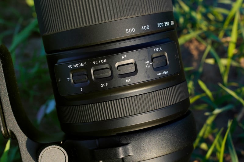

Switches
Aside from the zoom lock switch I just mentioned on the righthand side, there’s a panel of switches to be found on the left. These include a focus limiter switch, focus mode switch, vibration compensation (VC) on and off toggle, and a VC mode switch. The switches on this lens are the best tactile experience I’ve had when compared to any Sony or Canon lens. Because of the perfect tension and size, even the three-stage switches easily set to the middle without accidentally skipping to the next setting.
I’ll go over vibration compensation in a more detailed section below, but right now I want to point out the focus limiter. Most focus limiters I’ve seen have three modes: One is for the full focus range, one is for infinity to a certain distance, and the last is for close focus to a certain distance. In contrast, the Tamron 150-500mm forgoes that last close focus option for a second infinity-to-distance mode, which means it offers the full range and either infinity to 15 meters or infinity to three meters.
As a bird photographer, focus limiters are a tricky matter that I don’t ever really use for a few reasons, but paramount is the fear I might miss something spontaneous. What Tamron has done here — I believe — is a nod to sports photographers who always have absolute certainty where their subjects will be. If they’re shooting from the sidelines of a game, they will likely need to be back at least three meters for safety. If they’re shooting from the stands, that’s a guaranteed 15 meters away. These are just a couple of easy examples, but taking away a close focus limiter speaks to the type of photographers the company either worked with closely while designing this or the type of shooter it envisioned using the lens.

Image Stabilization
The Tamron 150-500mm does have an image stabilization mechanism — Tamron calls its technolgoy Vibration Compensation — and offers three different modes that are controlled by a switch on the side of the lens.
Don’t skip this part because these are not exactly the modes you might be thinking they are.
Traditionally, Mode 1 would be full compensation vertically and horizontally, Mode 2 would be for panning and compensates only for vertical movement, and then Mode 3 only activates horizontal and vertical stabilization at the moment of capture and does not compensate until only then.
With this lens, Mode 2 is unchanged and is still the mode to use for panning shots. Modes 1 and 3 are different, and a little strange. Mode 1 acts as described above, however, its strength of compensation is not very impressive, especially when shooting at 500mm. I think of it as a soft image stabilizer that allows for a lot more play with the lens and doesn’t tie you down to always making sure you’re in the right mode for the shot.
Mode 3 gets really weird. The level of compensation in both directions is extremely good. It’s much, much better than Mode 1. However, it’s active all the time. Even without half-pressing the shutter or using back-button autofocus — without touching the camera at all — it’s on. As you can imagine, this is not ideal for a long-lasting camera battery to be walking around with the lens in Mode 3, but as noted it’s also the mode to be in for the best compensation. So, generally, I used it. Ideally, I would like to see Mode 3 only active when I’m ready for it.
One last note is about the constant noise of this lens. Many stabilized lenses have some sort of hum that is produced once that image stabilization kicks in. Oddly enough, the Tamron 150-500mm is noticeably whirring away all the time and only quiets down a touch when it’s stabilizing. After two weeks of getting used to it, I’ll admit it’s a little less obnoxious now, but it was almost unbelievable when I switched over to this lens initially.
