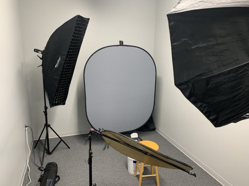

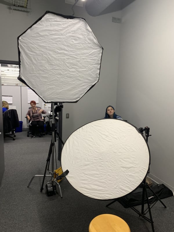

Next, I set up a test set up in my home and played with my lights until I could duplicate the company’s existing style. I just shot myself and turned around my computer monitor for feedback. The basic look was fairly flat lighting with no real shadows. I decided to go with a large octo above and reflector below, essentially a clamshell setup.
To aid getting people in and out, I set the reflector to one side to create a path in for the people on the other. The backlight would be opposite the key, with the reflector filling the in-between and beneath the chin. It was not too hard to work out the final lighting, but it sure helped me mentally to know I had a firm plan on where to go and what to do to get what I was aiming for.

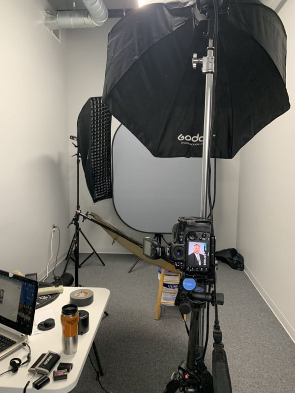

The next morning, I went through the truck again. Once everything was set, I picked up my assistant and headed to the shoot. We arrived 30 minutes in advance and started setting up. The company liaison was there, and my assistant compared her list to the final shoot list. The first person showed up 10 minutes early and I did my final light setup on him.
This is not a fashion shoot. Shooting the employees at f/1.2 was not in the cards. Based on my tests and what I know about the lens I used, I wanted at least f/7.1 for a decent depth of field with a max at f/11. Because I knew I would be shooting a lot, I wanted to keep the strain on my flashes down, so I decided to shoot with power settings of 1/4 to 1/8 power. In my tests on-site, I could hit these numbers with an ISO of 200, which is fine on a Nikon D810

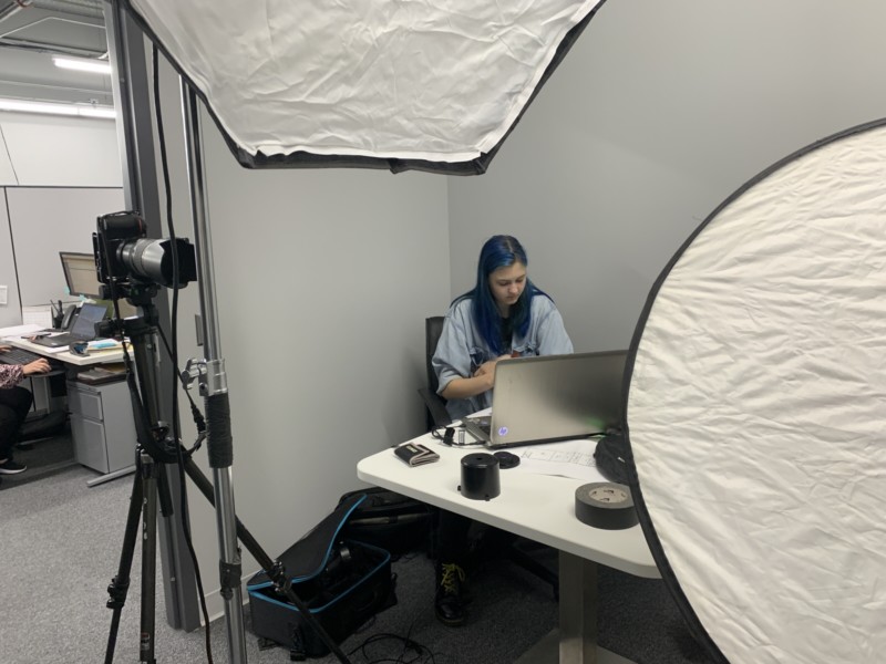

Having an assistant was great. I could focus on photography while she took care of names and photo numbers and syncing that all up.
