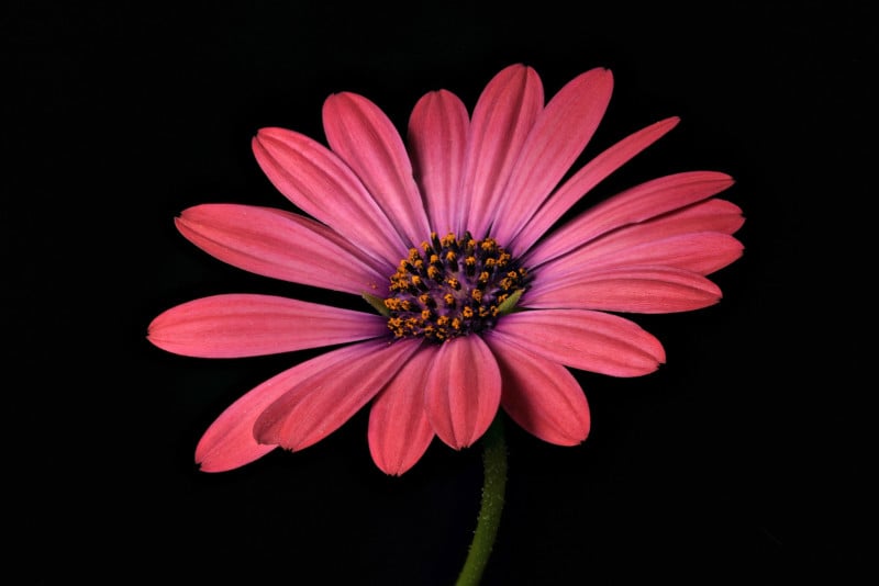

Osteospermum

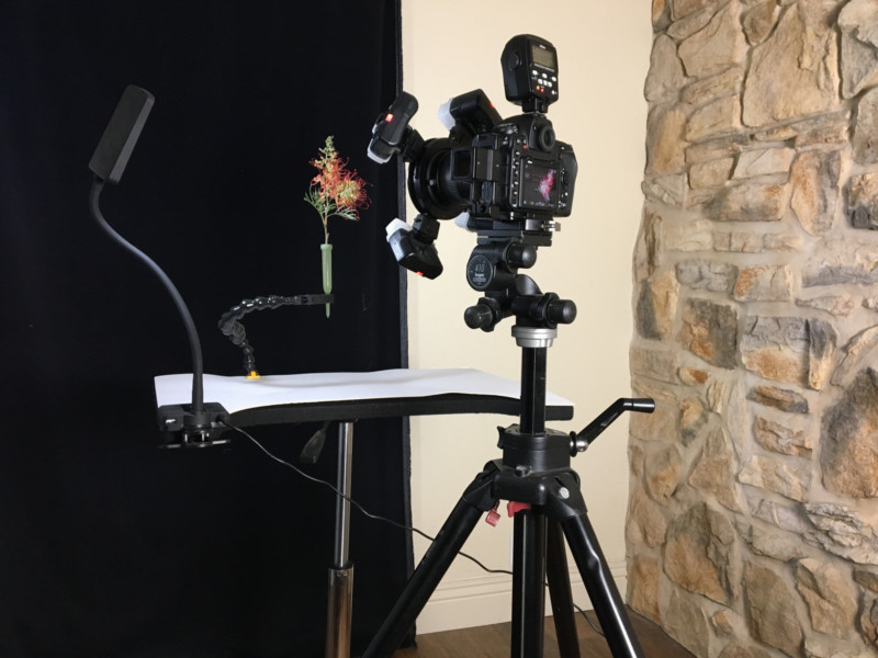

I created a portable studio onsite at The Huntington. The centerpiece, of course, is the Nikon D850. I modified the camera with a Nikon DK-17M Magnifying Eyepiece which makes it easy for me to see details through the viewfinder. I also use the LCD screen preview and zoom in to ensure sharp focus. I sometimes use the Hoodman H32MB HoodLoupe Glare Free Viewing Loupe Optical Viewfinder for D-SLR 3.2″ LCD Displays to magnify the display.
For lighting, I use the Nikon R1 Wireless Close-Up Speedlight System with four or five SB-R200s attached. I diffuse the light with Sto-Fen OM-SBR200SET Omni-Bounce diffusers. To scatter the light even more, I cut up small pieces of thin packing foam and place them inside the diffusers.
The camera is placed on an old Manfrotto 3251 tripod. Unlike the light carbon fiber Gitzo I use in the field, I like this Manfrotto tripod for studio work because it is heavy and doesn’t move even slightly when I am shooting a stack — and I can’t knock it down in my clumsiness. I also use a Really Right Stuff L-Set bracket for Nikon D850 attached to the camera and a Really Right Stuff plate on the tripod head.
I use a posing table with flat feet (no rolling casters) and place the subjects on the table in a vase. I use Wimberley PP-200 plant clamps to keep the plants steady and to position with precision. I use floral water tubes for single stem cut flowers to keep them hydrated; they can easily be inserted into the Wimberley plant clamps. I use an LED table lamp as a modeling light. I clip the light to a cheap tripod near the posing table to help me focus, and then I shut the light off before shooting.
I set my background several feet back from the posing table. If I am shooting against a white seamless paper or green screen background, I illuminate the backdrop with two Elinchrom Portalite strobes. I do not diffuse or modify the light because it will be diffused by the backdrop and I do not want to waste energy.

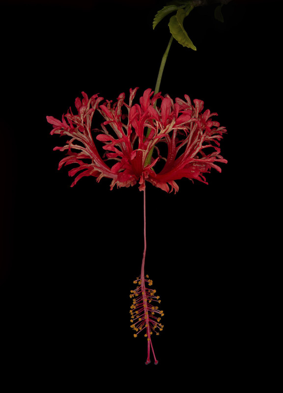

Hibiscus schizopetalus

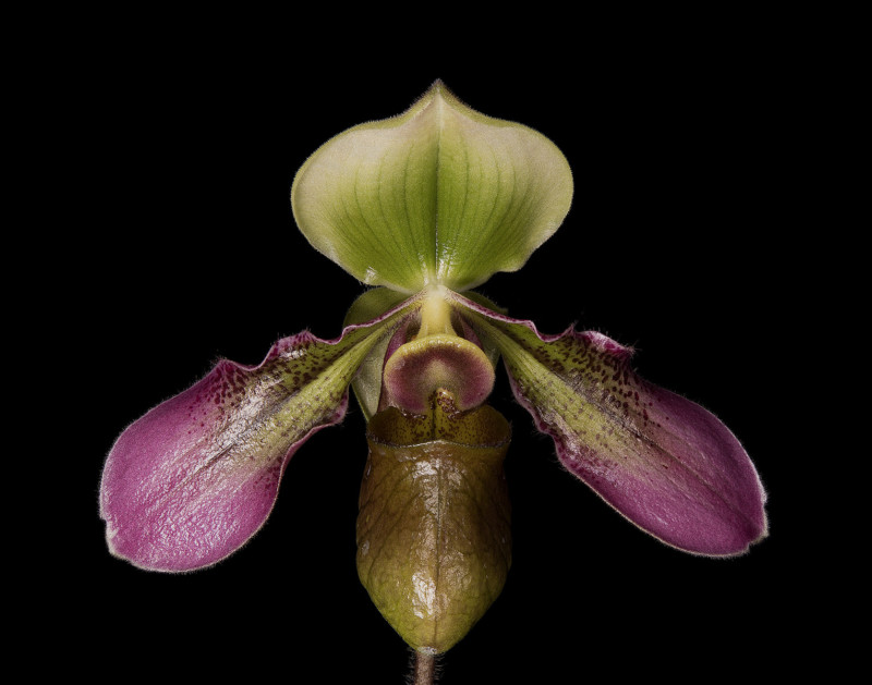

Paphiopedalum collosum

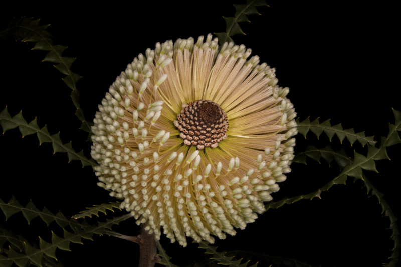

Banksia speciosa

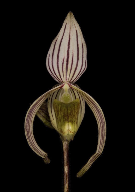

Paphiopedalum hookeri
