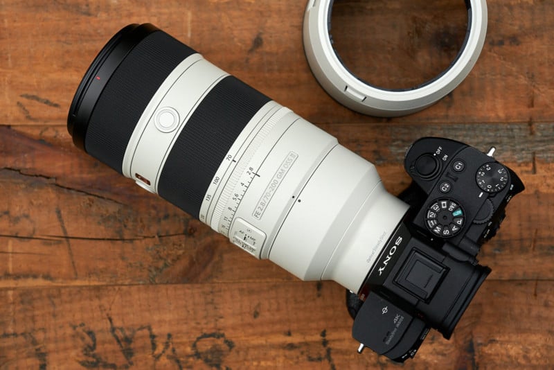

While the new Sony 70-200mm f/2.8 GM OSS II brings significant developments over the original, its overall size is still the same. That puts it at 7.87 inches (200 millimeters) long and 3.46 inches (88 millimeters) in diameter. Its weight, however, has dropped from 3.26 pounds (1480 grams) to 2.30 pounds (1045 grams). Additionally, this weight is now centered right at the tripod foot for better balance.
Looking at the exterior, the lens has a good-sized focus ring at the front end. I find it easy to manipulate with just one finger while the rest of my hand can be gripping around the zoom ring for flexible control of the lens. Paired with a Full Time DMF (direct manual focus) switch, the focus ring can be enabled to always be active regardless if the camera is in an autofocus mode. One negative that stood out is that this ring seems to make a pronounced grinding sound when being turned that’s louder than any of the other lenses I have or have tested.
Moving to the zoom ring, it is slightly wider than the focus ring and has a good amount of tension to it. Paired with the fact this lens internally zooms and that the weight is not at the front, rather toward the back near the camera, I did not experience any zoom creep while walking around.
Behind the zoom ring is something that Sony has never done for a zoom lens before: added an aperture ring. The aperture sweeps the range of f/2.8 to f/22, of course, plus there’s an “A” setting to have the f-stops be set by the camera instead. Along with the aperture ring, the lens now has an Iris Lock switch on the bottom left side. This switch can lock the ring into staying on the “A” setting, or instead, it can lock the lens into the manual f-stop range but not allow it to accidentally cross over into “A.” On the bottom right, there’s an aperture de-click switch.
Some other quick notes to make about the build is that the quick-release tripod foot shamelessly still does not have a built-in Arca-Swiss plate as we’ve seen from competitors. It also does not have grooves at the horizontal and vertical positions that allow me to precisely change orientation without looking at the alignment dots. Lastly, the lens hood uses actual felt on the inside to absorb light and eliminate reflections which is a nice touch for a premium lens.

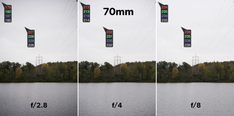

The whole zoom range shows prominent vignetting which clears at f/8. The samples below were shot with in-camera corrections off to better show what kind of compensation needs to happen. Of course, once these in-camera corrections are enabled and automatic profiles are applied in editing, this would be fixed at the cost of noisier edges from normalizing the exposure.
