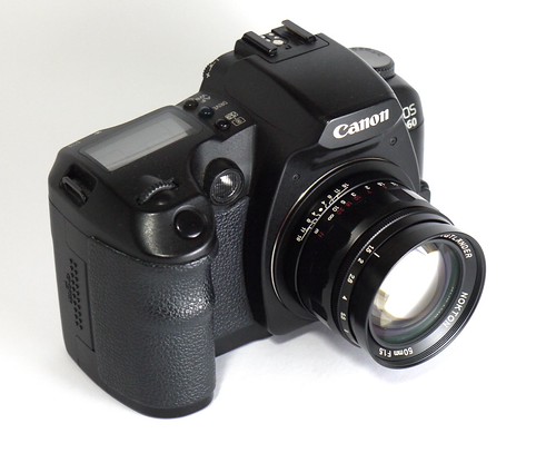

For S$22, you can turn ALL your screw mount lenses to macro lenses on the Nikon & Canon DSLRs... and it's available now. M mount one coming soon....

LTM to EOS Canon Mount

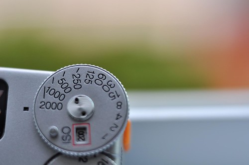

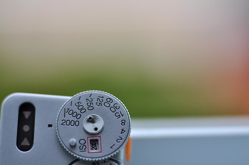

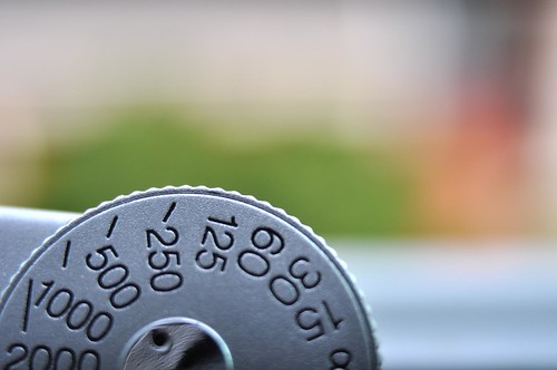

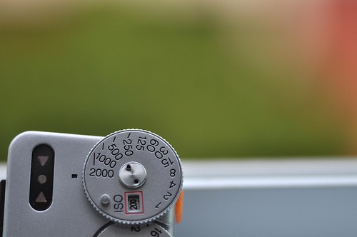

As promised... some shots taken with the adapter & screw mount lenses...
Didn't take it out for a spin, just shot from my window...
CV 25/f4 @ f4
click on image to enlarge
CV 50/f1.5 @ f2.8
CV 75/f2.5 @ f2.5
CV 90/f3.5 @ f3.5
All shorts above are hand held, and metering is by trial and error.
Interestingly.... the lower the focal length, the shorter the minimum focusing distance and the higher the magnification factor. I mount the 15mm on the D90, focusing distance is down to 1cm and fired off... And the camera went bonkers! It registered ERR and the mirror refused to come down. I had to mount another CPU coded Nikon lens to resuscitate the camera.
Minimum focusing distance for 50mm focal length is about 23cm. For 25mm is about 10cm.
