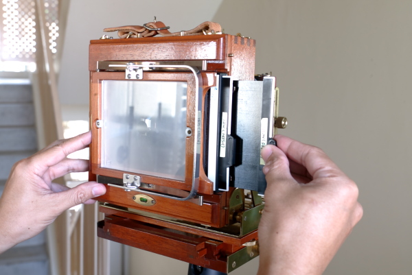

FIRE !
![b59d0574.jpg](/proxy.php?image=http%3A%2F%2Fkangliatkeng.files.wordpress.com%2F2012%2F07%2Fb59d0574.jpg&hash=db42b331467d18e8042c929ecdd7ab21)

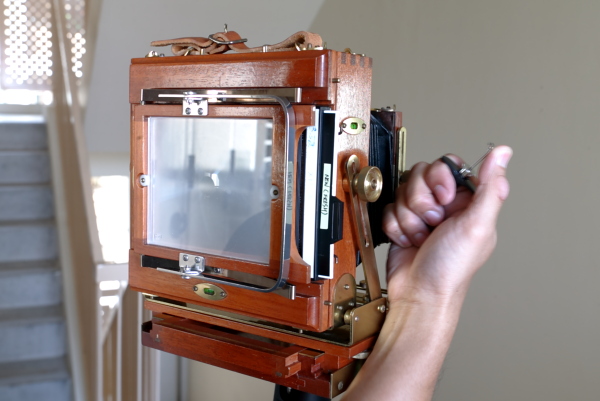

GENTLY slide back the dark side.
Be sure that you have flipped the dark side around, so that you know this sheet of film has been exposed.
![b59d0578.jpg](/proxy.php?image=http%3A%2F%2Fkangliatkeng.files.wordpress.com%2F2012%2F07%2Fb59d0578.jpg&hash=fce14cfeba2d5f0c8fe414f5715f3108)
place the film holder into the zip-lock bag.
