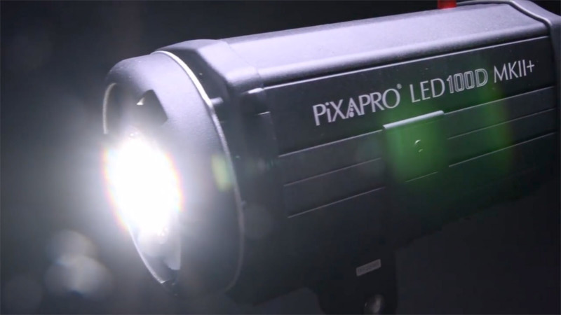

I really like the repeating flash effect, but that’s 8 pops of the flashes that freeze each part of the movement. I wanted to capture more motion in my image. Using a couple of karate students, I decided to test out the idea using a continuous light source (the PixaPro 100D MkII LED) to capture the motion.

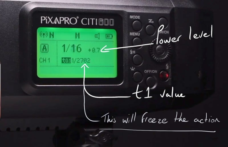

And using a fast flash duration strobe (the Citi 600 TTL) to freeze the action.

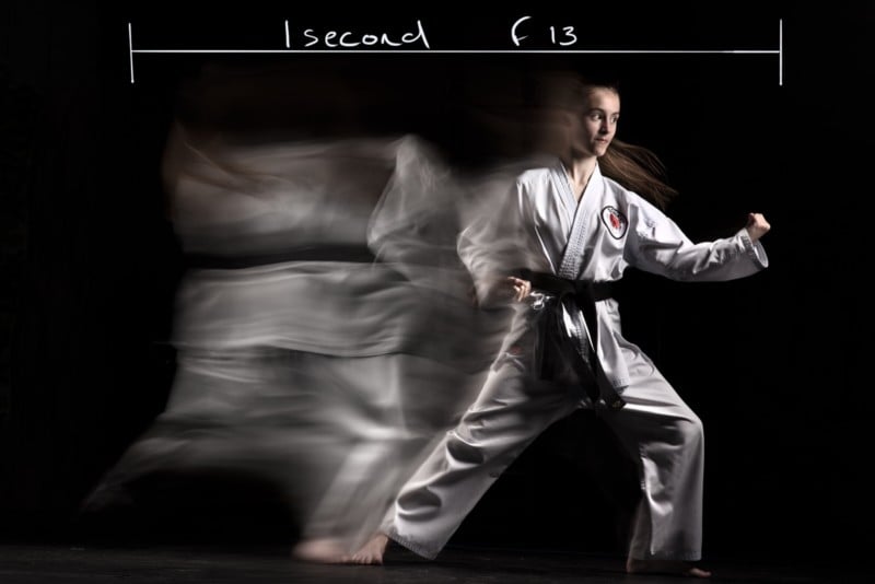

The fast flash duration of the strobe (t1 value displayed on the screen in the above image) allows me to freeze the action even though I am using a shutter speed of 1 second and my subject is moving. Basically, at a lower power level on the strobe, it outputs the flash at a higher speed, which is what freezes the action. And the combination of that and my aperture at f/13 produces a nice sharp end to the movement in the frame.

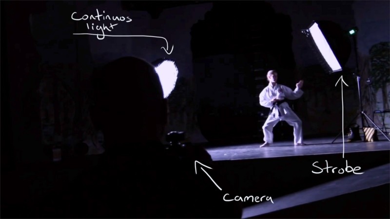

I started to set up and quickly realized that I needed to use grids to control the light spill coming from the continuous light on the left in the above image and also place a strip box grid on the Citi 600.

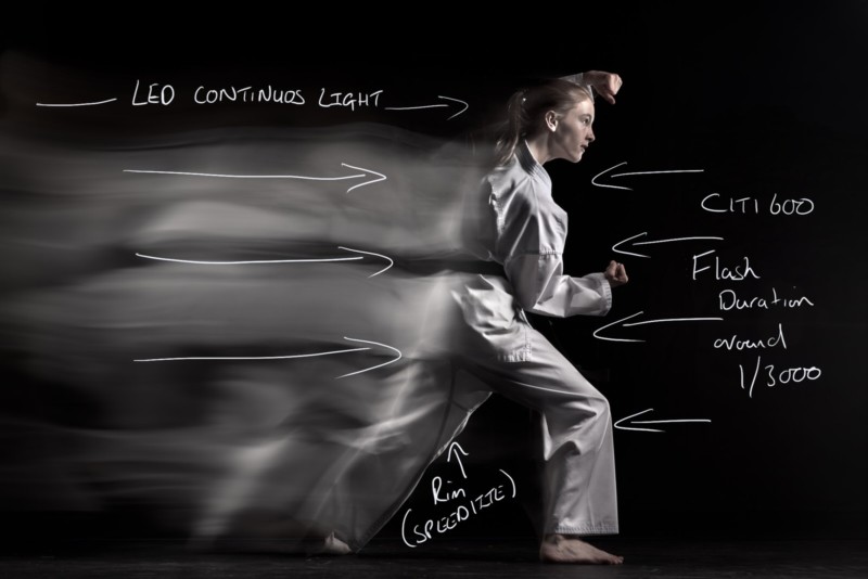

I start with the continuous light and gauge a good exposure for the motion in the image (1-second exposure) and at the same time checking I have the black background with an aperture of f/13. Turning off every light in the theater and only having my LED light on was enough to focus on my subject and shoot some video.

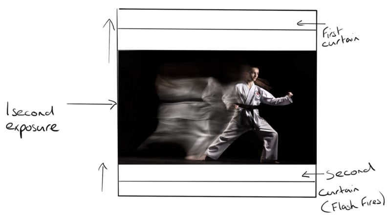

I took a few frames using the Citi 600 light, standing the student at the end point of the 1 second of movement from the continuous light on the left. I set the power level of the light to suit my aperture of f/13, making sure I didn’t overexpose the karate girl. And I set the camera to fire the strobe on the second curtain so the karate student is frozen at the end of the movement.

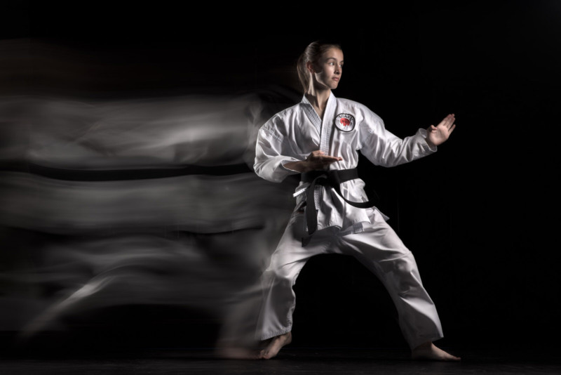

Once I had the lights set up, we started shooting. Timing is key with this type of image, but with karate, timing is very much part of there training, which helped during this session. In the short span of time that we had to set up and shoot, we managed to capture some great images, with the one above being my favorite. In a couple of the shots I added a speedlight behind right of the subject to give a little rim light using a 580 MkII speed lite.
