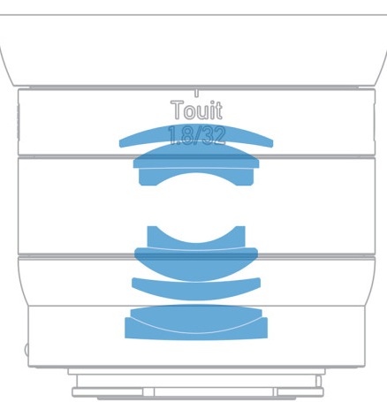

there is another lens that has potential for modification that may cover full frame even better. but the modification will likely be more difficult, and it is a more expensive lens. The touit 32 1.8.

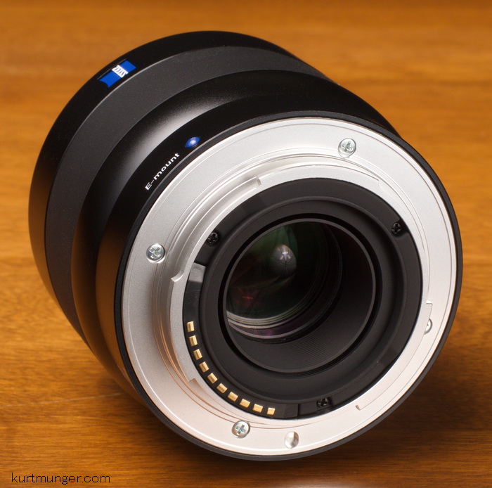

results shld be interesting if the rear baffle and that additional black barrel over the rear element can be removed. The rear element of this lens is significantly larger than that of the sigma 30 2.8, and is actually about the same size as the front element.
anyone with this lens and the necessary tools willing to give it a shot? potentially a zeiss 32 1.8 for the same price as the FE35 2.8 hehe
image of the circular vignette probably caused by the round baffle on the touit 32 1.8
there is another lens that has potential for modification that may cover full frame even better. but the modification will likely be more difficult, and it is a more expensive lens. The touit 32 1.8. results shld be interesting if the rear baffle and that additional black barrel over the rear element can be removed. The rear element of this lens is significantly larger than that of the sigma 30 2.8, and is actually about the same size as the front element. anyone with this lens and the necessary tools willing to give it a shot? potentially a zeiss 32 1.8 for the same price as the FE35 2.8 hehe

I modded a friend's touit without him knowing. It doesn't work. Lots of heavy vignetting
hmm u removed the baffle but did u remove this black tube surrounding the last element? i don't think that part is removable without actual sawing/shaving off the plastic which is ireversible
Nope the black tube can't be removed

and that's why i didn't remove the rubber tubing :)
oh its rubber and not hard plastic? good then. easier modification, just use scissors to cut hehe
