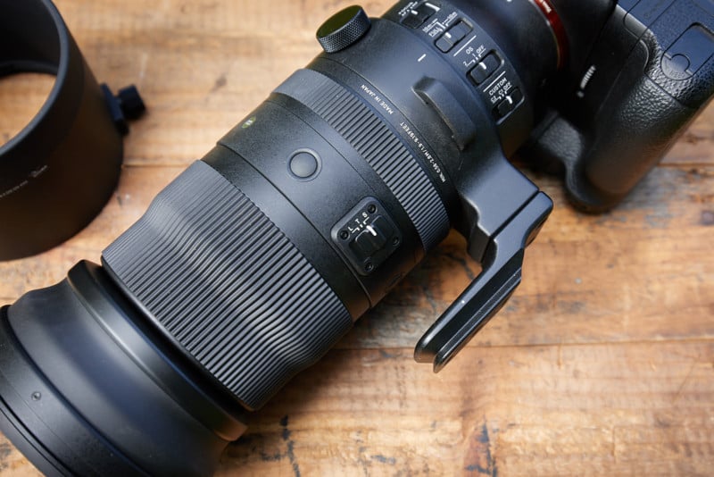

Zoom Ring
The zoom can be operated either by twisting the ring or, by design, pushing and pulling at it directly near the lens hood. There’s a three-stage switch on the left side to which controls the zoom ring tension: locked, tight, or smooth. The locked setting only works at 150mm to prevent zoom creep. I found that the tight setting adds enough tension to avoid accidental shifts in focal length. On the other hand, I felt that the smooth setting was not as smooth as I would have preferred, although this may be more of a physics issue as the weight of the lens physically extending out naturally places a certain amount of tension on the ring.
This lens has a variable aperture that from my testing breaks down as follows: from 150mm to 172mm, the widest aperture is f/5. From 173mm to 365mm, the widest aperture is f/5.6. That leaves f/6.3 being the maximum aperture through the rest of the range from 366mm to 600mm.
For comparison, the Sony 200-600mm f/5.6-6.3 lens switches over right around 300mm, so for those hankering over a third-stop of light, this Sigma is an improvement.
Zoom ring tension control switch.
Focus Ring
Looping back to the focus ring, I’m not a fan of its design. It’s awfully narrow and what is worse is that only a portion of the ring that moves is covered in rubber grip. For such a small area, I wish Sigma could have at least placed the rubber ribbing over as much as possible. For wildlife photography, manual focusing becomes very important in certain situations where there are foreground elements and dense foliage at play, and I use it every day I’m out. On the plus side, it does have smooth rotation to it with an appropriate amount of tension to the glide. In the video section of this review, I will discuss its poor functionality further.
One other complaint about both the zoom and focus rings comes from Sigma’s combination of rubber hardness and the wide, triangle-shaped ribbing. After a while, the weight of my camera and this lens starts to dig into my hand and the ribbing starts to feel like little knives. This is in contrast to the Sony 200-600mm I own and Canon telephoto lenses I’ve used where the ribbing is flattened at the edge and doesn’t stick out so far. I’ve never thought of this as a possible issue until using this lens.
Tripod Collar
The tripod foot and collar feature a couple of great design choices. For one, the foot incorporates an Arca Swiss-compatible plate so that no additional add-on is necessary. The collar itself also has notches every 90 degrees so the foot can be set perfectly level by feeling the groove rather than having to eyeball the alignment with markings. This really comes in handy when shooting off a gimbal when I wanted to go from landscape to portrait orientation. Because of it, I did not have to take my eye out of the viewfinder to check level alignment.
A downside I find with the included tripod foot is that it’s quite short. As someone who shoots handheld, I still appreciate having the foot there and I use it as a carrying handle for my setup. With this foot, I can only awkwardly cram three fingers in rather than a more comfortable four. Again, with the weight being a factor, I begin to feel the discomfort of carrying like this for longer periods of time. I guess I can always buy the eye-rollingly expensive TS-81 foot that Sigma sells separately.
