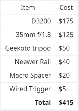

Cost Breakdown

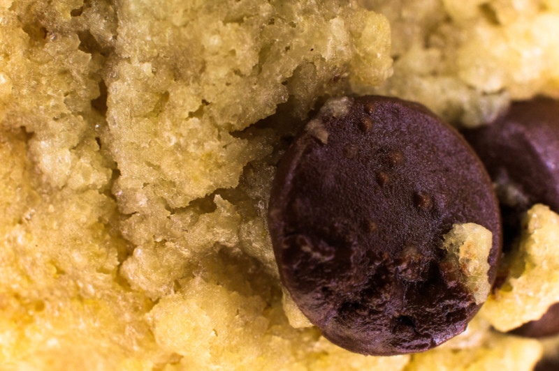

The point I am trying to make here is that for $415, you can take great macro shots. Ranging from this single exposure of a cookie…

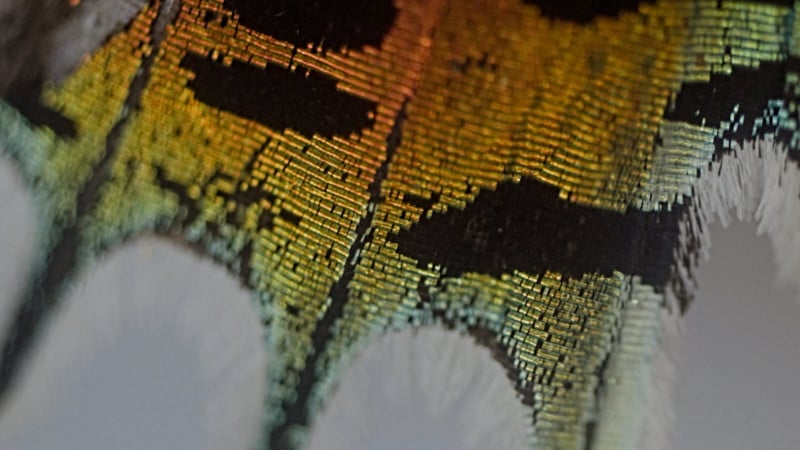

…to this 3 image stack of a butterfly wing…

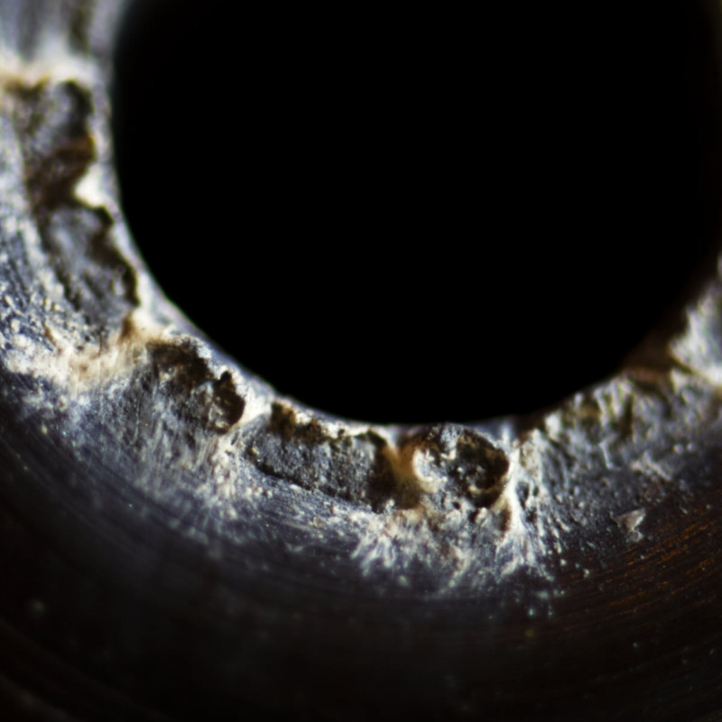

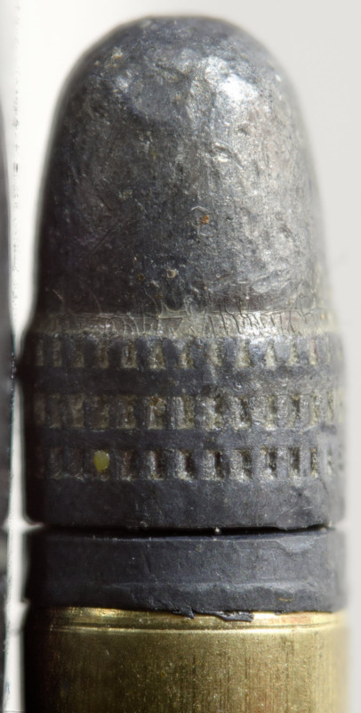

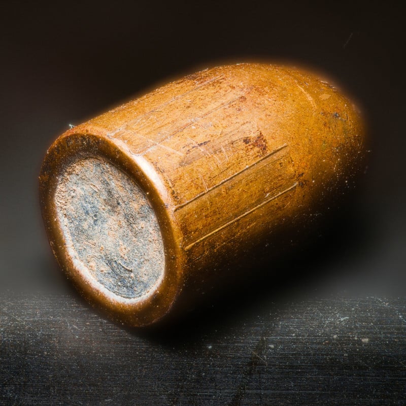

…all the way to a 100+ image stack of a bullet.
Macro is hard but very rewarding, and it doesn’t require expensive gear. Sure a dedicated macro lens would work better, and sure an automated motorized rail does all the tedious work, but neither is necessary for a great picture.

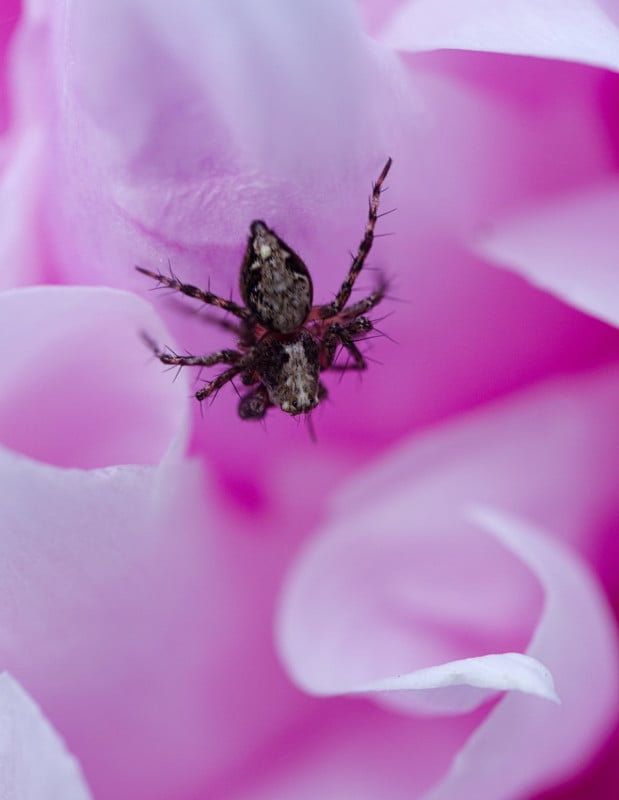

Setting up your target is really important because it affects the image you produce, obviously, but you also can’t really guess and check. With a landscape, I can try a few shots and see what I like best, but with macro that’s a lot harder. Think about what the final image would look like with a thin DoF. For example, this spider head-on and from the top lead to very different results.
From head-on
From top down.
I think the former is 10x better because the framing has a pleasing composition and the head-on approach leads to a more intentional capture.

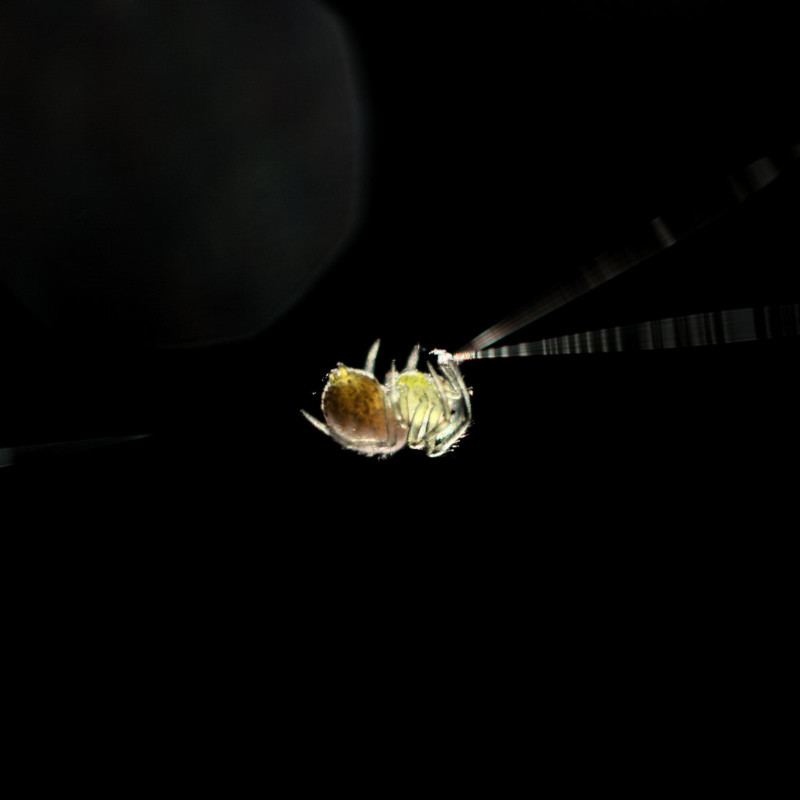

On top of that, you need to think critically about your light and its angle. Unlike in portrait photography, you want harsh light to show off textures. For example, the light here shows the texture of the grooves cut into the grenade.
On top of that, the angle matters a lot. Remember that the concept of “up” isn’t entirely there in macro. You can backlight translucent subjects or you can front light to isolate a subject.
Back light.
Front light.

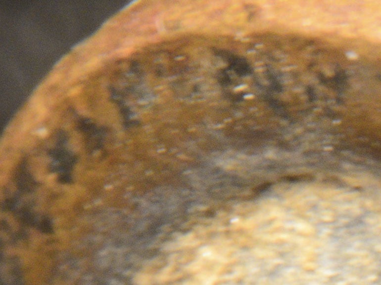

Being on a tripod, it’s tempting to let your shutter be as long as possible because “nothing is moving”. At macro levels, the slightest movement becomes motion blur, even at 1/3s.
The exact shutter speed depends on your tripod, whether you live on a second floor, etc. What I suggest doing is starting at your focal length (e.g. 35mm on crop is like 50mm on FF, so I start at 1/50s), taking a shot, doubling the time (1/50 s to 1/25) taking a shot, and repeating until you hit about a second. Take these images and pixel peep until you find the speed that has no motion blur. You might be surprised by it.
For me and that aforementioned f*** up, I needed 1/100s on a 180mm FF macro lens.

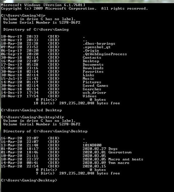

Hugin is a free and powerful panorama stitcher, which I also love for its pano capabilities. What we want it for here is a specific subprogram within it called align_image_stack that is installed automatically when you install Hugin.
You use this subprogram from the command prompt, which seems daunting but is fast to learn. Hit the Windows key and type “cmd” and run the program cmd.exe which should open command prompt. From there navigate to where you saved the pictures. There are 2 important commands here. “cd” is to change folders. So you can say “cd Pictures” to go to the folder called Pictures. “dir” shows you the available options.
I would also suggest reading up on the basic commands.
One you are in the folder with your picture you will use the program by running the following [program] [flags] [pictures]
The [program] is where the program is located, it never changes. For me it’s:
C:\Program Files\Hugin\bin\align_image_stack.exe
The [pictures] is the photos you want to stack. So if you saved everything as .jpg and they are the ONLY .jpg in the folder (HIGHLY suggested) you can just use

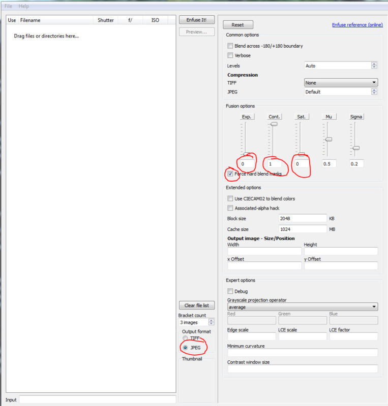

EnfuseGUI
EnfuseGUI is a simple but effective stacking took. All it does is take images that are already aligned, then masks part of them into visibility based on some criteria. Here is the technical explanation of what each change does. If you don’t care, here are the settings you should probably use with the important ones in red:
1. Keep exposure to 0 otherwise it favors middle grey which you don’t care about (this is for HDR).
2. Keep Contrast to 1 so it picks the most contrasty (aka the in focus) parts of each image.
3. Keep the Saturation to 0 so it doesn’t pick based on color, otherwise chromatic noise will dominate.
4. Force hard blend masks prevent halo-ing, but feel free to try without it.
5. Export to jpg mode to reduce file size.
From here, drag and drop your images into the left side, and hit “Preview” to make sure you like what you have. If you don’t, play with settings, if you do, hit “Enfuse It!” to make it run, this will also take a while, I hope you like tea.
