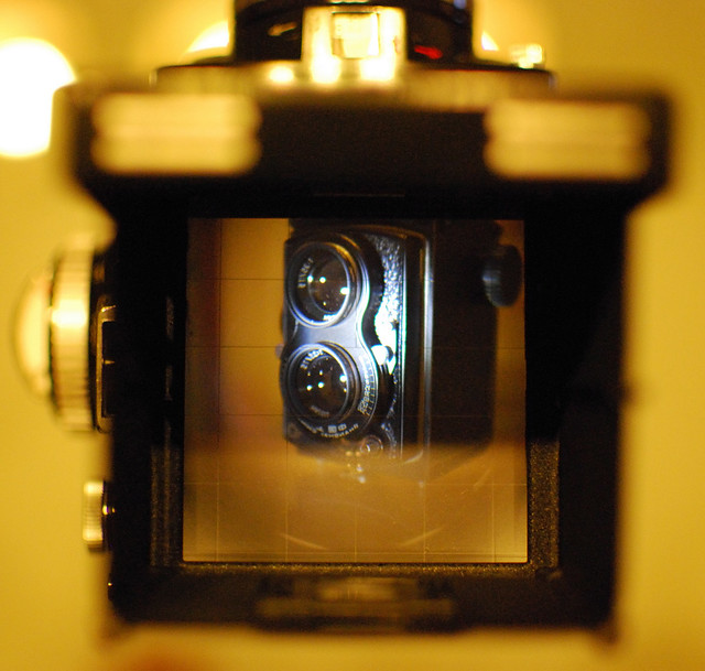

For the Rolleiflex, connect the bigger lens to the finder lens, the red point has to be on top.
the smaller lens is attached to the taking lens at the bottom. Parallax is corrected automatically.
(for illustration purpose dot not aligned. Fitted with +3, the +1 set lying in front)
