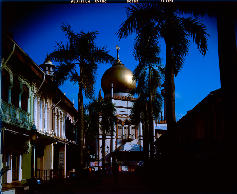

ZGuy's Jalan Besar

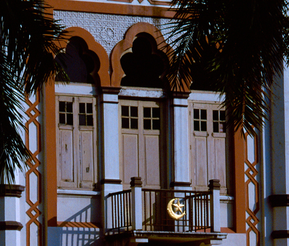

Jalan Sultan -> Wet Scan
Jalan Sultan -> Dry Scan
Immersion Scan
Dry Scan
KGSTON, what is the immersion media you use? Microcope oil or baby oil or water?
Gundlach 8x10
Gundlach Radar 300mm f/4.5
Fujifilm Super HRT Green Xray Film rated at ASA200
HC-110 1:50 5 Minutes
Epson V700 scanned on glass

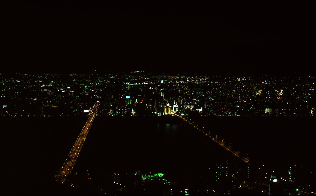

Umeda Sky Tower - Osaka
Polaroid 110B Pathfinder Alpenhaus
Schneider Xenotar 135mm f/3.5
Fuji Velvia RVP 50
2 & 10 min exposure respectively
Cropped and removed slight red cast in PS
edit: Weird, it looks sharper on Flickr​
Brother, NICE!
How come the lights have no star light? Wide open?
First one wide open, 2nd one was stopped to around f/8 if I remember correctly. It was very dark.
