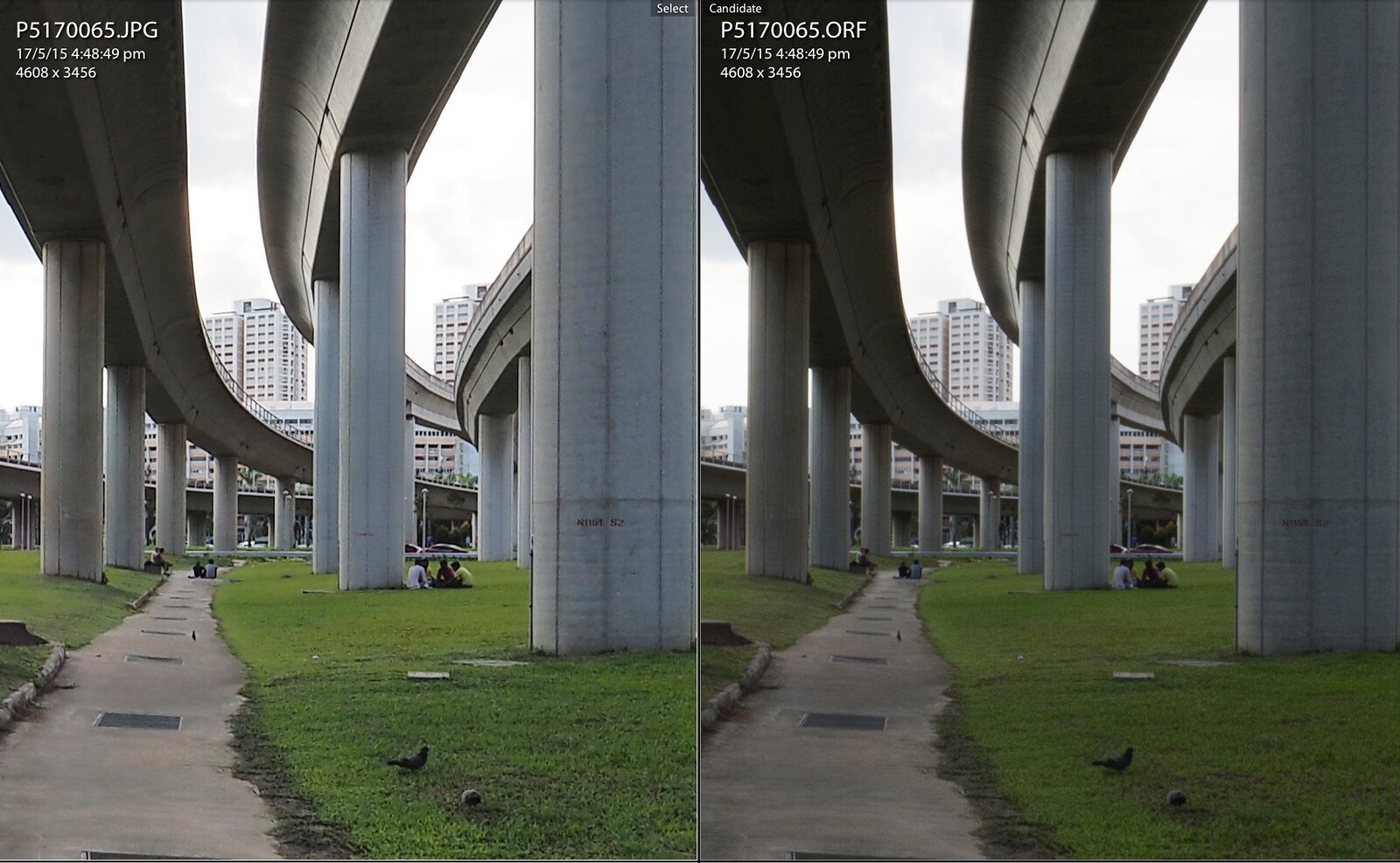

Distortion test. Handheld shot (I try to be as levelled as possible!). I've switched camera for part of this review using EM10 as the RAW files can be used on Lightroom. Here goes the original JPG shot of the scene. Out Of Camera (OOC) jpeg

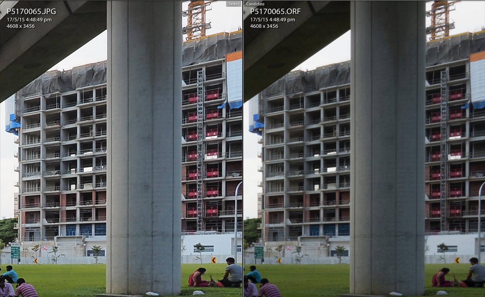

Here's a screengrab of the comparison between left OOC Jpg, and right OOC Raw, close to middle (can see Olympus Jpgs are sharper than Raw files)
Here's another screen grab of the comparison between left OOC Jpg, and right OOC Raw, close to right edge
It's hard to see a difference in distortion, if I were to just switch the pictures back and forth, I can hardly see a change
