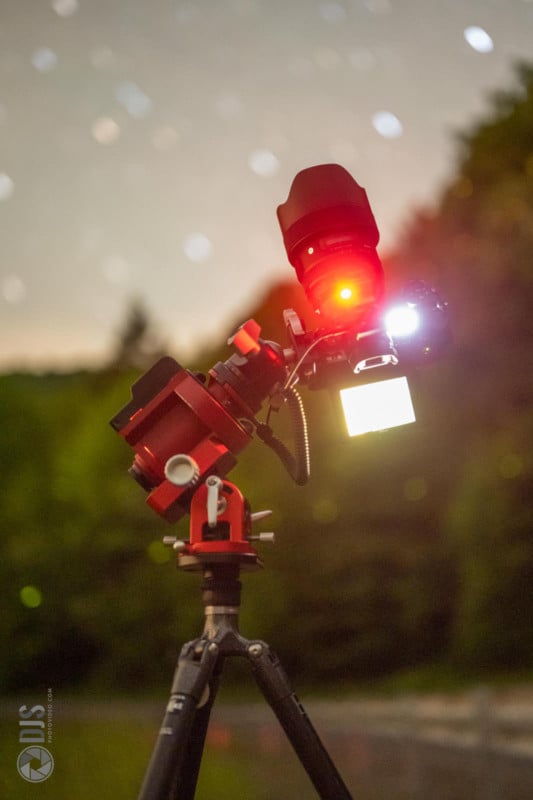

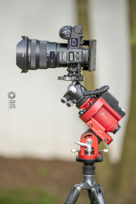

The Nikon Z6 & Nikkor Z 14-24mm f/2.8 S atop my tracker setup which I use for nightscapes.

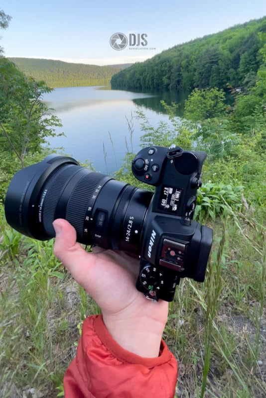

First and foremost (and this is important): the lens’s portability. This is, without a doubt, the smallest and lightest lens in its class. The old F mount model 14-24mm, the Sigma Art 14-24mm, and even the Sony 12-24mm are no match in size and weight when it comes to this lens. More on that later, as this is a party piece.

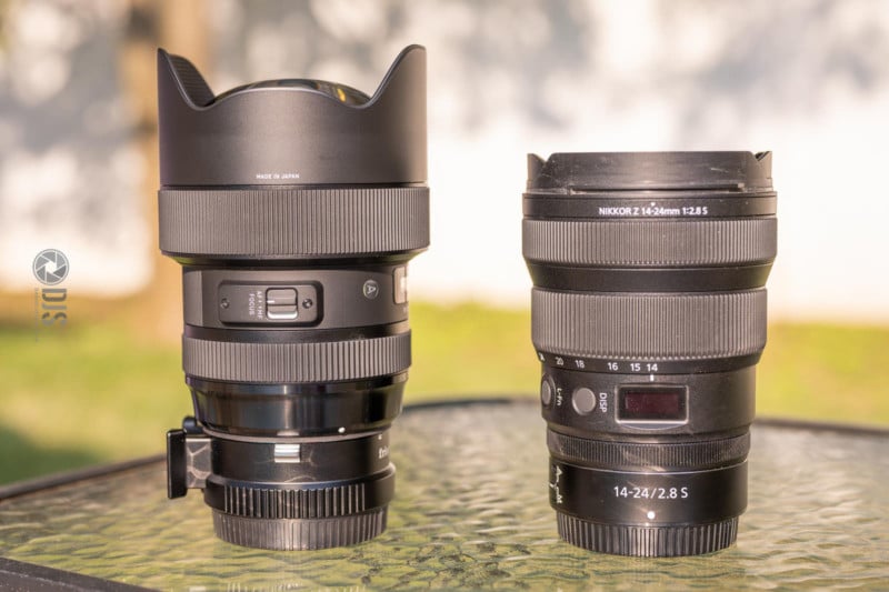

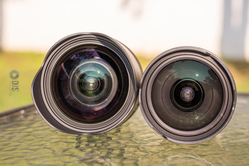

A Less Bulbous Front Element
This next one also ties into the lens’s overall size and portability, but having a less bulbous (meaning that it doesn’t protrude as much) front element that is completely shielded by the lens makes it less accident-prone. When it comes to landscape shooting, the less glass “overhanging” from my setup, the safer I feel. I know this doesn’t seem like a major concern, but I can’t be the only one who looks at those large front elements of ultra-wide lenses and becomes frightened that thing is just gonna fall somehow and smash into bits. Heck, I DID have a near-miss with my old Sigma 20mm f/1.4 Art which had glass protruding from the barrel.
Front elements, Sigma on the left, Nikon on the right

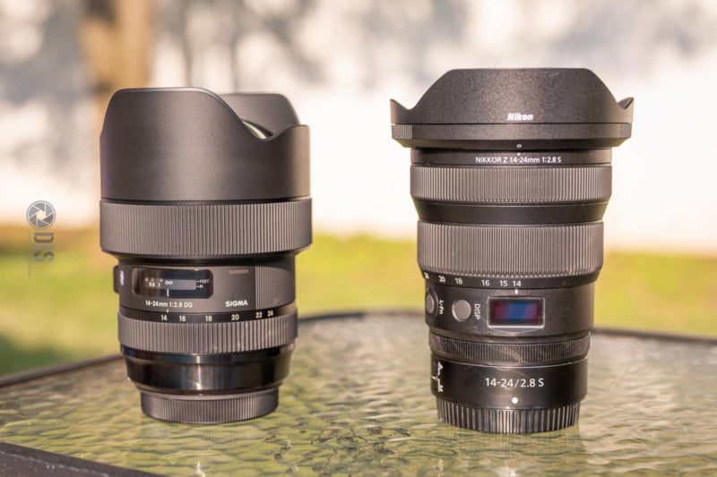

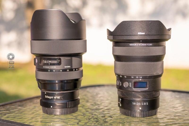

Side by side with the Canon mount Sigma 14-24mm vs. the new Nikkor 14-24mm. At first glance the Canon is shorter, but that is because an adapter is required for mounting to a mirrorless.
Both lenses side by side, this time the Sigma with an adapter for mounting to Z series.
The Nikon has a detachable lens hood, and even with the hood removed the glass still sits behind the front barrel.

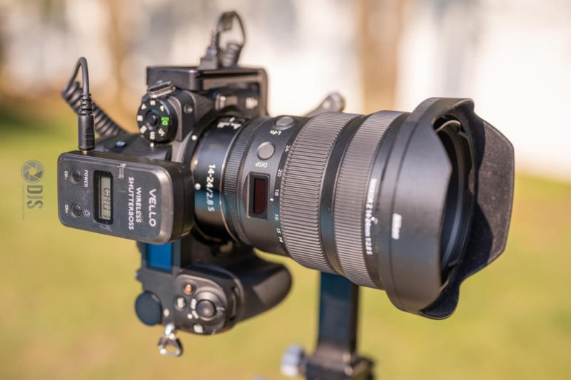

The Nikon 14-24mm attached to my pano head atop my star tracker.

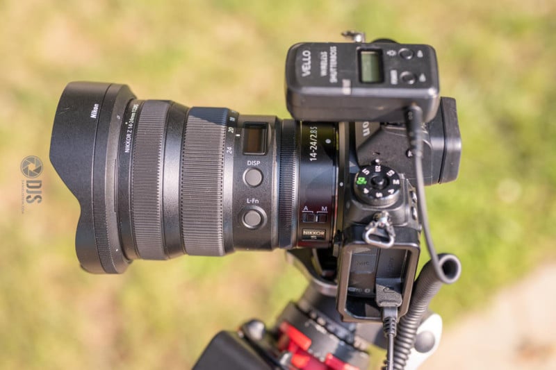

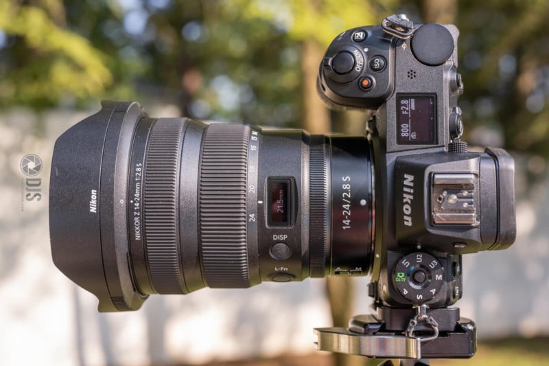

The Multifunction Button and OLED Screen
At first, I wasn’t a fan of the lens’s multifunction button or OLED screen on the top of the lens, but after some use, they have both actually grown on me to the point where I prefer them over a traditional analog-style one. I can use my setup with full confidence and have no lights on whatsoever thanks to it. This might not seem like a big deal, but having to reach up to my headlamp constantly to turn off/on the red light to make minor adjustments becomes annoying after a while. The lens display, coupled with the top display on my Z6 makes it possible to have all of the information I need (focal length, aperture, etc) at a glance, especially if I am in a position where it is easier to see these screens instead of the LCD panel.
The top OLED screen can display the exact focal length you are zoomed to. I think this is super handy especially at night. It can also display aperture, focus, or nothing at all.
The lens multifunction button is located just below the display button. I use it to quickly hit the max zoom for focusing on the stars.

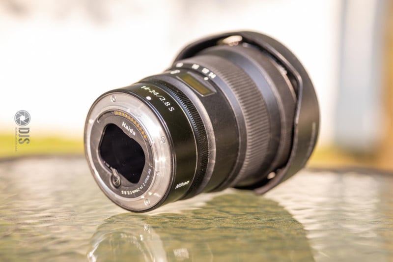

The Rear Filter Holder
Okay, I know for astro work this might not seem like it would be necessary, but hear me out. My Z6 is astro-modded (as I’m sure many other astro-specific photographers’ cameras are). To use it during the daytime requires an external UV/IR cut filter, and with the old style lenses using front-mounted filters, this was impossible. As far as I know, no manufacturer makes a UV/IR cut to fit to work with the drop-in filter systems like the Lee SW150. And even if they did, I am sure it would cost a small fortune and would also require lugging along a bulky filter system (not ideal for heading into the backcountry). With the rear mount holder, it is significantly less complicated to use filters, like light pollution or even starglow filters.
A 9 stop ND filter slides in perfectly at the rear of the lens. No need for crazy huge front filters here, but you do have that option if you wish!

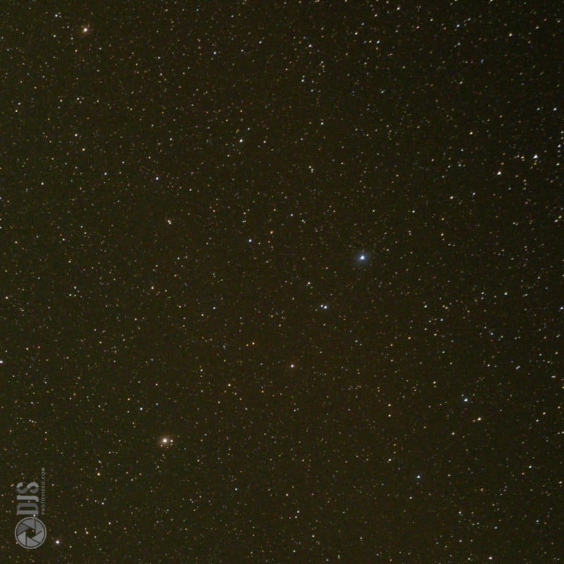

To keep things short and sweet, I took test shots at 14mm, 20mm, and 24mm at f/2.8 and f/4. I did the same with my Sigma 14-24mm (using an adapter). I’ll also show you some older shots that were taken with the same camera body, but using the legacy F mount 14-24mm f/2.8G. Each shot was taken with a 2-minute exposure and an ISO of 1600 using a star tracker.
It should be noted that I do not have the capabilities to perform these tests side by side, so I had to first shoot with the Nikon lens before switching to the Sigma. As a result, atmospheric conditions varied between the shots, so while there is some slight haze in the Nikon shots, the haze had started to clear during the Sigma shots. Branching off of this point, I also want to stress that these tests are not considered scientific in the sense that they were not performed in a controlled environment. Although conditions were changing in between each shot, the results achieved are realistic and you should expect similar results upon usage. This is all real-world stuff here. Each shot was posted as RAW as it gets. No noise reduction, sharpening, or lens corrections were performed.
Z6 + Tracker + Sigma 14-24mm
Z6 + Tracker + Nikon 14-24mm

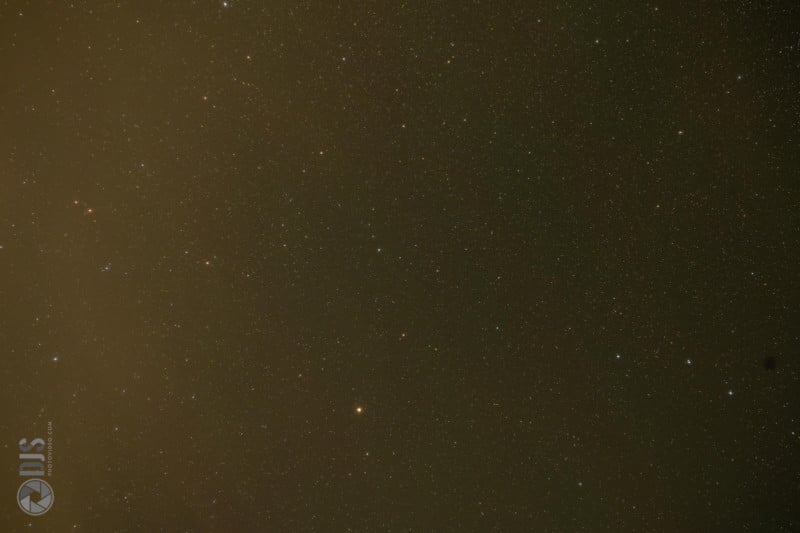

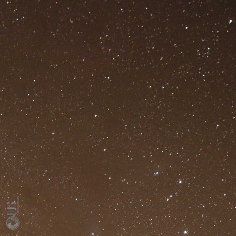

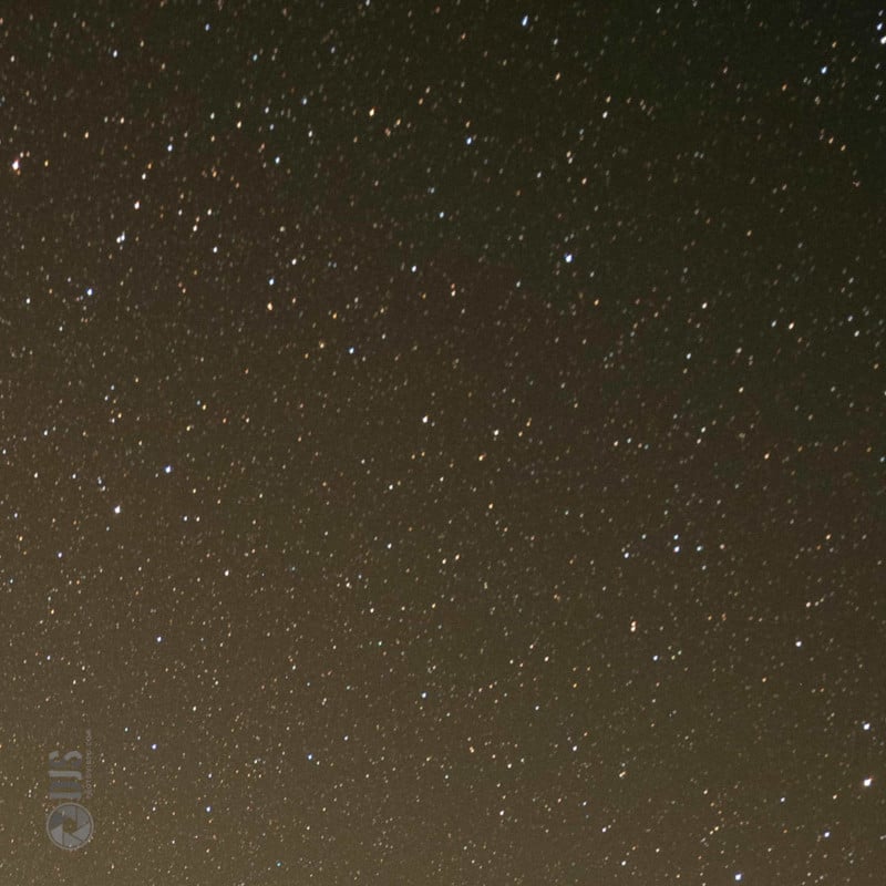

14mm

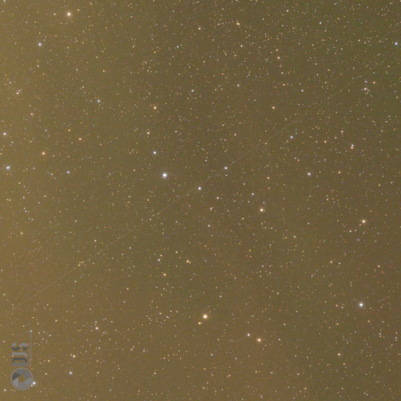

Nikon @ 14mm f/2.8 Center 1:1 crop

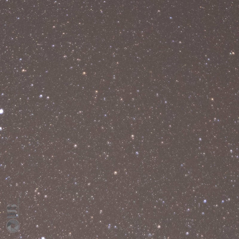

Sigma @ 14mm f/2.8 Center 1:1 crop
Nikon @ 14mm f/2.8 Corner 1:1 crop
Sigma @ 14mm f/2.8 Corner 1:1 crop

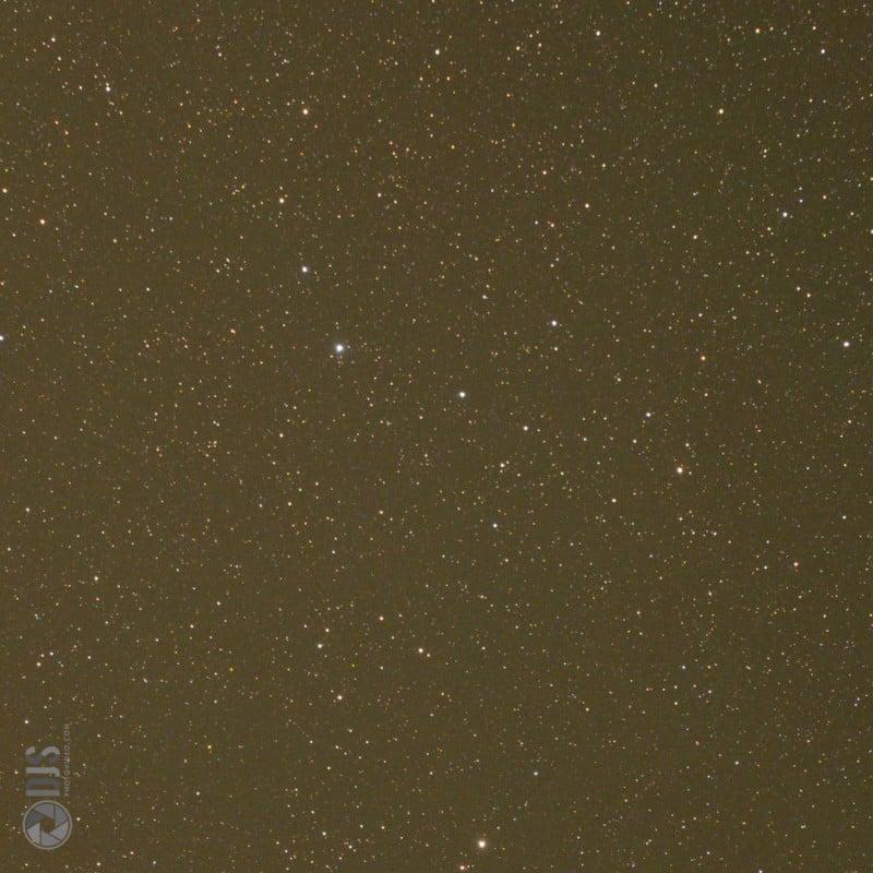

Nikon @ 14mm f/4 Center 1:1 crop

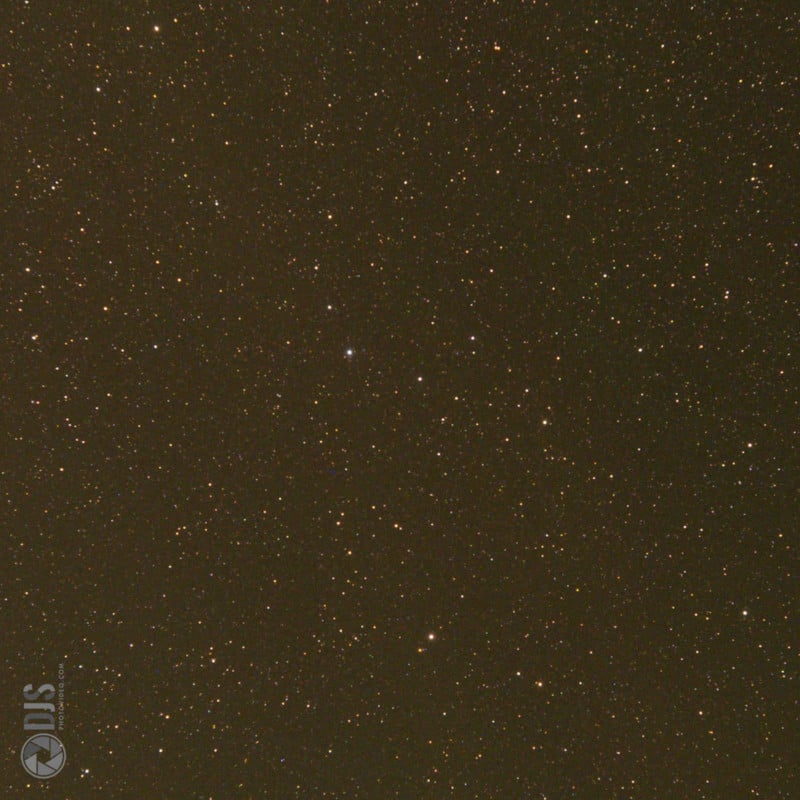

Sigma @ 14mm f/4 Center 1:1 crop
Nikon @ 14mm f/4 Corner 1:1 crop
Sigma @ 14mm f/4 Corner 1:1 crop

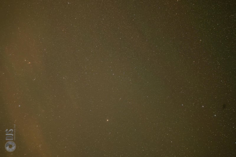

Nikon @ 14mm f/2.8 uncropped
Sigma @ 14mm f/2.8 Uncropped
Nikon @ 14mm f/4 Uncropped
Sigma @ 14mm f/4 Uncropped
At 14mm, things are looking promising for the new kid on the block. The Nikkor lens clearly has an edge at rendering the stars in the corner with minimal astigmatism. The stars also tend to shift towards more rounder, pinpoint sources of light closer to the edge than the Sigma, where they often appear as less rotund streaks.
As far as vignetting goes, I struggle telling the two lenses apart. I think the Sigma has a slightly less intense vignette, but the “fall-off” of light on the Nikkor is slightly more attractive. I would call it a tie in this regard.
Chromatic aberration seems well controlled on both, but I can’t help but notice that the star color on the Nikkor is a tad more realistic, reflecting the blue and yellow colors better.

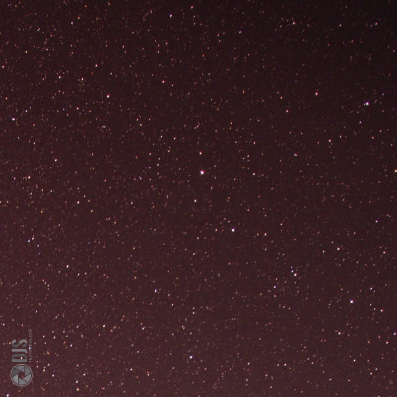

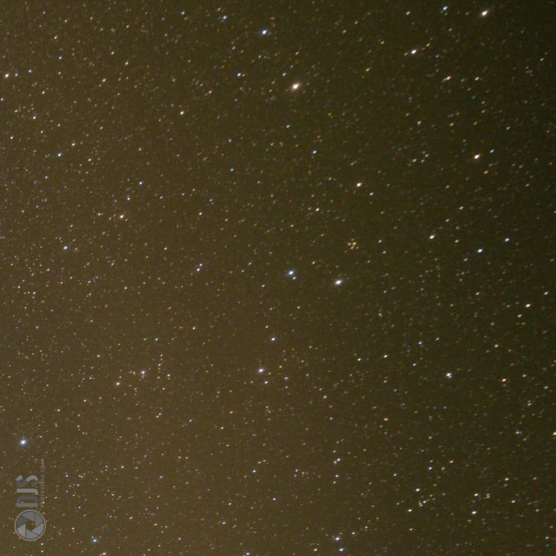

20mm
Nikon @ 20mm f/2.8 Center 1:1 crop
Sigma @ 20mm f/2.8 Center 1:1 crop
Nikon @ 20mm f/2.8 Corner 1:1 crop
Sigma @ 20mm f/2.8 Corner 1:1 crop
Nikon @ 20mm f/4 Center 1:1 crop
Sigma @ 20mm f/4 Center 1:1 crop
Nikon @ 20mm f/4 Corner 1:1 crop
Sigma @ 20mm f/4 Corner 1:1 crop
Nikon @ 20mm f/2.8 Uncropped
Sigma @ 20mm f/2.8 Uncropped
Nikon @ 20mm f/4 Uncropped
Sigma @ 20mm f/4 Uncropped
Now at 20mm, this is where things take a turn for the worse for the Nikkor. At an aperture of f/2.8, the astigmatism in the corner is significantly worse than the Sigma. Fortunately, things do improve TREMENDOUSLY at f/4 and the gap is significantly smaller between the two, but the performance of the Nikkor here against a lens that costs half the price left me a bit underwhelmed.
In regards to vignetting and chromatic aberration, I would say the Sigma has the edge. Overall, it looks flatter and the stars are a tad tighter.
20mm is my favorite focal length (amongst wider focal lengths) to shoot at, so this left me questioning if I was better off picking up the Nikkor Z 20 1.8 S instead of using this 14-24mm. More on that below…

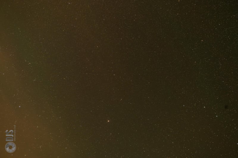

24mm
Nikon @ 24mm f/2.8 Center 1:1 crop
Sigma @ 24mm f/2.8 Center 1:1 crop
Nikon @ 24mm f/2.8 Corner 1:1 crop
Sigma @ 24mm f/2.8 Corner 1:1 crop
Nikon @ 24mm f/4 Center 1:1 crop
Sigma @ 24mm f/4 Center 1:1 crop
Nikon @ 24mm f/4 Corner 1:1 crop
Sigma @ 24mm f/4 Corner 1:1 crop
Nikon @ 24mm f/2.8 Uncropped
Sigma @ 24mm f/2.8 Uncropped
Nikon @ 24mm f/4 Uncropped
Sigma @ 24mm f/4 Uncropped
Now all the way zoomed in at 24mm, once again I found Sigma to have the more attractive stars in the corners with much less astigmatism. However, the Nikon lens does come through with a much faster correction to pinpoint stars closer to the corners. This leads to kind of a toss-up here. The stars in the corner are a little larger at first, but they become round more quickly with the Nikkor than the sigma. However, the stars on the Sigma only start becoming round closer to the center. It is easier to notice the corner of the Sigma when zoomed out, but when pixel-peeping the Nikon lens is more pronounced with distortions.
When it comes to the vignette, I would say the Nikkor has the edge. It seems brighter overall, with flatness fairly equal between the two. One thing to note about vignette, however, is that it is fairly easy to correct. The chromatic aberration seems to be about the same on both, but again the Nikon lens has slightly better star color.
Ghosting (when the stars look bigger and softer than they should be) at all focal lengths also looks to be handled better by the Sigma. However, this may be a small result of the hazier conditions during shooting with the Nikon lens.
Optically, the Sigma Art lens seems to be a slightly better performer than the Nikon Z lens.

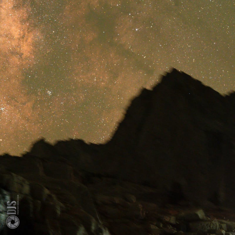

All images were taken at 120 seconds, aperture where noted, and ISO 800-3200. Exposure was adjusted in post-processing to all equal the same ISO, as the Z6 is ISO invariant.
Corner Comparison @14mm f/2.8
The legacy Nikon 14-24mm G lens.
The new Nikon 14-24mm Z lens.
At 14mm, differences between the two lenses seem negligible.

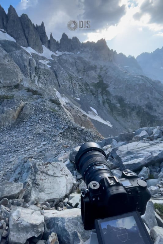

Preparing for an all-nighter to shoot the Milky Way atop a rock scramble I summited in the Eastern Sierra.
