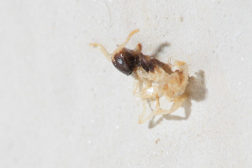

More reverse macro shots. Same setup. Strobist: 580EXII about 80cm away from all subjects. 1/4 power direct or bounced.
Ignore the dust. My 50mm rear element was exposed to the environment too long.
Death.
We come, We go. Even the busiest and most loyal of ants aren't spared.
Ant was exactly 1mm x 2mm.
Another One Bites The Dust.
No ants were purposely killed in the making of these photographs ^^" they probably died of natural causes.
Death.
