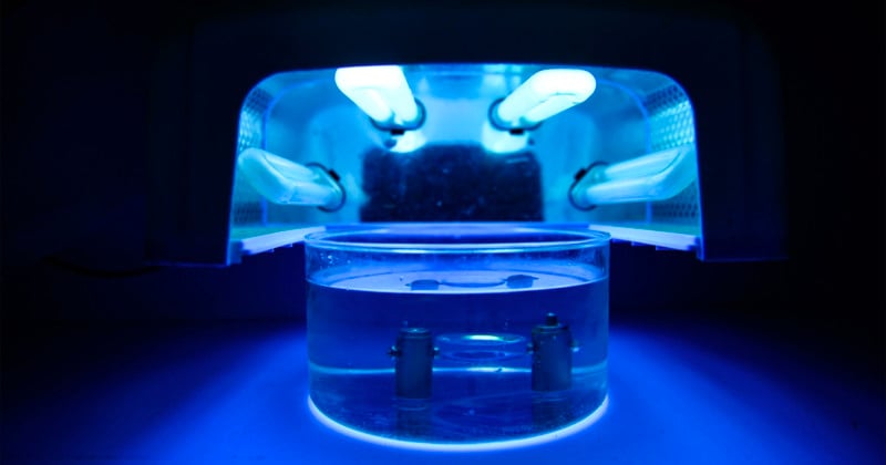

New lens manufacturing process in progress

The process involves using a liquid polymer contained within a special liquid environment that is able to make complex shapes through the physical forces acting on it. Once the polymer is formed into its final shape, it is hardened using UV radiation to become a solid lens.
The researchers used their new method to make optical components with various geometries — including toroid and trefoil shapes — and sizes up to 200 mm as well as freeform surfaces. The lenses exhibited surface qualities similar to the best polishing technologies available while being orders of magnitude quicker and simpler to make. | Technion – Israel Institute of Technology
The team explains that one of the primary challenges in making optics by curing a liquid polymer is that for optics larger than about two millimeters, gravity dominates over surface forces, which causes the liquid to flatten into a puddle. To overcome this, the researchers developed a way to fabricate lenses using a liquid polymer that is submerged in another liquid. The buoyancy counteracts gravity, allowing surface tension to dominate.
Because they are able to remove the effects of gravity, the researchers can fabricate smooth optical surfaces by controlling the surface topography of the lens liquid.
“This entails injecting the lens liquid into a supportive frame so that the lens liquid wets the inside of the frame and then relaxes into a stable configuration,” the researchers explain. “Once the required topography is achieved, the lens liquid can be solidified by UV exposure or other methods to complete the fabrication process.”
