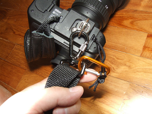

I think your failsafe fails to be safe. How does that extra carribina helps in fail safe? I thought it is more likely the screw might come out or the metal hinge breaking?
Because, the usual breaking point is the swivel area. The little metal bit tends to break, by connecting a carabiner to the strap, it acts as a failsafe.

This is the failsafe I have been using for the past couple of years.
There is also a very huge possibility of the fasterner coming loose on its own. You need to consider that. Tying a cord on the carabinder to the camera will mitigate that risk.
