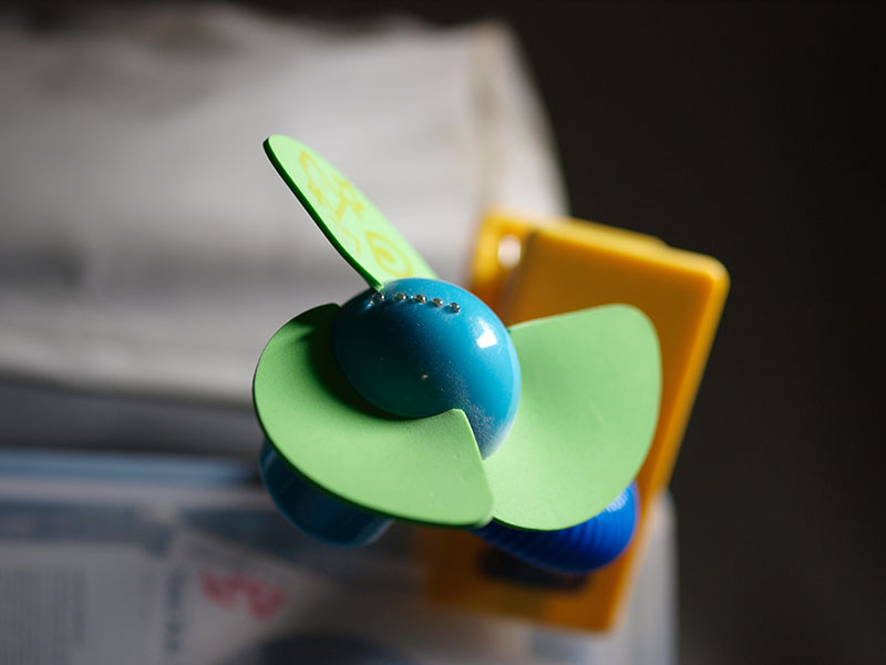

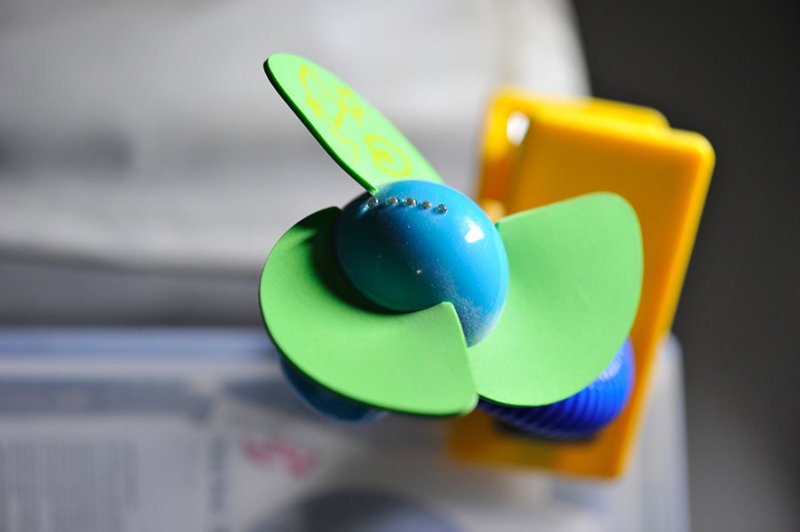

In fact, I did a less than extremely scientific test. No, I did not rush to buy the D700, even if I am tempted, but I took the SP570 and compared with the E-3. Surely the relation should be similar. Unfortunately there seems to be no way of getting all the data so I had to do some calculations. My calculation shows, based on the data sheet lens equivalence that the SP570 has a crop factor of 5.652. We all know that the E-3 has a crop factor of 2, so to calculate the equivalence between the two 5.652 / 2 = 2.826 which is the crop factor between the two.
Unfortunately I could not find any way of reading the actual focal length from the display, so I had to use a ruler to take the image. I took this image:
The exposure was set to ISO 100, 1/60s and f/5.6 and of course the camera was in manual exposure mode.
I then took the calculator and based on the crop factor between the two cameras I got an f-number of 15.8256, so I selected f/16 on the lens. I had to use the ED50/2 macro to get this close and then I tried to get the same field of view by moving out from closest focus. This was not very scientific, but this was the best I could do. In fact this was totally wrong, since I no longer had the same FOV, since I had to move out. I think this test must be done at infinity to make it right, or at least one must know the focal length more precisely to be able to use the same equivalent FL. Anyway, by doing so I got almost the right exposure at ISO 800, which later on I discovered in Studio was also a bit on the low side, to get it right, I had to increase another +0.7 to +1 EV in Studio. This was however no surprise to me.
Well, in the end, this is the image I got, after exposure compensation at PP.
Conclusion? Well, just like in the comparision between the E-3 and the D700 (or any other FF), the high ISO performance of the E-3 is way better then the SP570UZ. These advantages are a bit lost (but not totally) by the fact that the E-3 demands the increase of ISO to get identical exposures. The increase needed was somewhere between 3 and 4 EV. This was also no surprise, but since I can not calculate the real +EV needed (I don't have the size of the SP570 sensor) this is as far as I get in this test. I think it proofs my point anyway, even if not everything is done as I wished to do. Maybe if I have time I will redo the test a bit more scientifically at a later stage, another time.
