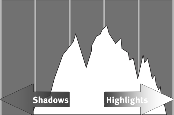

How do you ensure that the highlight is not clip? Do you check that all the tones of a scene to fall within the boundaries of the histogram itself.
- The attached picture is a very good example. As time goes along throughout the wedding, I was pushing my histogram as the attached picture. I was trying the Dave Dugdale methods, the one that you posted recently about the snow highlights.
- There are times that you cannot really rely on the histogram because what you see on your LCD screen does not tally with the histogram. Got to trust your eyes then.
- Another thing to take note, NEVER NEVER ever follow the bride and groom from outdoor to indoor or vice versa. There goes your white balance, settings and composition. Always wait for them in the next environment. I only realised it halfway through the wedding.

I thought about the Dave Dugdale method but my only concern is when shooting on a bright sunny day, the glare from the sun can make it very difficult to read the histogram from the LCD. So I wonder would it be better to shoot under exposed by may be -1/3EV, then adjust the exposure during post editing by playing with levels?

Well, I did tried during the wedding on Sunday. I could not see any difference. Maybe I was under pressure I may overlooked. I leave it as it is.
If you look at the bottom of your LCD screen, there is this exposure metering. As you move your camer, it will read the exposure. I used that as well as a guide to see whether am I going underexpose or overexpose.

I think regarding the histogram issue, it should only be used if you can't determine, by eye, whether the highlights are clipped. This happens very often in bright sunlight where there's too much glare to be able to confirm that you have exposed for the highlights ideally, therefore using the histogram to make sure your highlights aren't clipped in is a great solution only in glaring sunlight, because ultimately when you start recording, the histrogram disappears, rendering you unable to continually use it to maintain proper exposure throughout the duration of your shot.
- You are right. There are occasions where my footages, the highlights are already clipped but the histogram did not reflect it. So I trusted my eyes. There are occasions under the glaring sun, I have to trust the histogram because it is quite difficult to see.
- If you have magic lattern installed, you can actually switch on the histogram even while recording, it will be displayed.
- I have the Viewfinder but it kept dropping on me. I gave up on it. Maybe I should look at LCD SunShade. Artworkfoto is selling it.
