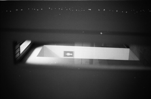

Recently i faced this problem on my negative..pls look at the white spot on the negative...
Anyone has any idea what this is or how this was formed? It looks like water mark but then again, i dryed it for 3 hrs...
Could it be an issue when i reel the film? Developer used was D76..
what format is this ? 120 format ?
dirt, dust and water marks
a completely dried film will still have water marks, some photoflo will help
dirt- just clean it well before scanning
i doubt its dirt..it looks like water marks...
hi may i know wat is photoflo? after developing, i will normalli follow the mama lemon method and then hang for it to dry...

watermarks is for the rows of white dots, kinda obvious as it follow a trait of gravity pull
the dirt is the one in the center with the "hair"
Photoflo is just high class detergent haha, meant to break up the surface tension of water and minimise water marks.

If you mean dust, there is digital ICE for scanning. Anyway the worries people has are scratches, color shift or stuff growing on it after keeping for long. Dust are everywhere, what you can do is to clean it before loading into sleeves.
