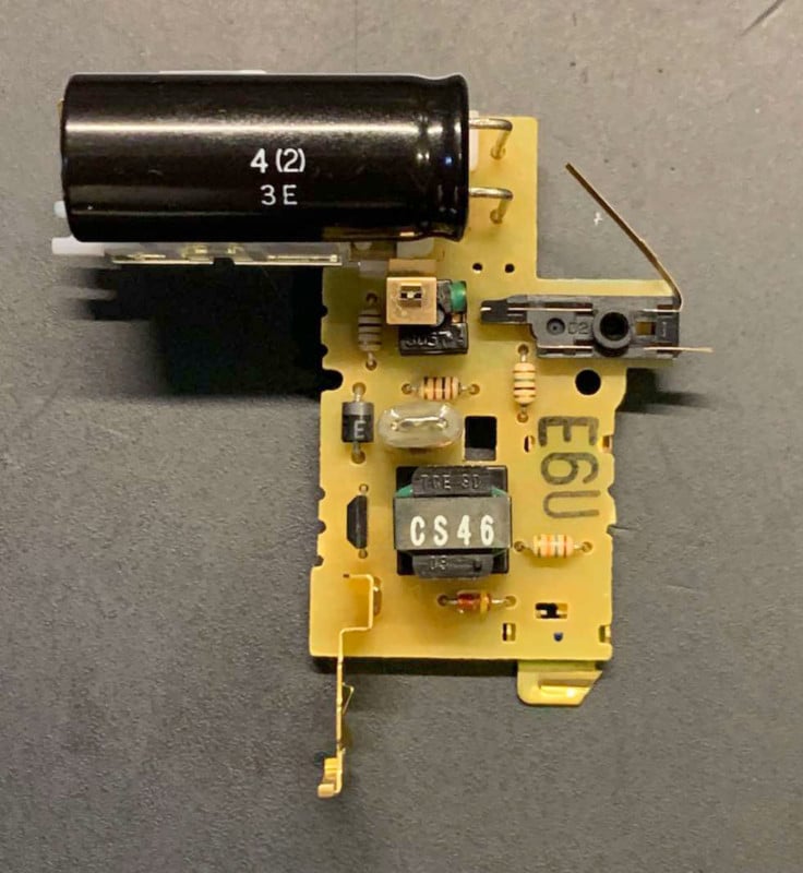

The camera flash I built uses the flash circuit from a cheap Fuji QuickSnap disposable camera which I got for only about $7.
A Fuji QuickSnap disposable camera with a built-in flash.
Make sure to discharge the capacitor before handling the circuit! It’s charged up to 300V, so you really don’t want it to touch it while it’s still charged.
Flash PCB from disposable camera. Don’t forget to discharge the capacitor!
There are two switches in the circuit: one to charge the cap and one to trigger the flash. For the charging switch, I simply attached a toggle switch up to it.

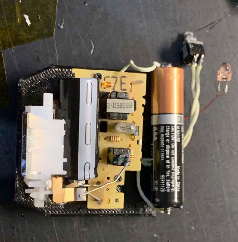

I instead designed and ordered a PCB based on this schematic (the webpage has a really good explanation of how the circuit works). You can find the PCB and 3D files on my GitHub. This circuit takes in the ~300V trigger voltage and turns it into a 5V for the camera’s hotshoe.

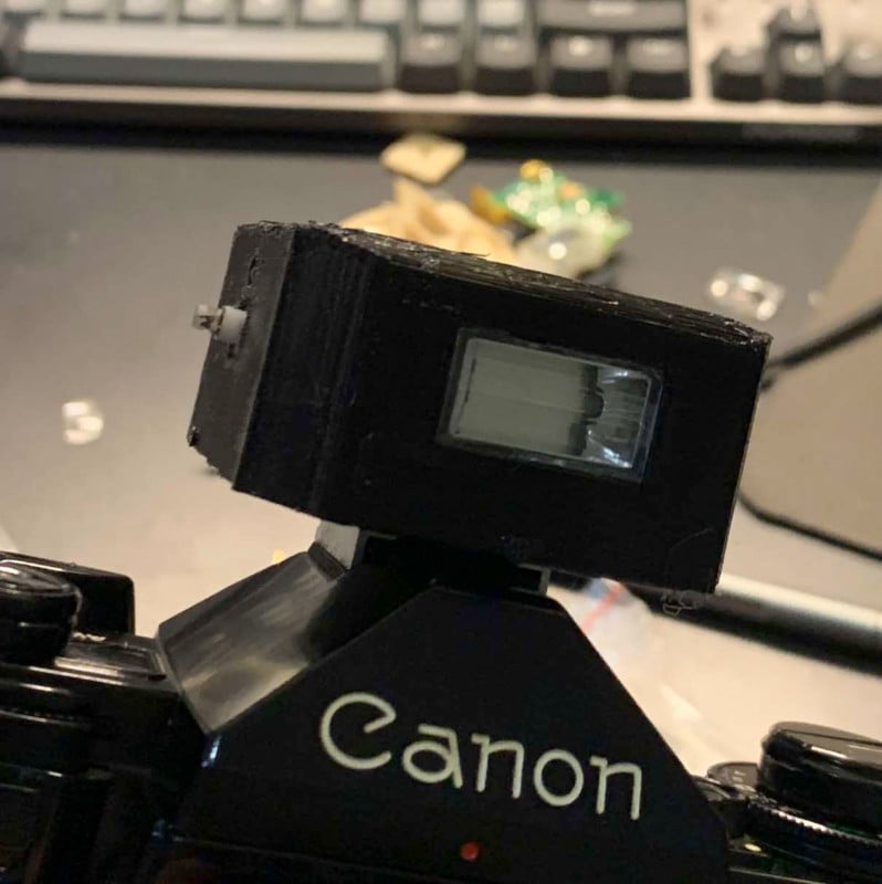

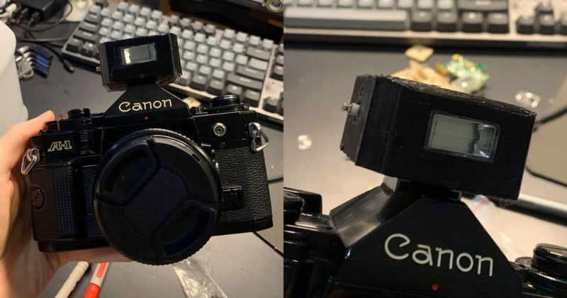

I then modeled up an enclosure for the circuits, along with a hotshoe with contacts. The contacts used in the 3D-printed hotshoe are taken from the copper contacts on the disposable camera’s PCB. And that’s it! I now have a small camera flash.
Inside the flash. Please ignore that I soldered directly to a battery.
The final product. Note the charging toggle switch on the left.
