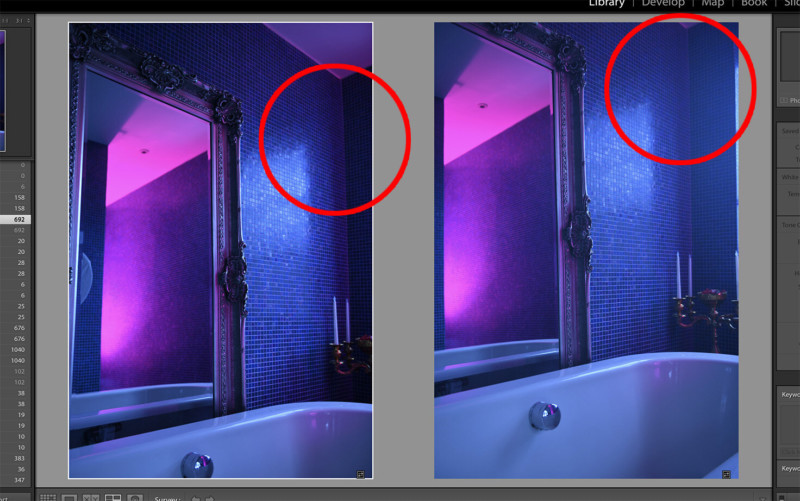

This image has no bare bulb or direct highlight in shot, but it does have a blue light just out of shot to camera right pointed over the subjects shoulder, plus it had a red bulb just out of shot in that lampshade.
Both of these shots were processed in the same way, but it should be clear to see the very significant difference between the two shots. In the image with the low contrast filter we have more detail in the shadows and although we’ve chosen to not pull out too much of that detail (look at the fabric on the jacket lapel for example), it’s there.
Also, look again at the highlights. At the very top of frame where the light is brightest in the image with the no low contrast filter, the lamp with a red bulb has lost nearly all of its colour in the brightest areas. Compare that to the shot with the filter and you see not only more detail, but a lot more colour too.

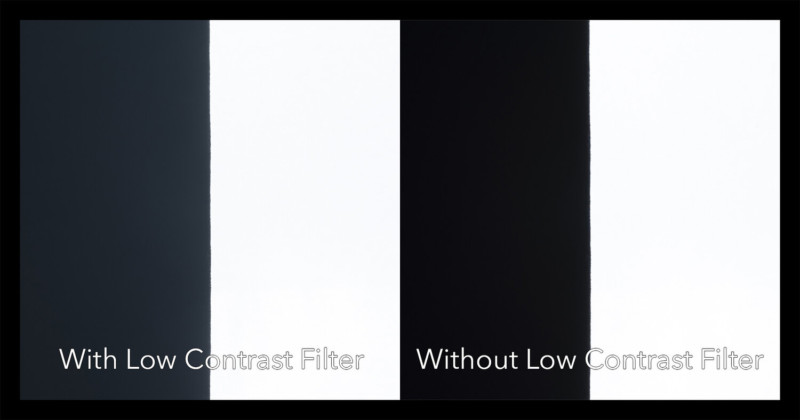

Are you curious to see what the low contrast filter is actually doing? Take a look at the side by side below, with and without the filter.
On the left you have a shot with the low contrast filter over the lens. On the right you have the shot with nothing in front of the lens. Both of these shots are raws, straight out of camera with zero adjustments.
You get the idea now?

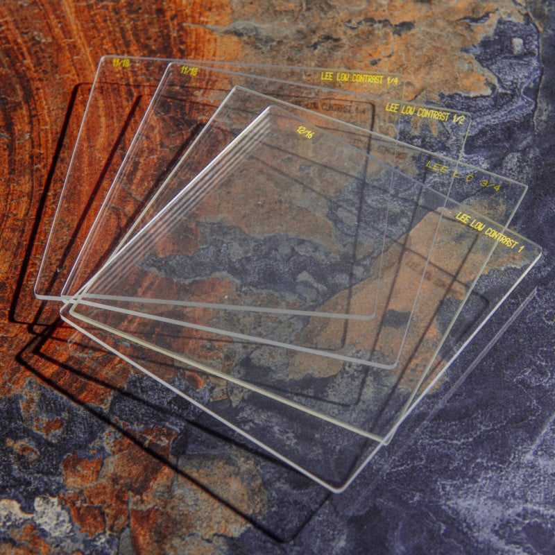

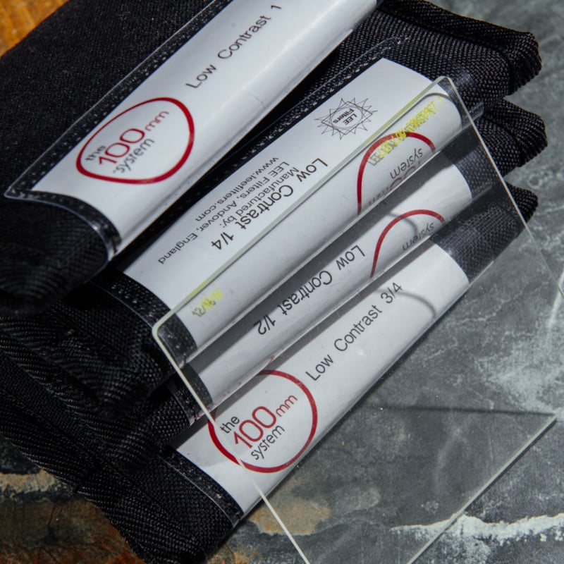

I personally use a pack of Low Contrast filters from LEE Filters. The pack comes in a range of strengths from a 1/4, 1/2, 3/4 and 1. The number 1 offering the most dramatic effect. Truth be told, I’ve not used any of the other brand low contrast filters out there to compare and as you probably noticed from the start of the article when we looked at examples in TV shows, there’s a ton of them by other brands that seemingly do the same thing.
The LEE ones I have work for what I need, but if you want to dig into the low contrast filter options further, you’ll be looking at variations in how they deal with highlights, halos, glow, sharpness, diffusion and more. Trust me, the variances in low contrast filters is a full time job in its own right.
For more details on the ones I use, take a look on LEE’s site here.

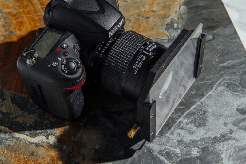

I personally use the LEE Filters Low Contrast filter set. This includes filters of varying powers including 1/4, 1/2, 3/4, and 1.
I personally just hold mine in front of the lens with my hands for the shots that I need them for, but you can get a holder that will attach to any size lens you have. I personally prefer this method over the circular screw on ones as I can switch lenses during a shoot without having to buy lens filters for each of them.
You can simply hold the filters in front of your lens with your free hand, or place them in a proper filter holder.

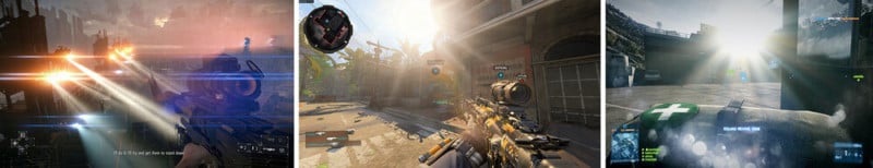

For example, I could go into more detail on how the video games industry spends millions each year on developing purely artificial in-game lenses with bokeh, halos, fringing and diffusion in an attempt to make us feel more “immersed” in a synthesised world.
That entire industry strives to make their imagery look less artificial and I find it odd that as one art form struggles to trick us into being immersed with visual artefacts, another simultaneously strives to make things feel hyper-real by removing all trace of them.
