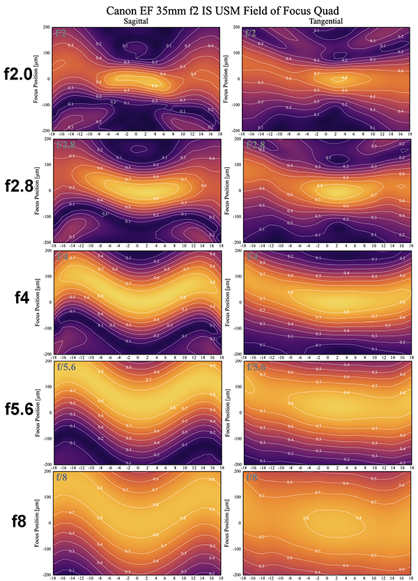

To test the lenses and compare them to one another, Roger created field curvature plots for each lens as he stopped it down. The charts show how sharpness improves across the frame and into the corners the closer you get to the “peak” sharpness around f/5.6 or f/8.
The data for the Canon f/2, for example, looks like this as you stop down:
You’ll want to check out Part 1 of this series on LensRentals to learn how to read these charts, but the most over-simplified version I can possibly come up with (and which will no doubt earn me Roger’s wrath in the process) is that yellow equals sharp, the X-axis represents the distance from the center, and the Y-axis represents focus position. So the very center point of the graph represents the center of the lens with ideal center focus. If you go right or left from there, you’re moving further away from center; if you go up or down you’re front or back-focusing the lens, respectively.
There are two charts per aperture value because one chart shows the tangential and one shows the sagittal plane, which are typically sharpest at different focus positions, leading to astigmatism.

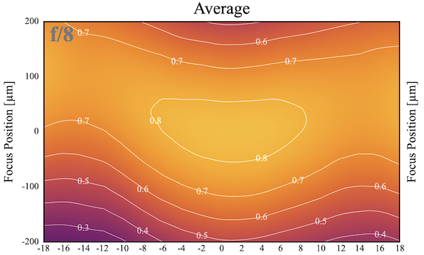

When you average out the sagittal and tangential field curvature plots into an overall graph, you get something that roughly “mimic how sharp the lens is overall when you take a picture.” The average of the Canon 35mm f/2 lens at f/8 looks like this:
