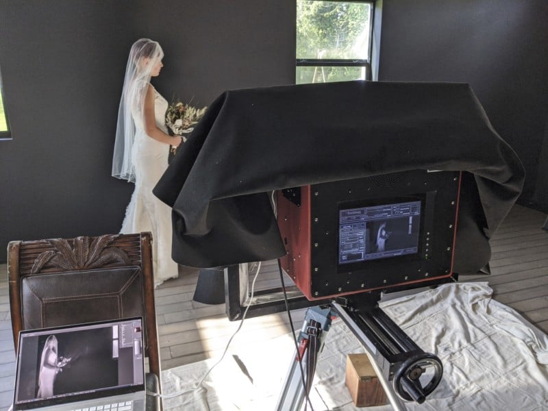

We were able to connect with Charbonnet when we picked up the camera directly from LargeSense in Santa Clara, California. He’s a quirky, tech-savvy guy who offered whatever personal support we needed to get up and going. We drove the camera up to our studio in Seattle and got to work.
The video above was captured at 1/30 sec, ISO 2100, reduced to 50% speed, and shot with a Kodak Aero Ektar 305mm at f/2.5. Link to the uncorrected 8-bit video can be found here.

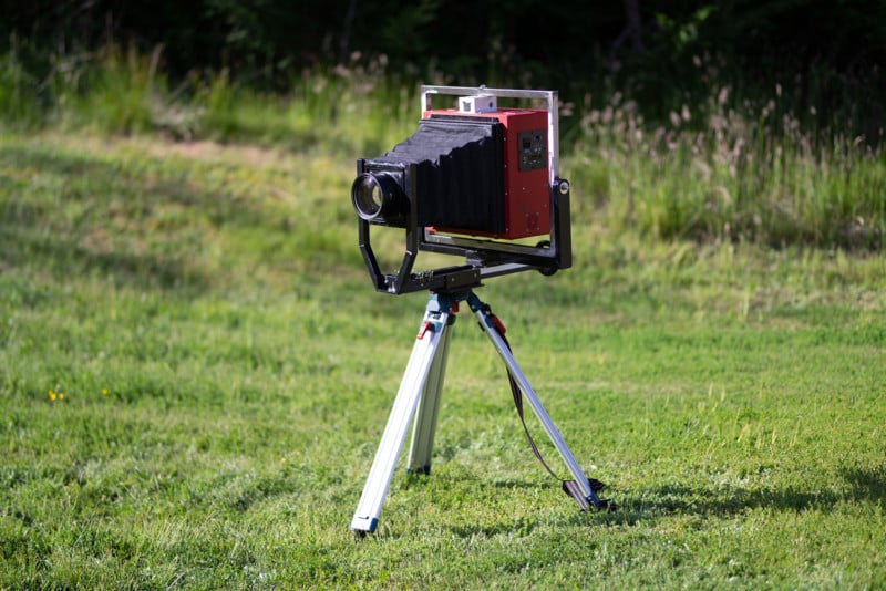

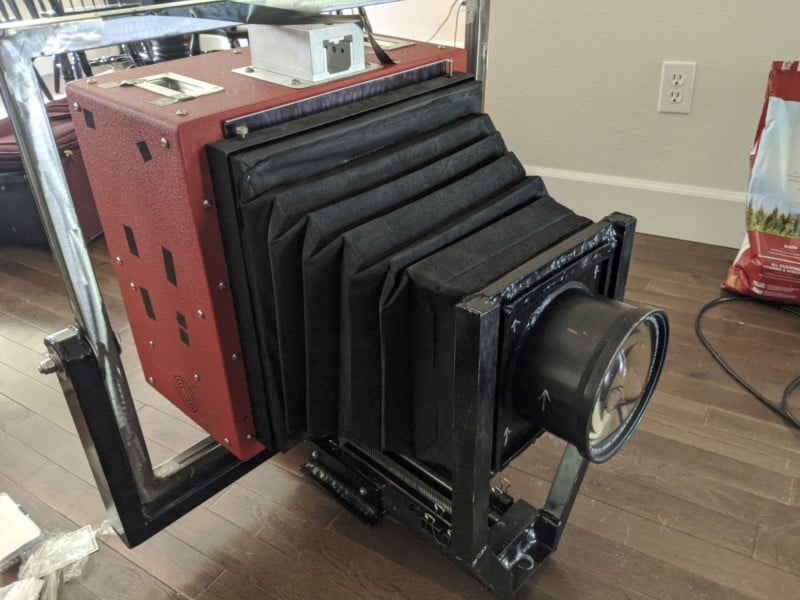

  • Since Nick has a background in large format photography, we were able to adapt his lenses and slide-mount assembly for use with the LS911. Because of our custom setup, it was easier to mount the unit upside down on the slide.
    The camera itself is heavy and has a good clean build quality. All the buttons are sleek and the interface is intuitive.

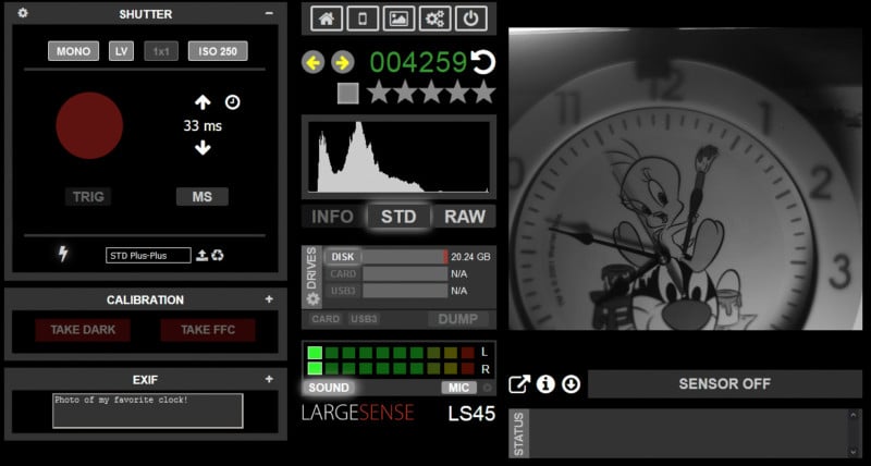

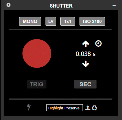

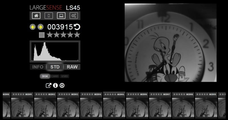

    There are significant features that other (even traditional) camera systems lack, like on-chip pixel binning and the ability to capture dark frames and flat fields for extremely clean images. Shutter speed, iso, image size, image format, the total number of exposures (for video), and a few other settings are available all on the main screen.
    The histogram is configurable and the image preview can be adjusted for contrast and brightness. You can optionally connect a tablet or mobile device to control the camera. The controls on the app are thru a sort of web interface but function well and have the same capabilities as the screen on the camera. It was nice to be able to add notes, focal length, etc. to the metadata while shooting. We would like the option to zoom while shooting video for doing critical focus work and have faster shutter speeds than 1/30 of a second. LargeSense says these features are coming in the newer firmware, so we’ll see how they perform when they get released.
