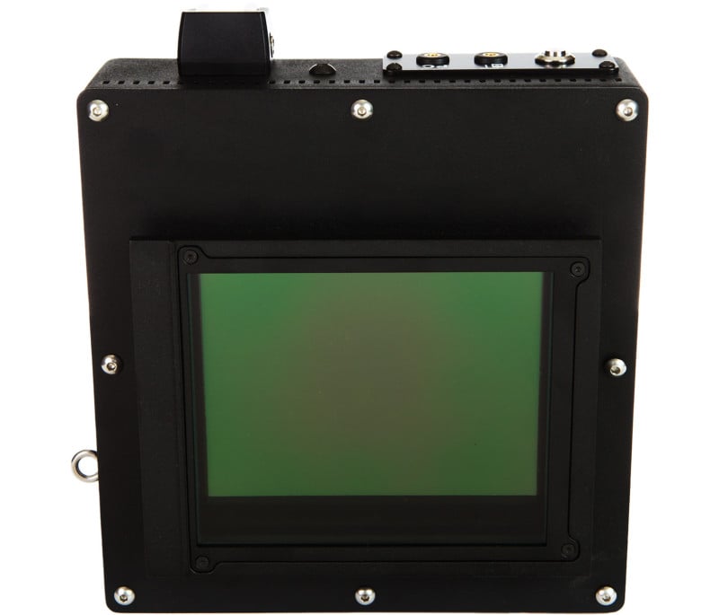

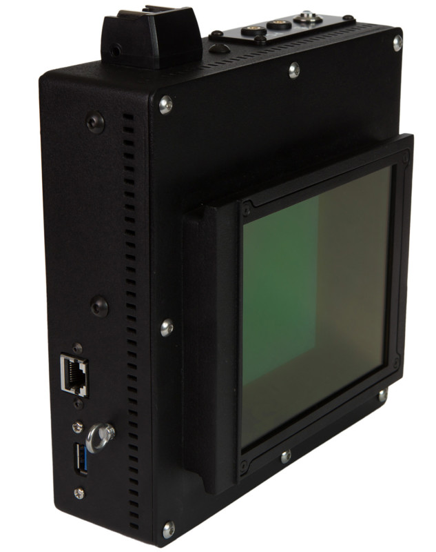

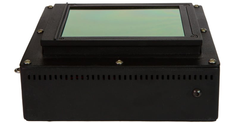

LargeSense has announced the first commercially available 4×5 digital back: the LS45. It can create true, large-format images in a medium other than film and is designed for the Graflok or International standard, can capture both RAW photos and videos, and costs $26,000.
The 4×5 monochrome digital back follows LargeSense’s much heavier 9×11-inch monochrome back that it launched in 2018. In a recent hands-on with the camera, the company noted that future models would be “significantly lighter,” and the launch of the LS45 4×5 back meets that promise.
“I noticed I was getting older so I decided to make a list of what I wanted to get done in my life,” LargeSense’s founder Bill Charbonnet says. The entire LargeSense company appears to be one big passion project for him.
“One of the possible projects I could do was make a large format digital camera. I had tried auto panos, handheld panos, recording a large format projected image, medium format, and so on. Nothing really is as nice as an actual digital large format with a big sensor.”
The LS45 camera is a single-shot 140x120mm 14-bit monochrome CMOS sensor that features an ISO sensitivity of 250 to 2000. LargeSense says that it has 12.2 stops of dynamic range at the low end and 11.65 stops at the maximum ISO. The sensor itself, while massive compared to conventional 35mm sensors, doesn’t have a lot of resolution: it is only 6.7-megapixels, and each pixel is 50-microns in size. For reference, the iPhone X has a 1.4-micron pixel size and the Fujifilm GFX 50S has 5.3-micron pixels. The company says that the large pixel size was chosen because it brings out the “magical 3D quality” of images taken with the camera, and better tones.
While 6.7-megapixels is a relatively low resolution by modern standards, especially considering the size of the sensor, Charbonnet has created a solution. He has developed custom software that uses a “deep learning neural network” can enlarge the photo up to four times, and Charbonnet says the result is as visually good as the native resolution.
