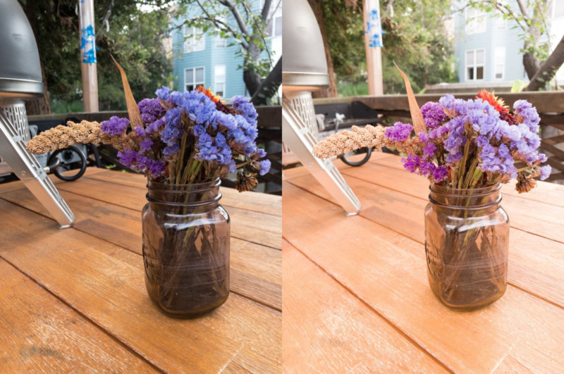

Photos by The Verge
The iPhone XS merges exposures and reduces the brightness of the bright areas and reduces the darkness of the shadows. The detail remains, but we can perceive it as less sharp because it lost local contrast. In the photo above, the skin looks smoother simply because the light isn’t as harsh.

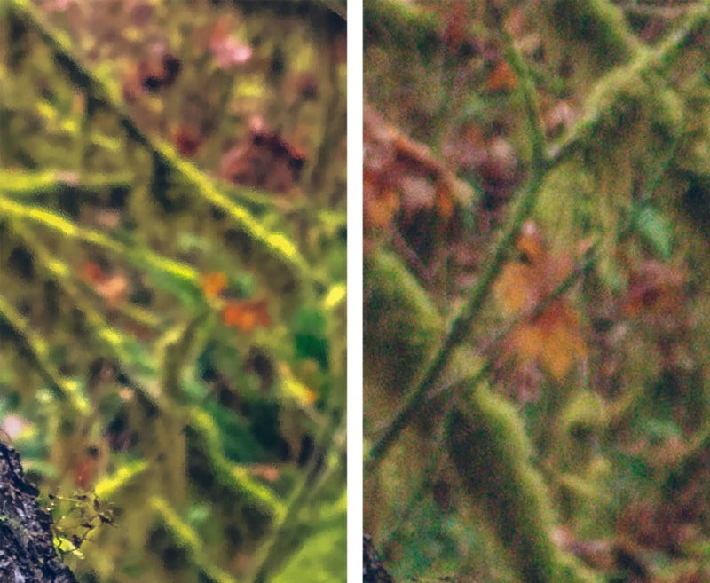

Observant people noticed it isn’t just skin that’s affected. Coarse textures and particularly anything in the dark— from cats to wood grain— get a smoother look. This is noise reduction at work. iPhone XS has more aggressive noise reduction than previous iPhones.
Left: Noise-reduced stock camera app image. Right: RAW capture.

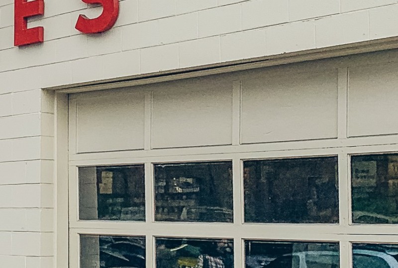

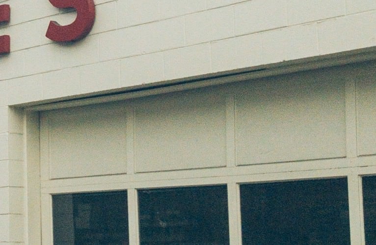

The comparisons above were shot in RAW so the extra noise can be seen — RAW on iPhone omits any noise-reduction steps. Why does the iPhone XS’s frame have to be noisier?
Remember that line-up of frames showing how the iPhone camera works?
Unless you have bionic arms, it’s impossible to hold your phone perfectly still for this long. To get a sharp, perfectly aligned burst of images, the iPhone needs to take photos really fast. That requires a shorter shutter speed — and that, in turn, means that there will be more noise in the image.
That noise has to be removed, somehow, and that comes at a cost: noise reduction removes a bit of detail and local contrast.
