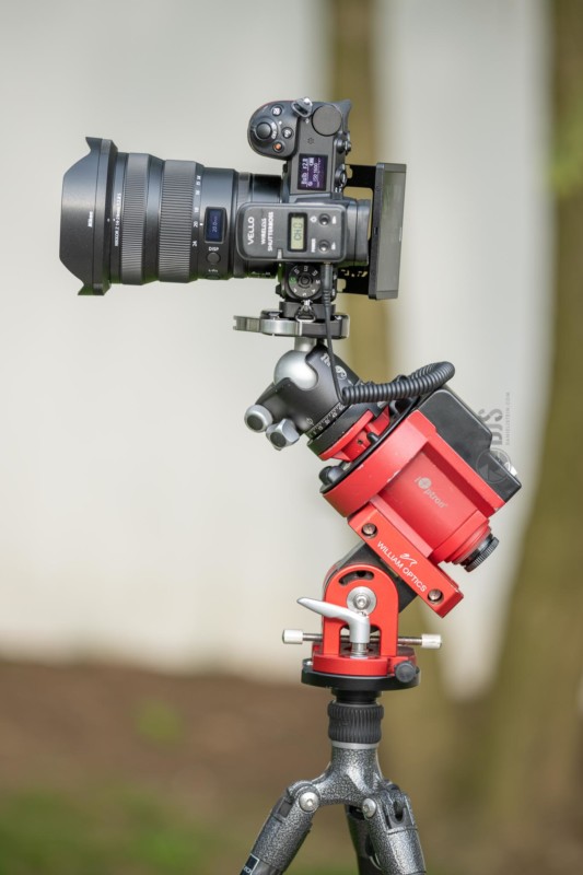

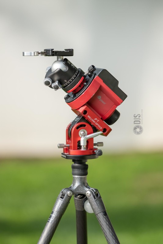

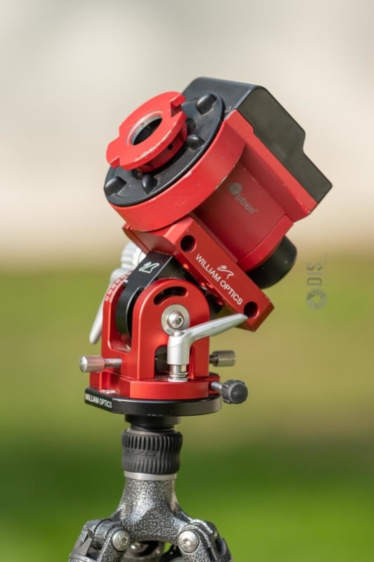

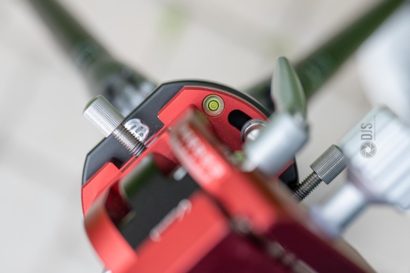

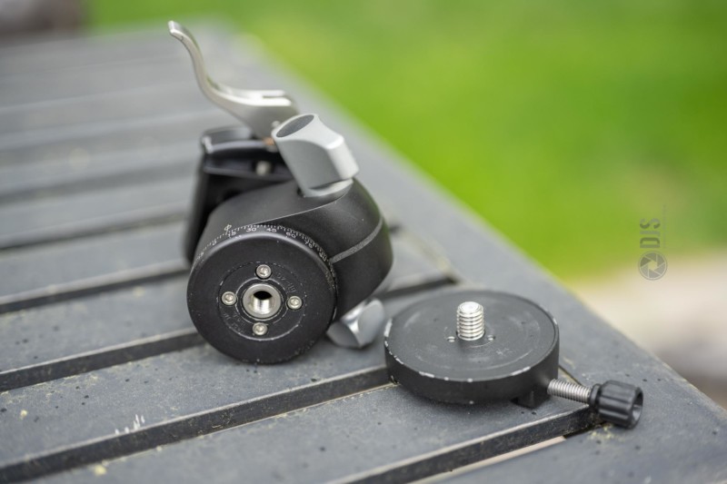

I highly recommend getting a tracker with an altitude-azimuth base or adding one in if the model you want does not come with one and you can afford it. This will make polar alignment a lot easier as they have latitude markings printed on the site and will always keep your tracker level so long as the tripod is level. If not, use what you have for now. It will still work.
Tracker with alt-az base setup.

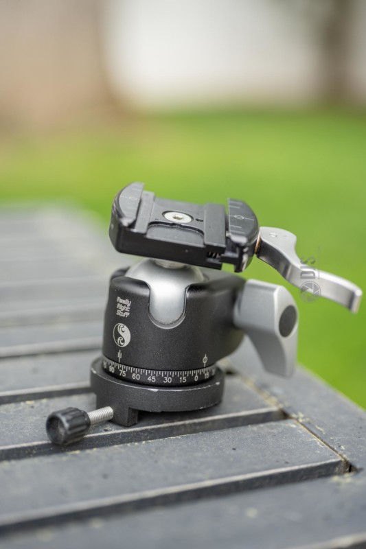

Tracker with double ball head setup.

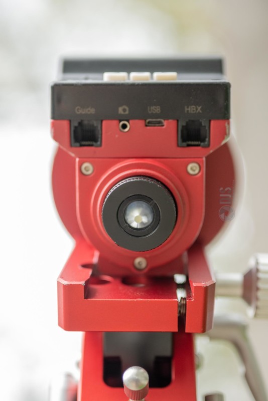

My tracker’s polar scope.

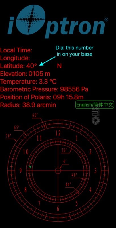

If your tracker has a polar scope instead of a laser, you will need to download a Polar Scope app. This will make it a lot easier to get a bang on polar alignment. The app will also display your latitude for dialing it into your alt-az base.

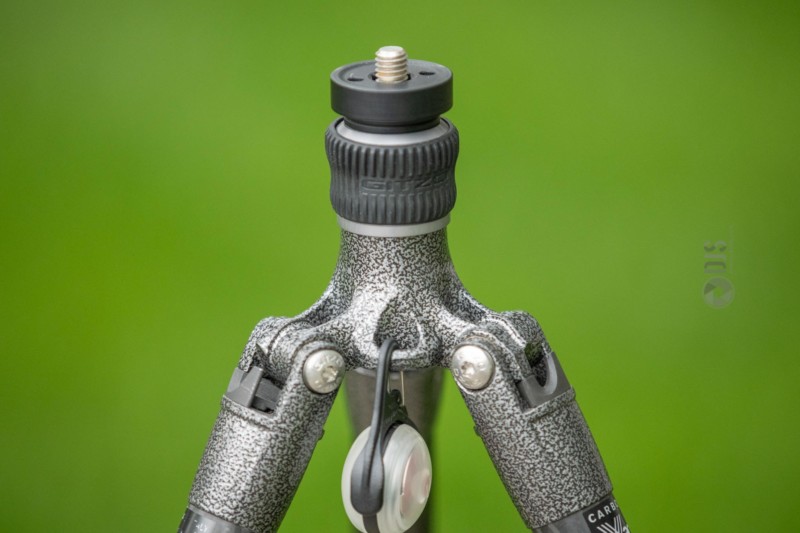

4. Grab your tripod and open it up. If your tracker came with an alt-az alignment base, you will need to remove the head. If you are using an additional ball head on your tracker and keeping the head on your tripod to align, you don’t need to do anything at this point.
5. Next remove the head if required. This will expose the 3/8”-16 standard thread at the base.
Nine times out of ten it will be this size, but if yours has a 1/4”-20 thread you can grab a 1/4”-20×3/8”-16 bushing for cheapies.
6. Screw on the alt-az base your tracker came with, or if you are using an additional ball head to align your tracker, attach your tracker to that head at this point.
Reference the linked pictures to illustrate the two ways to set these babies up.

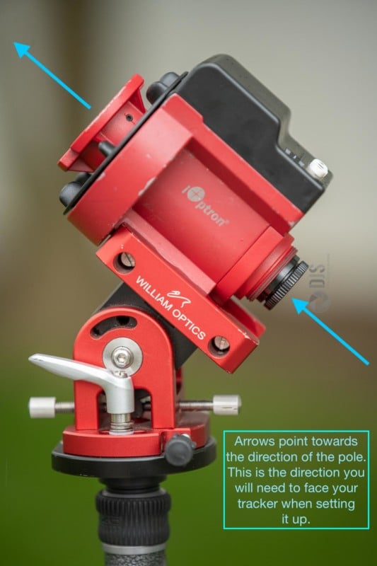

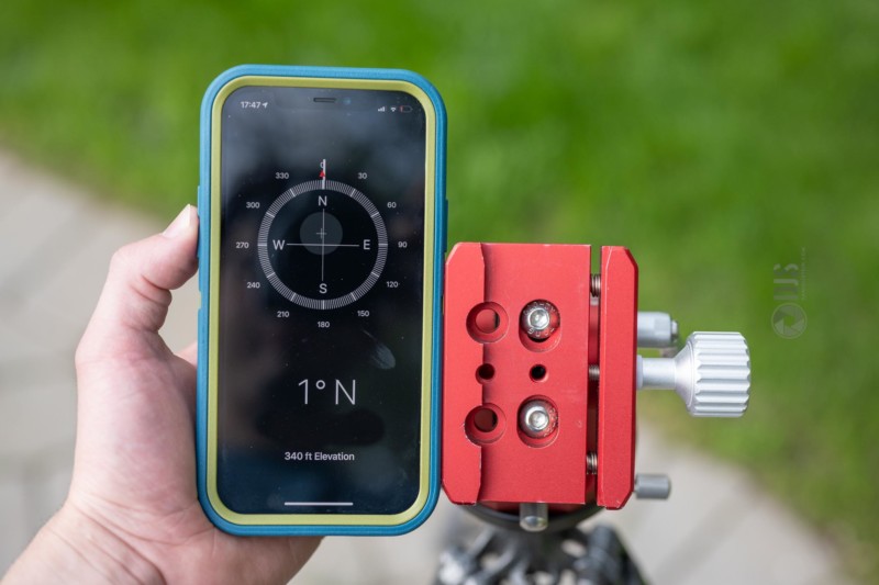

7. Next, and this a little secret I love telling people to help out with a polar alignment, use the compass on your phone to roughly place the direction your polar scope looks towards when mounted on the tracker vaguely towards the pole.
Ok, that sounds like a mouth full, but hear me out. Your tracker either uses a polar scope or a laser to align with the pole. Whichever direction your alignment tool looks towards, is the direction you want to have facing 0º.
It does not need to be spot on at 0º, there are adjustments to correct this on final alignment.
8. At this point, use the spirit level on your alt-az base or tripod if it has one, and level the tripod.
If you don’t have a base or tripod that has a level, you can use your phone. Try to get this as close to perfect as possible.

10. Fire up your polar scope app and notice the number slapped next to the latitude reading.
Use the altitude knobs on your alt-az base to dial this number in as the numbers on your base correspond to the latitude.

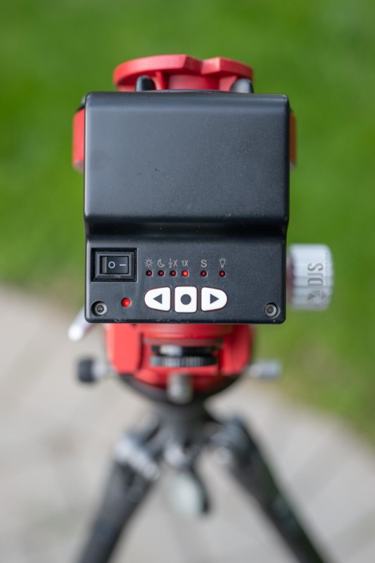

11. Turn your tracker on.
If your tracker has a polar scope, at this point it should be illuminated with the tracker in the on position.
12. Look through the reticle of your polar scope.
It may need to be rotated to a certain position for the red light to illuminate it.
Note: Some trackers have a detachable polar scope illuminator. At this point, you should attach it.
13. If your tracker has a laser instead of a polar scope, attach it.

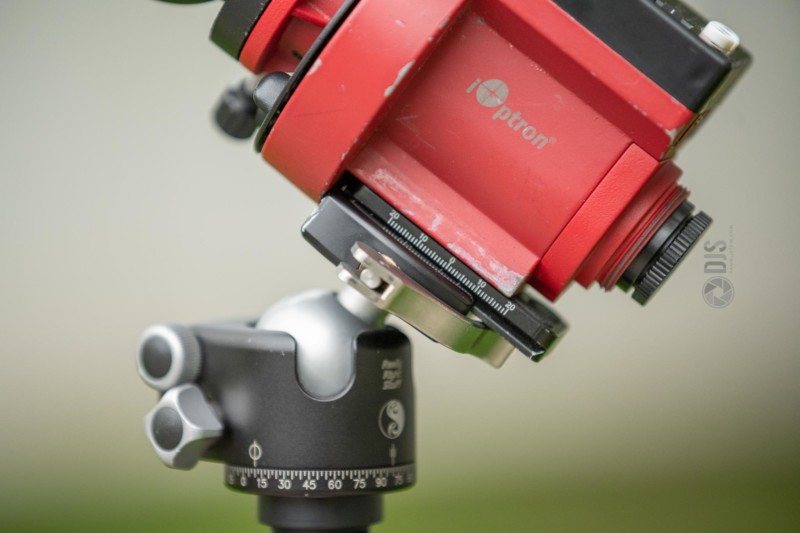

18. Once complete, attach your ball head (or 2nd ball head) to your tracker’s bracket, then attach the bracket to the tracker.

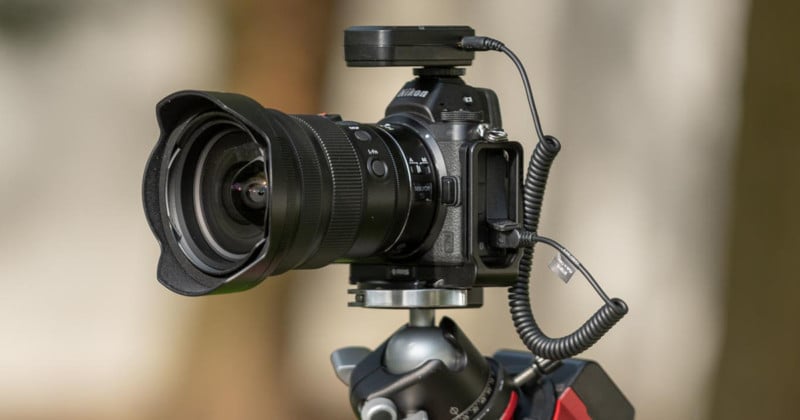

19. Attach your camera to the ball head on the tracker. From now on, all movement of the camera will need to take place using the ball head. DO NOT MOVE THE TRACKER ITSELF. This will mess up your alignment and you will have to start all over again and that is no fun.
20. Pro tip, rotate your ball head so the little notch faces directly up so you can easily correct for the angle of the tracker due to your alignment.

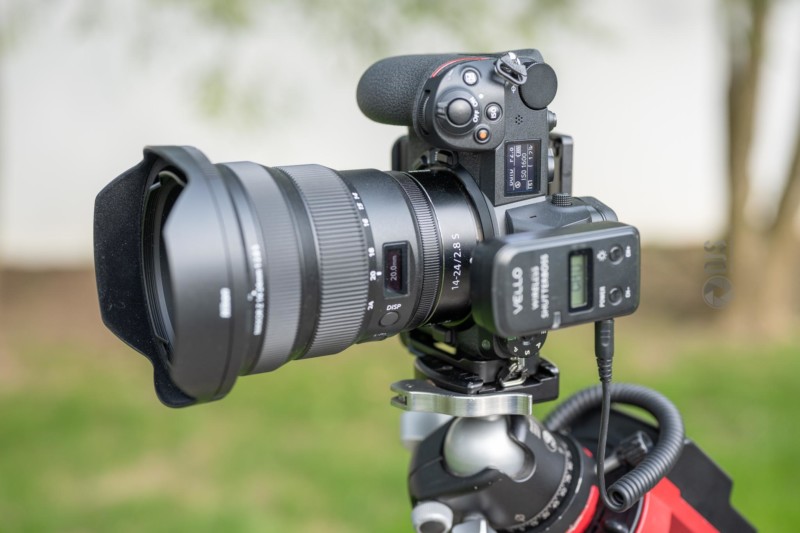

21. Time to shoot!
Frame up some compositions, and use a remote or bulb timer to take a few minute exposures.
The better your polar alignment is, the longer the exposures can be!
