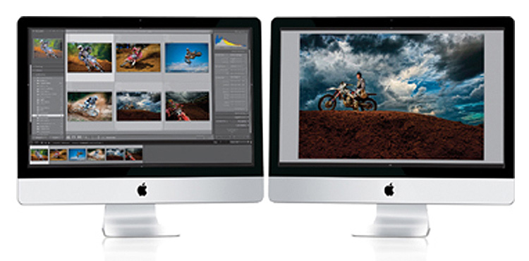

STEP TWO: If you do have a second monitor connected to your computer, when you click on the Second Window button, the separate floating window appears in Full-Screen mode, set to Loupe view, on the second display (as seen at the top of this post). This is the default setup, which lets you see Lightroom’s interface and controls on one display, and then the larger zoomed-in view on the second display.

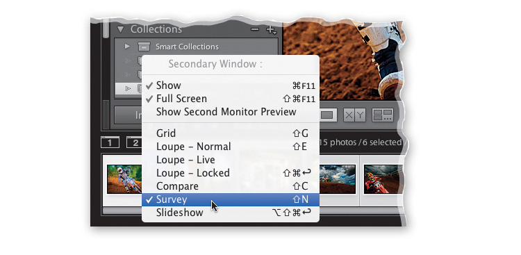

STEP THREE: You have complete control over what goes on the second display using the Secondary Window pop-up menu, shown here (just click and hold on the Second Window button, and it appears).
For example, you could have Survey view showing on the second display, and then you could be zoomed in tight, looking at one of those survey images in Loupe view on your main display (as shown below). By the way, just add the Shift key and the Survey view, Compare view, Grid view, and Loupe view shortcuts are all the same (so, Shift-N puts your second display into Survey view, etc.).

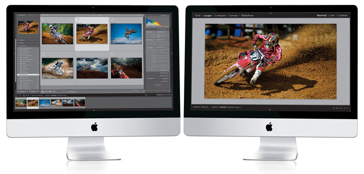

STEP FOUR: Besides just seeing things larger with the Loupe view, there are some other pretty cool Second Window options. For example, click on the Second Window button and choose Loupe – Live from the Secondary Window pop-up menu, then just hover your cursor over the thumbnails in the Grid view (or Filmstrip) on your main display, and watch how the second display shows an instant Loupe view of any photo you pass over (here, you can see on my main display the first photo is selected, but the image you see on my second display is the one my cursor is hovering over—the fifth image).

STEP SIX: The navigation bars at the top and bottom of your image area will be visible on the second display (as seen above). If you want those hidden, click on the little gray arrows at the top and bottom of the screen to tuck them out of sight and give you just the image onscreen (as seen below).
