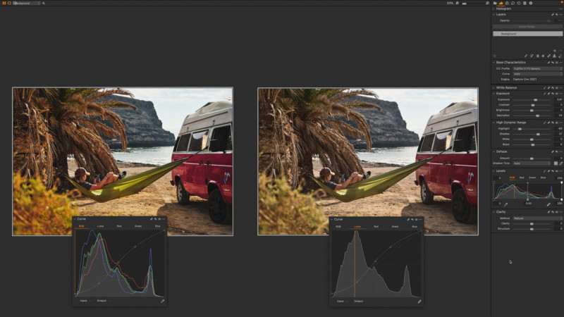

Capture One provides two different types of curves, and it’s one of the main aspects that differentiates Capture One from other software. It has the RGB curve, which changes the contrast of the image affecting also the color saturation, and the Luma curve that only changes the density of the image while keeping the hue and saturation of the colors untouched.
Aside from the Luma curve, everything you’re going to see in the video is applicable to any other software that has the regular RGB Curve tool. For example, take a look at this colorful image:
I applied the same adjustments. On the left, we have got the edited version using the RGB curve, and on the right using the Luma curve. And, as you can see, in the Luma version, the skin tones are very pleasant and well-controlled. Whereas, on the RGB version the skin is oversaturated with strong reds and is way over the top.

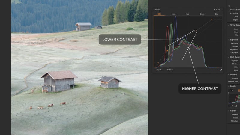

The most common example that people often do to add contrast is a simple so-called S-curve.
They will add a couple of anchor points, one on the shadows and another on the highlights. Often lifting the highlights a little bit, while dipping the shadows ever so slightly, creating a gentle S-shape. It’s a nice approach, and it definitely works, but most of the time it’s too generic and that adjustment doesn’t differ too much from the result achievable just dragging the regular Contrast slider.
We can definitely go more in-depth than this and get a much more targeted adjustment.

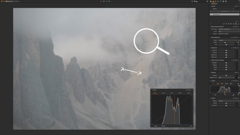

First things first: we want to analyze the levels of brightness in the image, and just moving the mouse over the image, the curve panel provides a vertical orange line that indicates the brightness level of the area we’re moving over.
What we want to do is to identify the areas we want to improve in terms of contrast. In this case, we want to increase the contrast between the rocks and the smooth levels in the scree slope.
If we draw a basic s-curve, just raising up this generic part of the highlights and decreasing the shadows, the result is nicer but it’s not enough for my liking, and the adjustment is not targeted to the image content. This is a great example of why a simple s-curve is not always the best solution. One size doesn’t fit all. We can definitely achieve a better result.

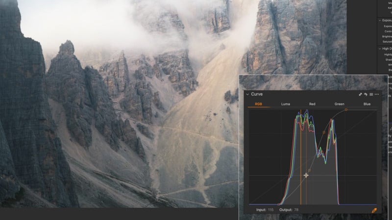

Now we’re going to set the black and white points dragging the two respective dots, and we can already see a nice contrast improvement, and also an increase in colors saturation.
Then we’re going to add a few anchor points based on the tonal value of a specific zone in the image.
We’re going to add an anchor point on the scree slope and another one on the rock. Our goal is to increase the distance in terms of brightness value between the two elements. Just increasing the brightness dragging up the upper dots dot, we can immediately see an increment of the contrast.
Bringing down the lower anchor point assigned to the rock, we can add even more contrast. But now we’re losing detail on the shadows area.

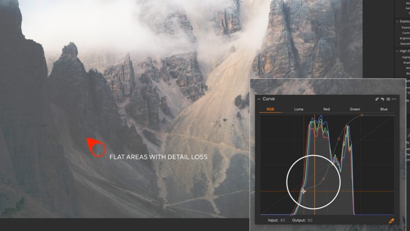

Whenever you have a horizontal flat line, that’s means you are flattening details. Some areas of the image start having the same tonal value, and the photo starts to look blotchy. It’s very important to avoid flat horizontal lines in your curves, at least, when you’re not creating it on purpose (for example to create the film/faded look).
Now, how can we solve the problem? Here is the trick. To mitigate the issue of the flat curve and losing details, we need to add an extra anchor point right after this one, just when the mouse changes its pointer icon. And now what we want to do is to straighten up the curve.
In this way, we can keep the localized contrast adjustment without crushing the shadows too much.
We still have enough room to improve the contrast even more in this rock wall adding another anchor point here on the lower part of the curve. If you like, we can add one last dot at the top of the curve to add even more punchiness to the clouds.
Here is the final result using a targeted curve based on the image content and not just applying a couple of random anchor points for the shadows and the highlights:

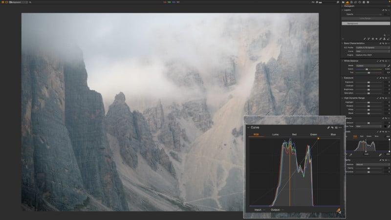

Here we have got a low-contrast image and our goal is to increase the contrast using curves. But instead of using the basic S-shape, I want to show you how I like to tackle these kinds of images creating a more intricated curve targeted to the image content.
