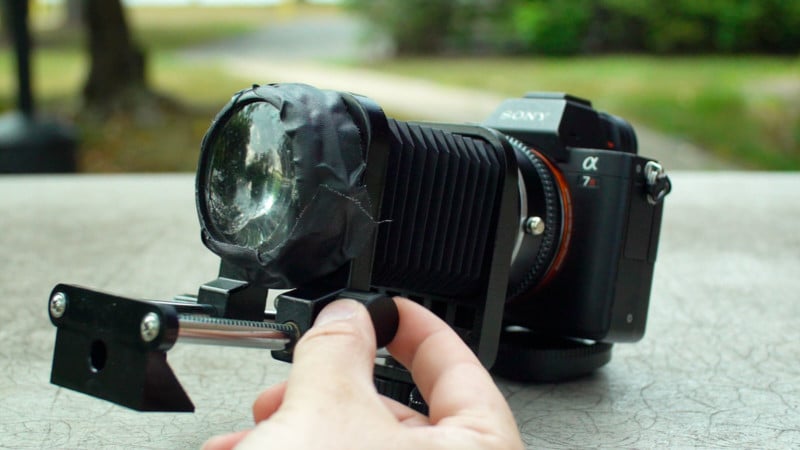

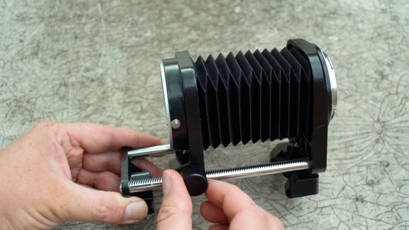

To do so, Sean used a magnifying glass with its handle cut off and a Fotodiox Canon EF macro-focusing bellows. Bellows like these are generally used by photographers to help achieve extreme close-ups at a fraction of the cost when compared to purchasing a dedicated macro lens.
He adapted the bellows to his Sony Alpha 7R camera using a second Canon EF to Sony E-mount adapter, while the magnifying glass was added on the outside to allow Sean to focus to infinity. In a typical DIY manner, Sean attached the magnifying glass where the Canon EF lens would go using some gaff tape to keep it in place.

The final build consists of the magnifying glass on the outside, followed by the macro bellows, and the ND Throttle Adapter which is mounted between the macro bellows and the camera. To control the lens, macro bellows are used to adjust the focus and the variable ND filter ring is responsible for adjusting the exposure.
