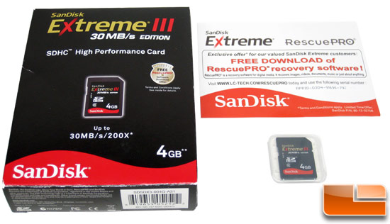

I have bought my 16GB Extreme III CF card from the recent PC Show 2009 and I too have initial scare. I have discover that there is no Vector Magnetics Sticker or the Hologram sticker found on the retail box. However, I manage to register successfully using the serial no. on the card thru the Sandisk website. You could try to register your memory card to verify if it is a genuine Sandisk product too. At least for now I know my card is genuine Sandisk's Product and no more worries that the card will not work as expected. Unfortunately only shop warranty of 5 years is given instead of the lifetime limited warranty printed on the retail box.
http://www.sandisk.com/Retail/Default.aspx?CatID=1668
Check and found the package of the reviewed Extreme III card do not have the hologram too.
http://www.legitreviews.com/article/941/1/
