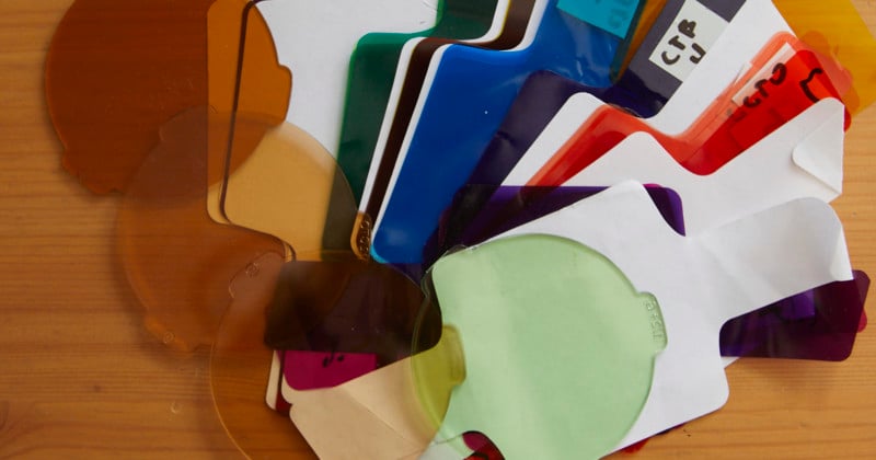

As this is a very interesting part for many photographers, I’ll cover this at the very start. Long story short, it doesn’t really matter… except that it does. In order to mix ambient light with the flash, you will need a set of color gels. Those are sold by pretty much every retailer and lighting brand there is on the market.
Profoto makes great gels that magnetize on its A1-series flash. I love using them as they are fast, practical, and hassle-free. They’re similar to what MagMod does. The only reason I mention Profoto is that I bought and use it on assignment — this is in no way an endorsement of the brand.

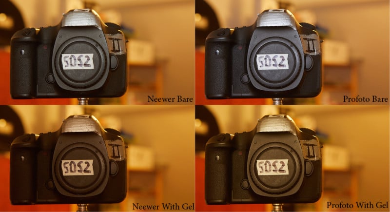

To prove my point here are two photos, one with Profoto gel and the other with a generic gel from Amazon:
Comparison photos of Profoto and Neewer color gels
There is an inconsistency between the two, which stems from the flashes having different color temperatures. However, as you can see, adding any gel to a flash does the exact same thing: it changes the color of the light.

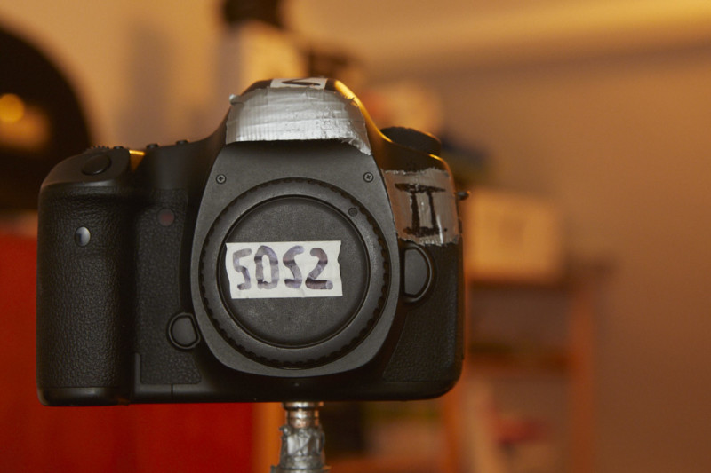

Commonly used light bulbs are rather warm, even if they appear to be white and normal. The reason they do is that we’re used to them, and many photographers are shocked when they see that their white flash didn’t mix perfectly with the “white” bulb.
A DSLR camera on a tripod
A way to determine the color is to take a test shot. If there is any difference between the background color and the flashy part, you will need to then go ahead and see if the background is blue or orange.

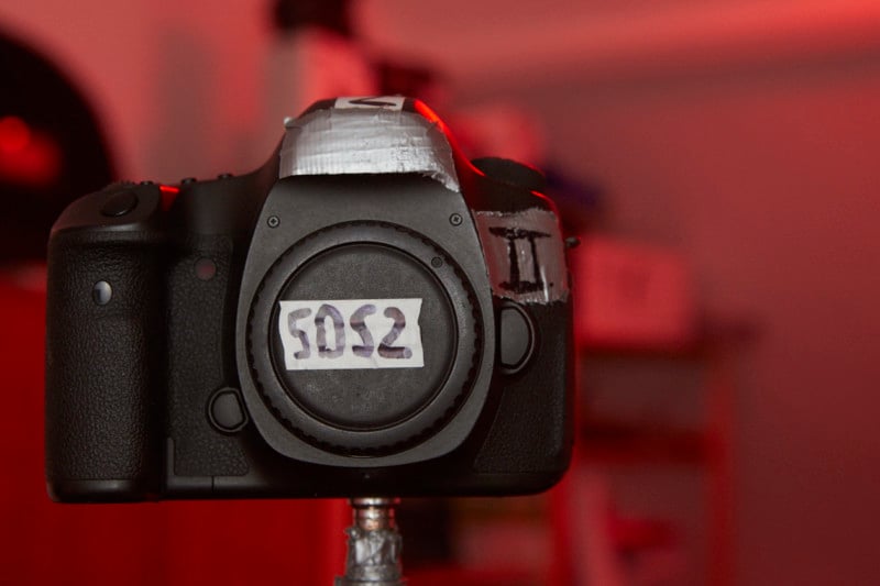

The last part of analyzing your scene is looking at walls. If they’re anything but white, you will have a color cast. An orange wall will warm up the whole image while a blue one will cool it down just because it will reflect not white, but orange or blue light (the reason we see color is because surfaces reflect the light of different colors).

Step 2. Pick the Right Gel
At the start, this will be guesswork to a large degree. There are a few rules that can help you along the way, though.
First of all, if the room appears to be orange, you want to put a CTO gel on your flash. CTO stands for color temperature orange, and it will make your light warmer. In my camera bag, this is the most used of them all. Thinking back to my event days, I used a CTO any time I went inside, as 99% of the time, the lights inside are warmer than my flash.

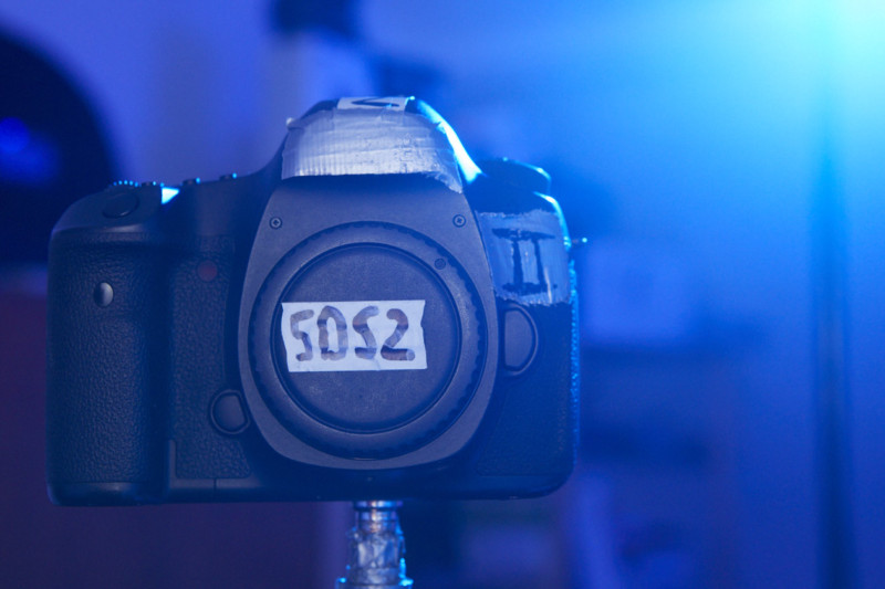

If the setting is colder, go for a CTB gel. CTB stands for color temperature blue, and it will cool the light down. This is often the go-to gel for photographers working in nightclubs or in moody bars.

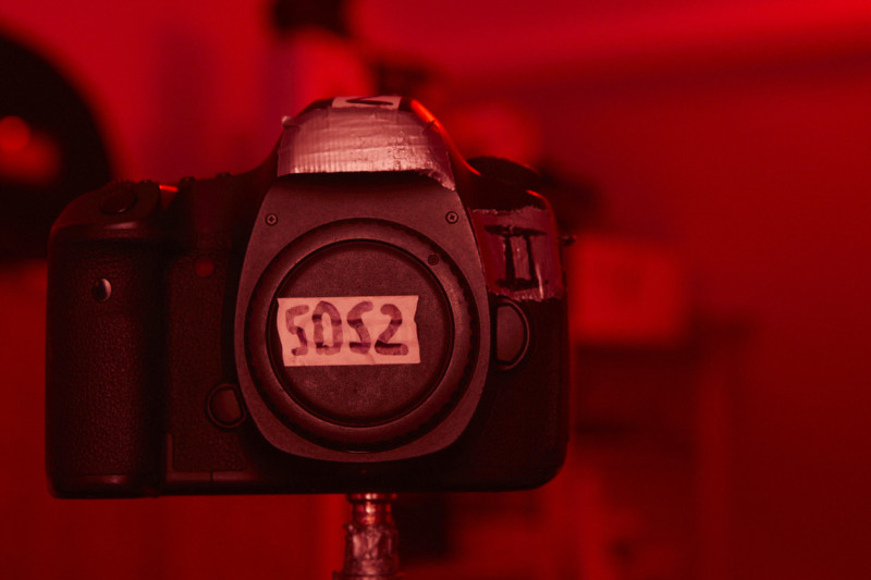

Afterward, if the room is anything different, you can add extra gels, such as red, to match the colors precisely.
The last step is to get the right amount of CTO or CTB or any other gel. There are full, half, or quarter gels. A full CTO gel will make your light incredibly warm while a quarter will be slightly noticeable but not too much. If you are in a candlelit room, a full CTO will be the right choice.
