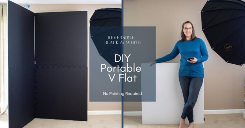

Having a portable V-Flat in your photography kit can provide a unique tool when creating images for your clients. A V-Flat can be used as a background or a tool to bounce or absorb light on your subject.
Have you ever thought about making your own portable V-Flat to add to your photography kit? You are not alone. There is a commercial option on the marketplace but I wanted to challenge myself with a fun DIY project.

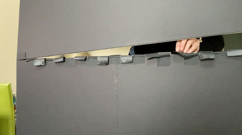

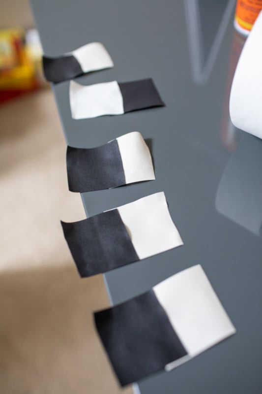

Once all 8 square are joined together you can start making your gaffers tape pieces to make the assembly easier. Cut 4″ inch pieces of white and black gaffers tape.

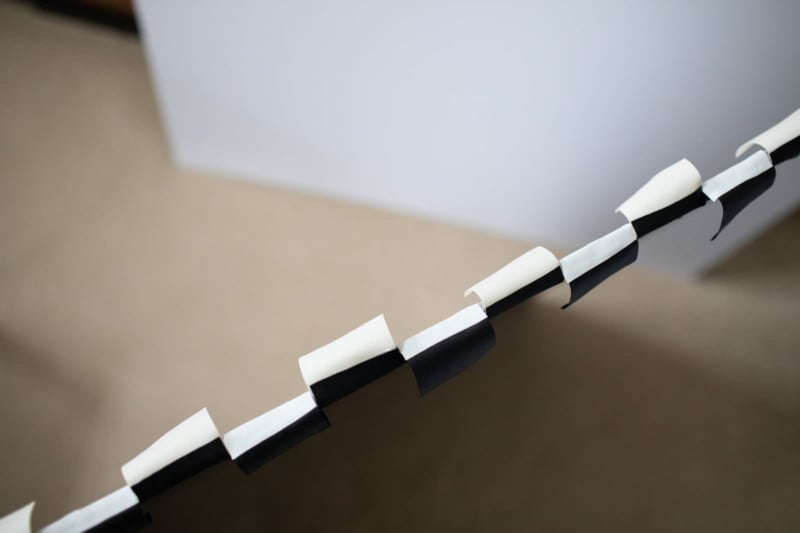

The first section you will join are the top 40×40 squares you would like to be the bottom of the V-Flat (I opted for the boards that have the “20 inch joined pieces”) Attach one sticky side to one non-sticky side. The space in the middle that is non-sticky on both sides will be the part you rest on the foam board.
Tip: Alternate from black and white. Slide the next piece so it’s touching the last piece you placed on the board. (View video to see this in action).
When adding the top piece of foam board to the bottom piece I found it easier to line up all the gaffers tape pieces first, then rest the board on top and work on each piece from there. The gaffers tape is forgiving so if you need to adjust and make it tight you can do that. (Watch video to see how I worked on this part).

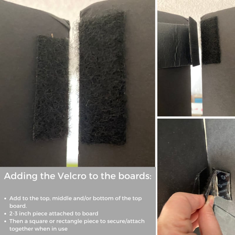

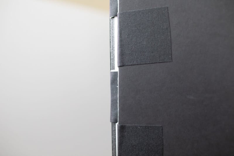

The last step is to add the Velcro to the black top section. I added one to the very top and tested how the seam looked. After using mine, I have also added a second Velcro to the lower to middle portion of the board too.
Examples of black side of DIY V-Flat (in post I removed the “taped” area):
