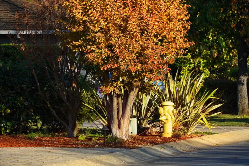

This is the original 135mm focal length image downsized from 6000 to 1500 pixels for sharing or publication online:

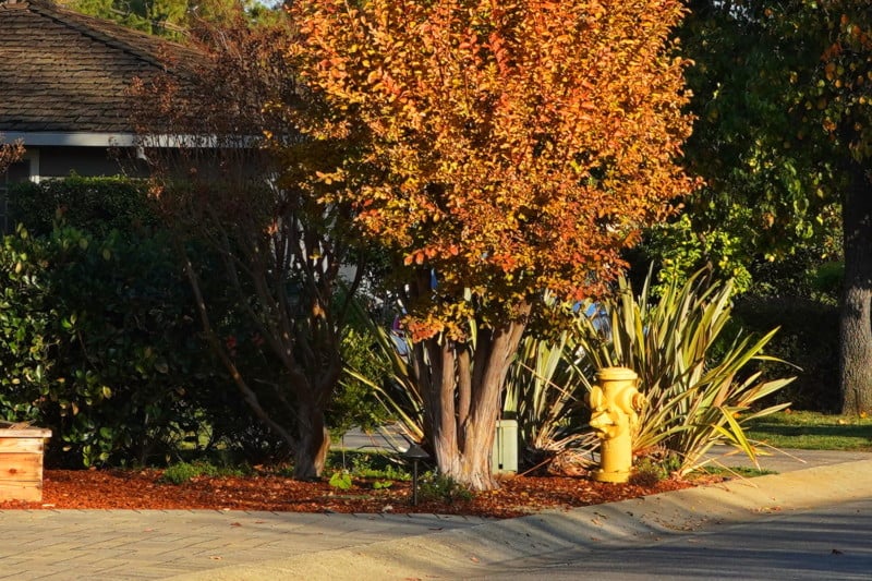

This is a 32mm focal length image shot from the same place, cropped to 1500 pixels wide :

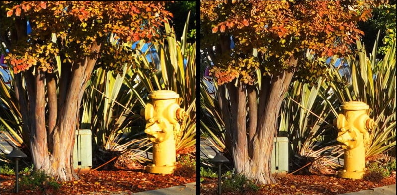

Here are 500 pixel crops taken out of above two images to aid pixel peeping:
Crops from 135mm image (left) and from 32mm image (right).
Theoretically, the 135mm image should be better because when it was resized from 6000 pixels wide down to 1500 pixels, extra information was packed into the resized image. But it’s very difficult to detect that, even with the help of these crops.

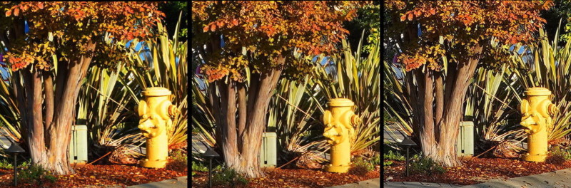

You can push the 4:1 ratio farther if you’re willing to accept the image degradation caused by upsizing your cropped image. I tried upsizing a pic of this scene shot with my lens at 18mm. It required upsizing 1.88x and looked pretty rough. Next I tried simulating a pic of the scene as if shot at 26mm which required 1.25x upsizing. Here is a crop of it compared to the others:
From 135mm image (left), from 32mm image (center), and from 26mm image (right).
And above is the full image. This required 1.25x upsizing and 50% sharpening. The ratio between this shot and the original 135mm shot is about 5.3x.
