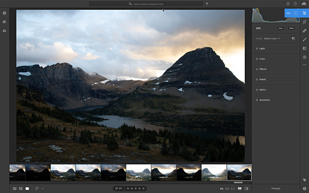

STEP ONE: Starting in Grid view (G) or Detail view (D), press the E key or click the Edit icon in the top-right panel to gain access to the editing tools. Note, a Filmstrip will appear along the bottom, which is helpful for moving between photos, but can be closed by clicking the Filmstrip icon (bottom of interface) or pressing the forward slash key (/).

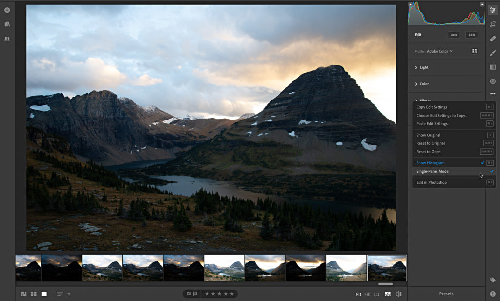

STEP TWO: Click the three-dot menu (under the Edit icon on the right-edge) to see the options it contains. I recommend making the Histogram visible and turning on Single-Panel Mode (like Solo Mode) so that only one panel is expanded at a time. Note that you’ll also find the commands for copy and pasting settings, showing the original image, resetting edits, editing in Photoshop, and all of the associated keyboard shortcuts.

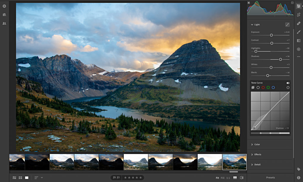

STEP FOUR: Expand the Light panel to access the tonal value controls (no Basic panel here) and adjust as needed. Click the Tone Curve icon in the upper-right of the Light panel to open the Tone Curve panel for additional control over brightness and contrast.

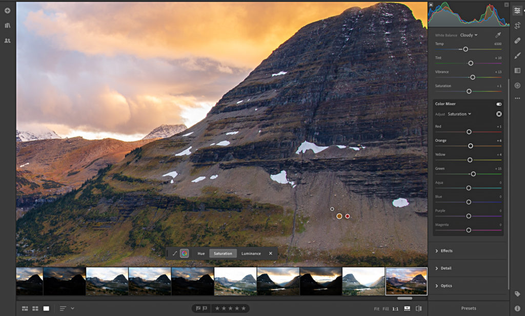

STEP FIVE: Expand the Color panel and adjust White Balance, Vibrance, and Saturation as needed. Click the Color Mixer icon in the upper-right of the Color panel to open the Color Mixer panel (think HSL panel in Lightroom Classic) to fine tune color adjustments. Note the Target Adjustment tool (cross hair icon) allows you to adjust Hue, Saturation, and Luminance by clicking and dragging within in the photo.

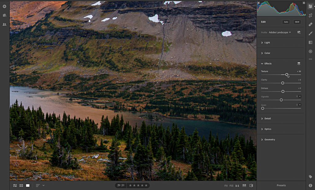

STEP SIX: Expand the Effects panel to adjust Texture, Clarity, Dehaze, Vignette, and Grain. Click on the photo to zoom into to 1:1 view or click the 1:1 icon (bottom of interface) when adjusting Texture or Clarity. Note that the Split Toning icon also lives in the top-right of this panel.

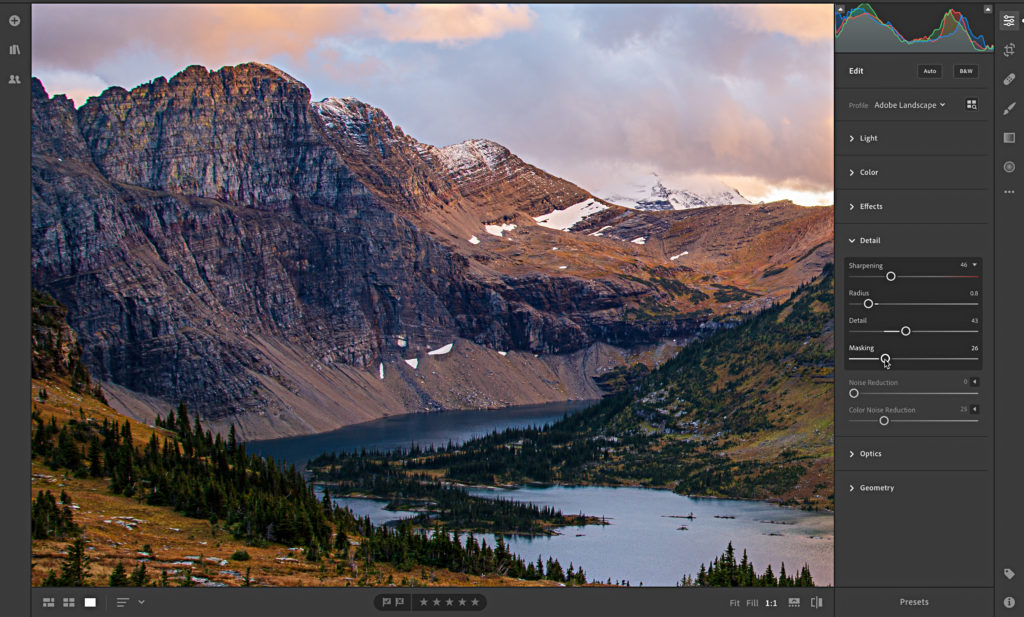

STEP SEVEN: Expand the Detail panel to access controls for Sharpening and Noise Reduction. You’ll want to remain zoomed into 1:1 for this, and then click the disclosure triangle next to Sharpening to find the familiar controls for Radius, Detail, and Masking. Just like in Lightroom Classic, you can hold the Option key (PC: Alt) while moving any of the sharpening sliders to see an alternative (and helpful) view of how that adjustment affects the photo.

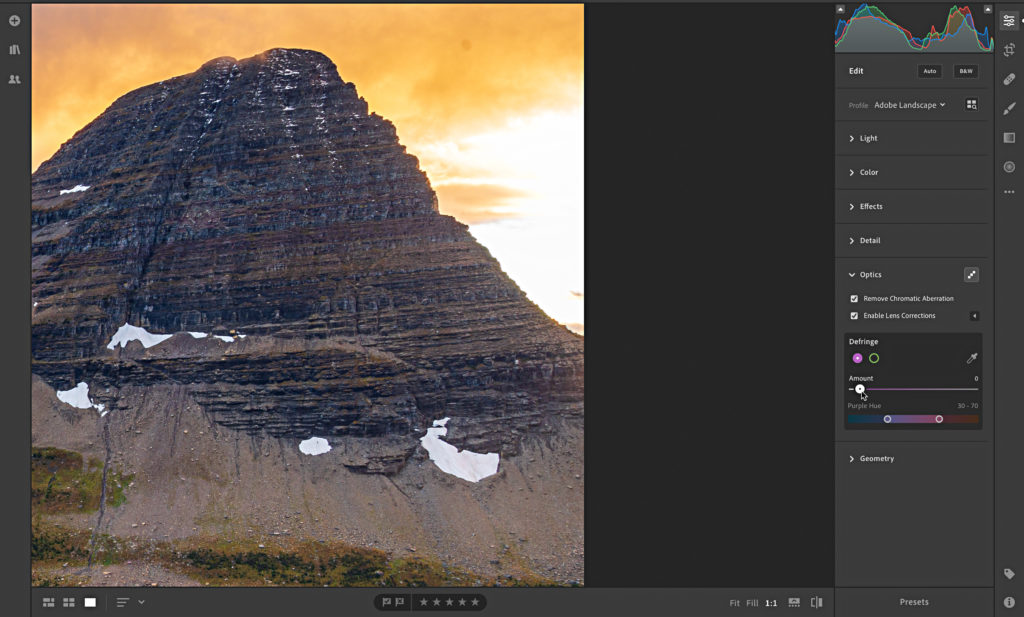

STEP EIGHT: Expand the Optics panel to automatically remove Chromatic Aberration and Enable Lens Correction. If the checkbox alone did not remove the green or purple fringe, you can click the Defringe icon (upper-right) to access additional controls for removing color fringing.
