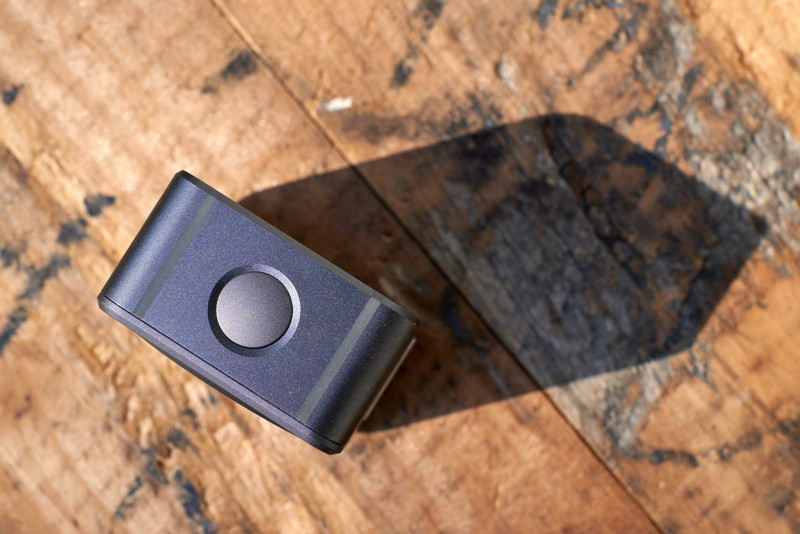

A big lens covers most of the front face and offers a 155-degree field of view with a fixed f/2.8 aperture. At the bottom of the lens is a color temperature sensor, there is also a microphone on the bottom right, and a status light on the top left. The topside of the unit features a prominent dual-purpose power and record button.

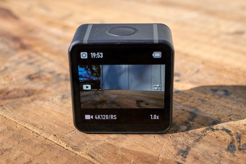

On the back of the device is a 1.76-inch OLED touchscreen display covered with Gorilla Glass. Navigating the touchscreen is for the most part responsive, even while wearing bulkier touch-enabled gloves. To make the most of a small display and a device that has no control buttons other than the one to record, swipe gestures and touch is leaned on by the software extensively. As a result, expect an initial learning period you’ll have to nail down and figure out to remember where everything is hidden before you can reliably operate the Action 2 on the fly.
One trick I had to learn is that although many of the interface settings are depicted as a wheel you scrub or swipe through, it’s far more accurate to tap along the wheel to the next setting. For example, tapping the shutter speed setting up twice to go from 1/60 to 1/80 to 1/100 rather than attempting to swipe 1/60 to 1/100 in one motion. When I swipe directly to the setting, it never seems to stick to where I want it when I let my finger off the screen.

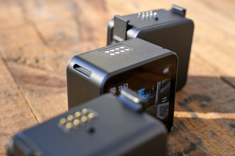

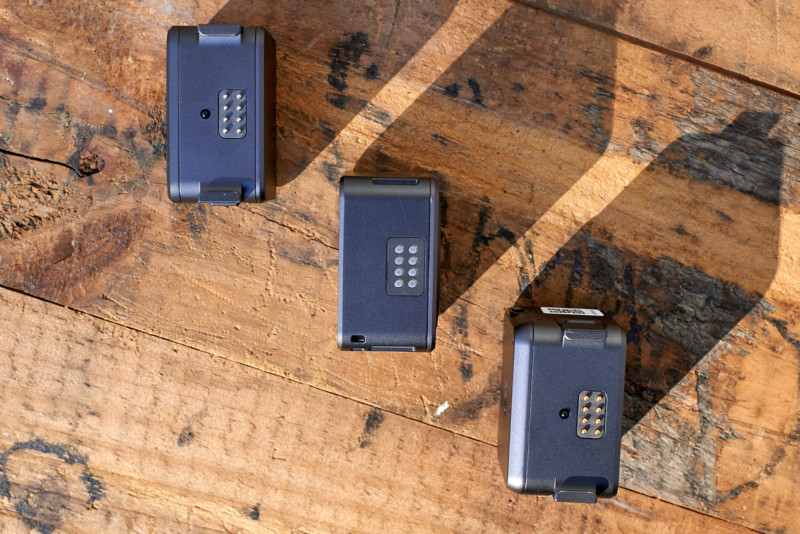

The bottom of the Action 2 camera hides what is the camera’s defining feature: a magnetic expansion port. The magic of this device is its ability to magnetically attach other modules and accessories without always needing the physical screw-in connectors. When I reviewed the GoPro HERO 10 earlier this month, I was tempted to criticize the prong-style connector in that system because it has always been so annoying to work with compared to any quick-release system out there. While that’s true, it’s also been around forever, and the decade or so’s worth of accessories exist for it making it almost above critique at this point. Call me shocked when I saw what DJI had cooked up.
Magnetic Modules

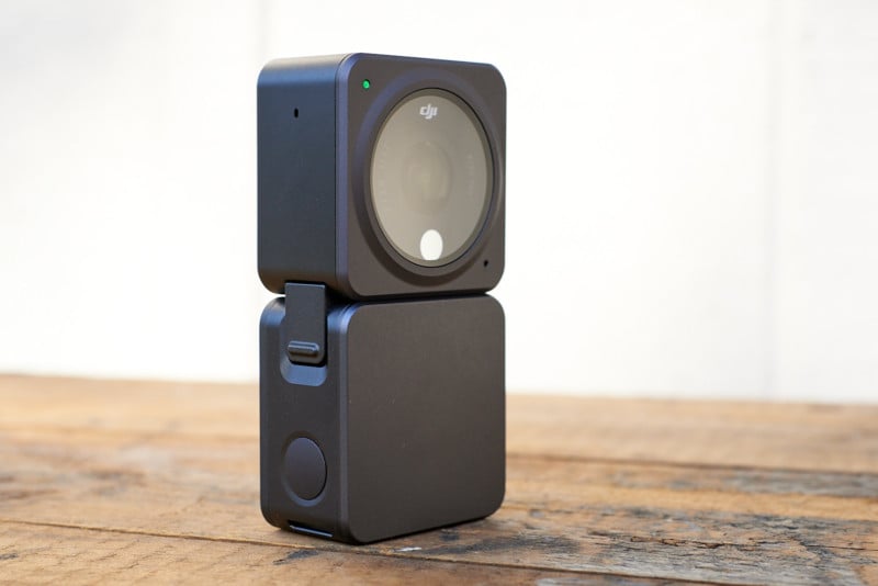

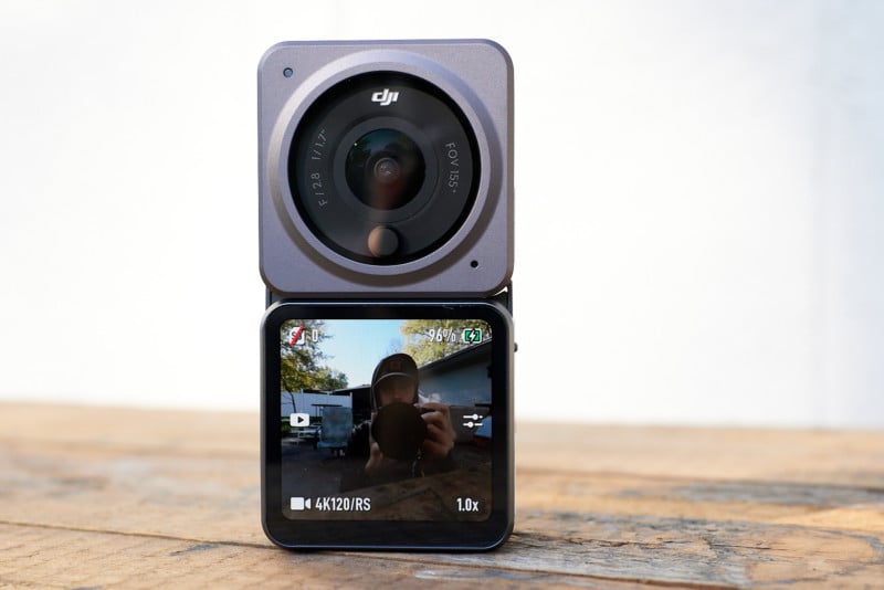

The DJI Action 2 ships in a combo with either the Front Touchscreen Module or the power module. The Front Touchscreen Module adds a front-facing monitor that acts the same way as the one on the back of the camera. Additional benefits to using this module are an extra 90 minutes of battery on top of the 70 minutes of the camera, plus an additional three microphones to record stereo audio coming from every direction.
If you choose to use the Power Module, that’s an additional 110 minutes of power to the camera. This module does not have extra microphones, however both modules do have a microSD card slot to expand the 32 GB internal storage of the Action 2 camera.

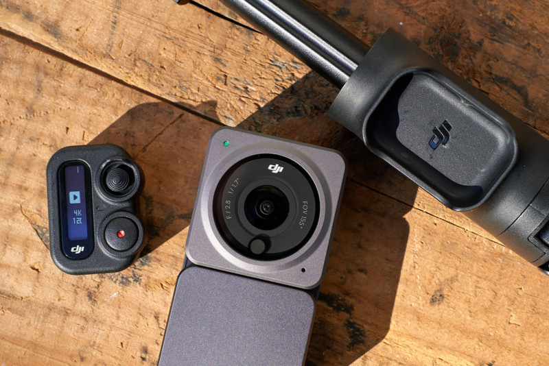

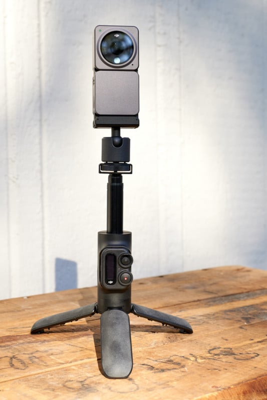

This extension rod is of course useful for self-filming and has built-in mini-tripod legs. Of note here is the tiny, detachable remote control that can be magnetically attached to the rod to operate the Action 2 from your gripped hand or removed and used to remotely trigger the camera via a Bluetooth connection. I really like the usefulness of this, but one big flaw is that the magnetic connection between the extension rod and remote is very weak. I’ve had it accidentally pop off a couple of times and I’m just lucky I saw it happen before it was lost forever.

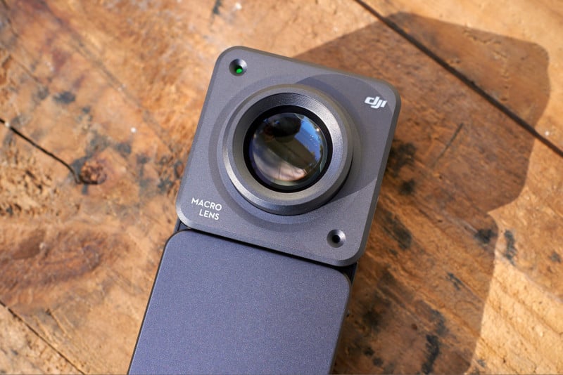

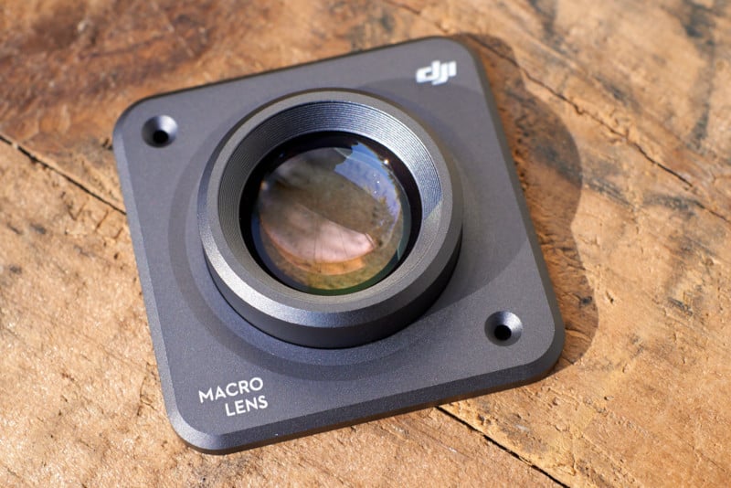

The other Action 2 accessory worth mentioning is the Macro Lens. The Action 2, like any other action camera, has a fixed focus lens that depends upon the fact its vast depth of field inherently covers almost everything in front of it. Almost everything, because it still has its limits when objects are very close to the camera. The DJI Action 2 Macro Lens is a magnetic attachment that simply pops right onto the front of the camera and allows for focus to be achieved at extremely close distances. It’s an either-or situation, so anything that’s not in the macro range cannot be in focus. What I like is that it brings a new type of look to an action camera with its out-of-focus blurring and has the potential to add variety to a video sequence. One problem though is that it does not come with a case, so you have to find your own way to keep the glass safe and clean.

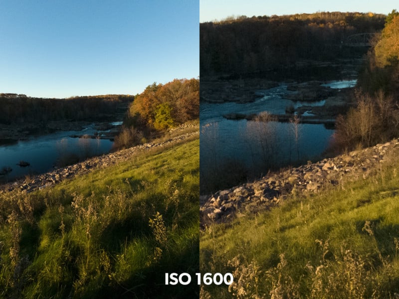

Inside, the Action 2 sports a 1/1.7-inch sensor and is capable of recording video up to 4K 120p. For stills shooting, the camera captures 12-megapixel images in RAW or JPEG. The ISO range in both stills and video is 100 to 6,400, and in my testing, the noise is well-controlled for much of that. The below photos show a downscaled version on the left and a 100% crop on the right.
At ISO 1,600, we see the first notable drop in image quality but details still hold good enough for me. I think for stills, ISO 3,200 is more questionable as the fine line details disappear, however on the video side of things it’s not entirely bad. For video, I think the only ISO I would be cautious of is the maximum of 6,400. Then again, for a casual vlog, I don’t think anything here is entirely off the table and to the point where it’s a complete distraction of the content.

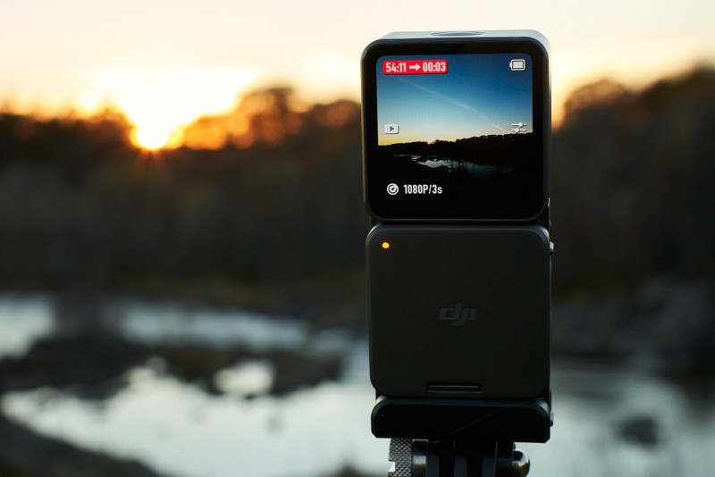

At the end of the video, there are a couple of different clips where I used timelapse mode in-camera. One thing that I liked here is that timelapses can be recorded as both a finished video as well as simultaneously saving individual RAW files. The first time I did a timelapse, I forgot to change the resolution from 1080p to 4K, but in the end, it was saved by allowing me to use the RAWs instead.
