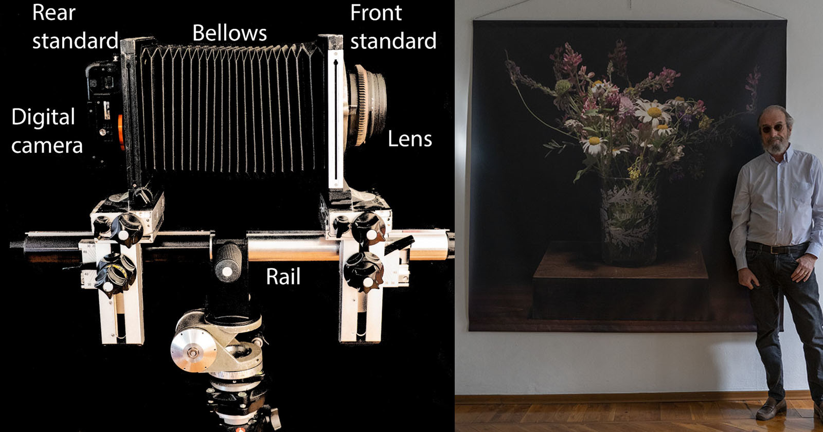

Discarding the convenience of a robotic pano head I had used rather extensively for other projects, the solution I devised was to use a digital camera (namely a 16MP APS-C Sony NEX-6 camera) mounted on the back of a Sinar 4×5 monorail.
The coupling of a digital camera to a large format camera has been recently discussed in other articles. The methods proposed basically use the large format camera as a lens system placed in front of the digital camera to shoot a single image. While this strategy can yield interesting results, it really falls short of the potentialities and it is not a solution for the problem at hand.
Instead of taking a single picture, I used the movements offered by the back of the monorail, namely rise and shift (more on this later), to produce a mosaic panorama that can consist of more than 60 images. Once I captured the mosaic images, I produced the final image by composing them through panorama software, such as the one provided by Photoshop, or PtGui or GIMP. The composition of these images can yield final images larger than 400MP with rather inexpensive equipment.

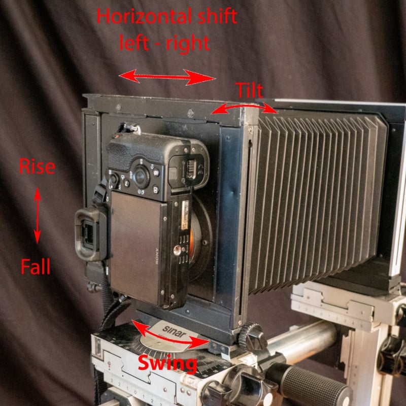

A Primer on Large Format Monorails

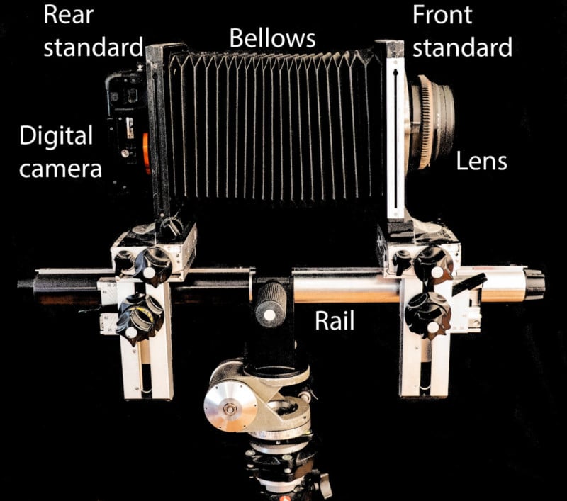

For those not familiar with view cameras, and monorails specifically, some explanation might be in order. This is a Sinar P1 monorail:
A Sinar P1 monorail
It is a very simple camera composed of:
1. Two Standards. The front standard holds a lens, and the back or rear one usually holds the film and/or the ground glass for focusing and composing the image. In this case, a digital camera is connected to the back instead.
2. Bellows. This links the two standards, that can be extended or compressed, according to the distance between the two standards that varies to allow focusing.
3. The Rail (in this case a single rail, i.e. a monorail). This allows the movement to and from in both standards for focusing.
What makes this apparently primitive camera interesting is the fact that these standards can move along three axes and they can tilt and swing.
Camera movements
The above photo shows the rear standard movements: horizontally (this is called a shift), vertically (this is called a rise or a fall), and finally inclined with respect to the vertical axis (tilt) and inclined with respect to the horizontal axis (swing).
I will defer the discussion on tilt and swing, and concentrate on the other movements offered by the rear standard. By moving the back (on which the camera is mounted) left to right and top to bottom, we are able to shoot portions (mosaic images) of the large image produced by the camera lens. To wit, it is just as if we photographed portions of the image shown on the ground glass (but without the ground glass). We are not moving the lens and consequently there is no parallax error. That’s it.
