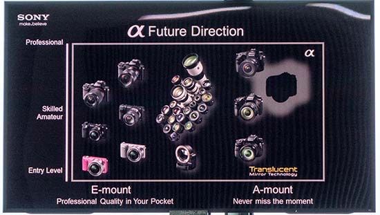

Actually, this might have been true a year ago, but Sony has released a lot of E-mount lenses for NEX and you can get just about anything you need. They are slightly bigger than M43 lenses, but are very light.
Yep. And sony just killed NEX. Will sony really support 3 mounts and produce all the necessary lenses for 3 mounts? Caveat emptor.
Depends on what you mean by "kill". The E and FE mounts are the same mount, just one has a full frame image circle. Sony isn't going to use the NEX name anymore, but is still going to produce APS-C cameras in E mount. The E and FE mounts are identical. A FE lens works fine on a NEX, and it gets the 1.5x crop factor. An old or new E lens works fine on the full frame A7. The camera will automatically recognize it and use just the smaller part of the sensor.
It is so.
There is NO FE Mount, they don't call the Mount the A7 or A7r is using as "FE" Mount. It is still E-Mount.
But they do call the lens A7 or A7r is using as FE lens which means Full-frame E-Mount Lens.
You can directly mount the Nex lens onto A7 or A7r albeit with cropped image, you only need an adapter for A-mount lens
And they just collapse the NEX brand under Alpha and focusing on two Mount i.e. E and A mount
Do correct me if I am wrong

It is so. There is NO FE Mount, they don't call the Mount the A7 or A7r is using as "FE" Mount. It is still E-Mount. But they do call the lens A7 or A7r is using as FE lens which means Full-frame E-Mount Lens. You can directly mount the Nex lens onto A7 or A7r albeit with cropped image, you only need an adapter for A-mount lens And they just collapse the NEX brand under Alpha and focusing on two Mount i.e. E and A mount Do correct me if I am wrong PS from Sony Alpha Rumour: **** In October we had that big A7-A7r announcement. But it won’t be long until we will get our next big Sony event: A trusted sources already unveiled to me that Sony will launch new APS-C and Full Frame cameras in Q1 2014 already! He couldn’t unveil more details, he only added one hint: One of the new cameras will be very loved by the SAR community **** Also,
Lol. My bad. I stand corrected. Yes. Sony only has 2 mounts A & E. But 3 series of lenses. A mount, E mount. And E mount FE. Hmm. Putting too many eggs into different baskets IMHO.
The E and FE is no different from Nikon's DX and FX - same mount, different glasses for the respective sensor size.
Changing Nex to Alpha is just a rebranding exercise. No big deal. I think it is better and less confusing. :)
