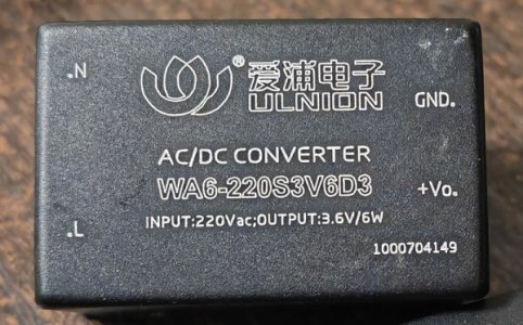

My DB-036 digicabi bought in 2019 May just stop working. I remove the "PSU" casing to check if its dead, and it really is dead.
The fuse is blown, all capacitors, polyester and electrolytic are out of spec. The bigger yellow polyester at AC side should be 0.1uf/275VAC but measure using 100Hz frequency is 2.2nf@few KΩ! the DC side electrolytic is 100uf/16v is way out also, so as the 104J100 0.1uf/100V polyester at ~2.2nf. I replaced all of them but still the PSU didn't work. To make sure it was just the power unit side, I use a 12V AC/DC adapter with another power module with potentiometer to step down as the stock converter stated 3.6V, a PITA to find a repalcement. Fortunately, the dehumidifier unit still work.
As you can see, my model has shrink the larger SMPS to a cost saving AC/DC converter module. All other components around it were used for safety and smoothing only. As I'm gonna keep thing simple by finding a converter module replacement but the exact same model is >$33 from Aliexpress + shipping! I guess its because 3.6V is non standard voltage as other 3.3v/5v/9v/12v module is only a fraction of the cost at ~$5 a piece. I suppose 3.3V should work since it would be less than 10% lower than 3.6V. https://www.aliexpress.com/item/4001182824992.html
Problem is this module dimension is bigger and the pin spacing isn't a match on the stock. the pin is only 5mm long, unlike capacitor where I can bend the long legs to fit in the thru holes.
Like to ask for expert opinions, use wires to connect the pin to thru holes?
