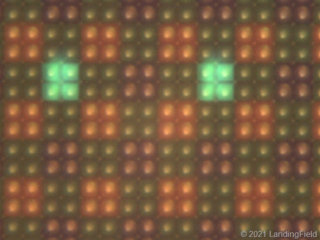

After tearing down the sensor and examining it under a microscope, Landingfield discovered that the sensor uses what the publication describes as a “2×2 binning” design, which leads to the conclusion that the sensor in the camera — the IMX510 — actually has a 48-megapixel native resolution.
The RGGB Bayer pattern is spread across a 4×4 grid. After sensor readout, the four pixels in each of the same color are then combined digitally to give one pixel before sending out on the SLVS-EC interface. This could explain the increase in read noise. From my knowledge, none of Sony DSLR CIS supports charge binning due to limitation in its pixel architecture. By combining four pixels digitally, you would increase the noise variance by four and hence read noise almost doubles (sqrt to RMS).

IMX510 (top) 2×2 binning pixel under a 50x objective microscope. | LandingField

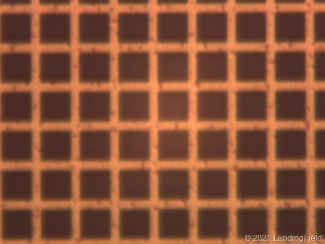

FSI single pixel in IMX235 under a 50x objective microscope. | LandingField
