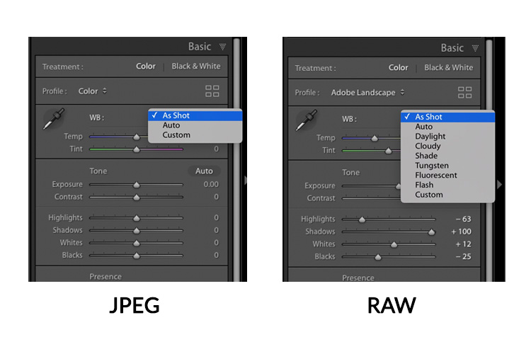

Q. Why is it that sometimes, when I go to the White Balance presets menu in Lightroom, I get a list of a bunch of different white balance presets, and sometimes I only get two choices: Auto and Custom?
A. It’s because one time you were looking at the White Balance presets for a RAW image, and the other was a JPEG or TIFF. You only see that longer list of preset choices (seen above right) when you’re working on a RAW image — if you click on the JPEG or TIFF image, you’ll only see Auto and Custom (seen above left) as your choices because the white balance you chose in in the camera is already assigned to JPEGs and TIFFs. With a JPEG, you don’t get all those other choices like you would from a RAW image where the white balance preset isn’t already “baked in” (so to speak).

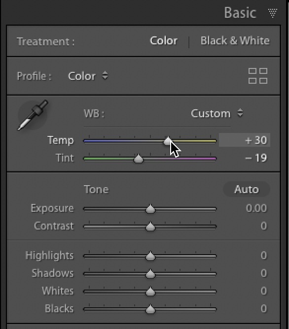

Q. I heard you have to shoot in RAW because if you don’t, you can’t change your White Balance. Do I have to switch to shooting in RAW?
That’s me adjusting the Temperature and Tint White Balance on a JPEG image.
A. This is actually an age-old myth — you absolutely can change the white balance for JPEG or TIFF images, no problem. I think this myth started because when you shoot in JPEG, you don’t get all the White Balance presets like you do for Raw images (you only get the Auto preset, as I mentioned above). That doesn’t mean you can’t change the White Balance. You still can change it using the Temperature/Tint Sliders and the White Balance Eyedropper tool (and I personally use those two the most anyway).

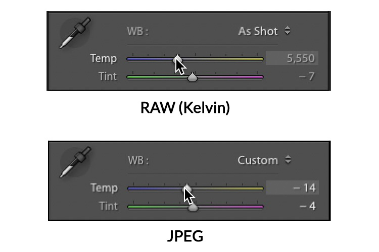

Q. I notice that when I’m adjusting the Temperature and Tint sliders, sometimes I’m adjusting the Kevin amount, and other times it’s just positive and negative numbers like +14 or –12. Why is that?
A. It’s that whole “RAW vs JPEG” thing again. When you adjust the Temperature settings on a RAW image in Lightroom, you’re adjusting the Kelvin temperature, so you’re getting the same familiar Kelvin settings you’d have if you chose a custom white balance on your camera. When you shoot in JPEG, you’re adjusting a white balance already embedded in your file, so you’re not adjusting Kelvin numbers.
![jpegraw.jpg](/proxy.php?image=https%3A%2F%2Flightroomkillertips.com%2Fwp-content%2Fuploads%2F2020%2F09%2Fjpegraw.jpg&hash=34d27c27a5a842731c88908fb7db6458)
![JPEGwb.jpeg](/proxy.php?image=https%3A%2F%2Flightroomkillertips.com%2Fwp-content%2Fuploads%2F2020%2F09%2FJPEGwb.jpeg&hash=0276a123c15a4875cadde05b5d03521a)
![whitebal.jpg](/proxy.php?image=https%3A%2F%2Flightroomkillertips.com%2Fwp-content%2Fuploads%2F2020%2F09%2Fwhitebal.jpg&hash=f6ff74520bde9135c500830446cc4162)
