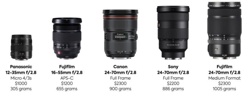

The physical specifications and prices for lenses generally, but not always, increase with sensor size. There are far too many lens options to compare in detail here, so I will compare a common zoom lens of 24-70mm (full-frame) to give a general idea of the variances in lens specifications in the different sensor sizes. See the image below for the size, weight, and price comparisons of these lenses.
