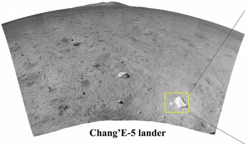

A wide-angle photo showing the section of the Moon that was analyzed for water by China's Chang'e 5 lunar lander

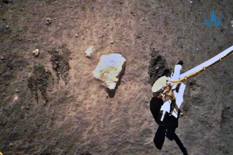

A photo by the Chang’e 5 lunar lander showing the patch of ground on the Moon it analyzed containing soil and a rock.

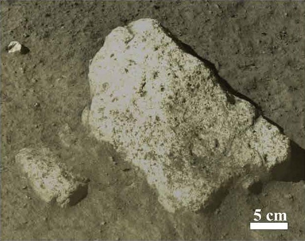

A close-up photo of the soil and rock that were analyzed with the lander's onboard lunar mineralogical spectrometer
A close-up photo of the soil and rock that were analyzed with the lander’s onboard lunar mineralogical spectrometer.

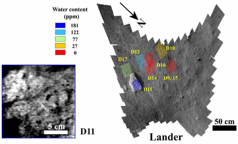

The resulting data clearly showed water content in both the soil and the lightweight and porous vesicular rock, though it was not much: less than 120 ppm was detected in the lunar soil, and about 180ppm was detected in the rock. This is the equivalent of 120 grams of water (~4.06 fluid ounces) in 1 ton of the soil and 180 grams of water (~6.09 fluid ounces) in 1 ton of the rock.
The water content readings from various patches within the area analyzed by the lander
The water content readings from various patches within the area analyzed by the lander. The highest water content was found in the rock.

A photo of the rock and soil at the landing site that were analyzed and collected by the lander
A photo containing rock and soil at the landing site that were analyzed and collected by the lander. Photo via Xinhua.
