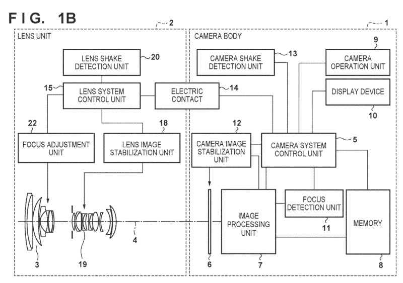

Canon has applied for a patent that would allow a camera to use its in-body-image-stabilization (IBIS) to approximate the effects of an anti-aliasing filter. The idea is similar to how sensor-shift multi-shot works, but in reverse.
The application — which was found by Northlight Images and shared by Canon Rumors — notes that Canon is proposing a way for the sensor to shift during image capture in such a way that it approximates how an anti-aliasing filter works.
As Northlight Images writes, the idea “uses fine movement of the sensor stabilization system to perform one of the jobs of the anti-alias filter for the AF system and address problems of sampling and spatial aliasing. A version for DPAF and contrast AF is discussed… The fine control of sensor positioning is also part of a multishot super-resolution solution, where a traditional AA filter might also get in the way.”

Chart from Canon’s patent.
