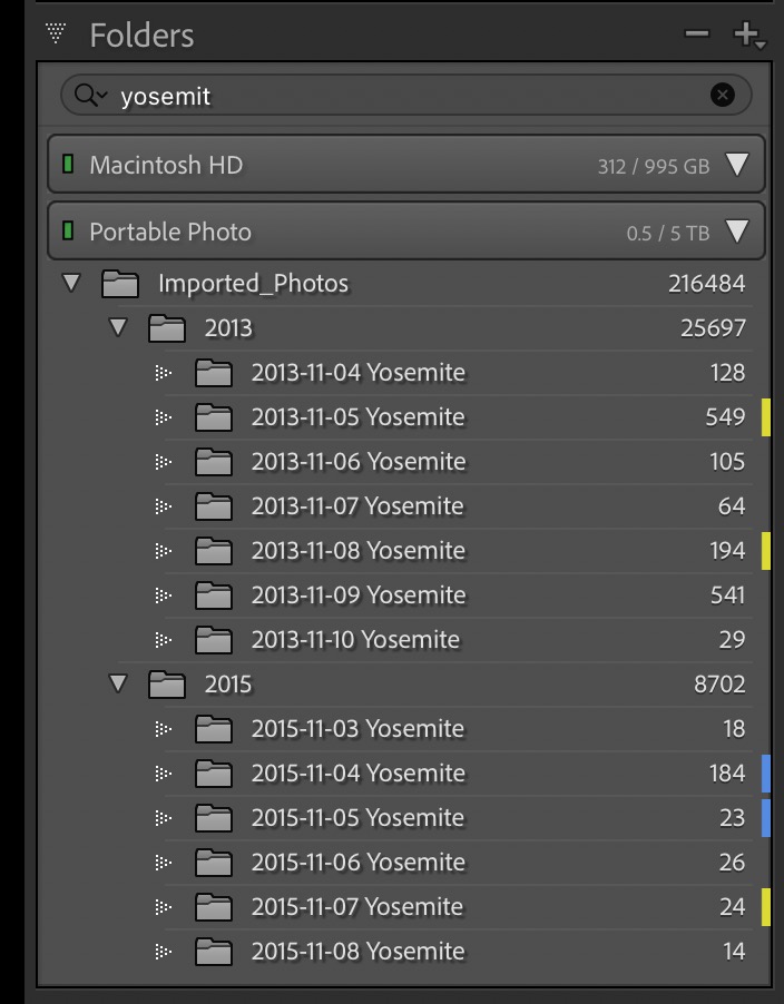

If you’ve identified where the photos are on your drive, you can take note of the folder location and look in your Folders panel to see if that folder is present in LrC. An easy way to find a folder in the Folders panel (even if it is nested deep within other folders) when you know the folder’s name is to simply type that name in the field at the top of the Folders panel. As you type the panel will be filtered to only show folders that match the characters you’ve entered. If the folder is in the catalog it will appear no matter where it may have been moved to on the drive.

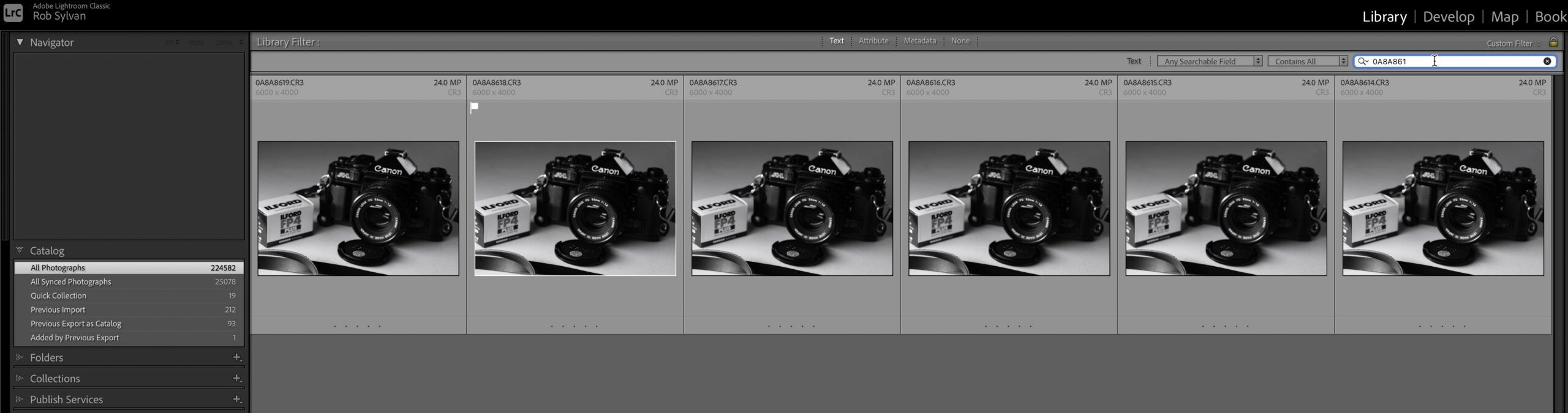

Alternatively, if you know the file name of any one of the missing photos click All Photographs in the Catalog panel, press G for Grid view (if not there already), then you can click the Text field in the Library Filter bar above thumbnails in Grid view, then enter the file name in the resulting field to filter the entire catalog and only show files that match that text. Change the drop-down menu to Filename instead of the default Any Searchable Field if you are getting unrelated results.
