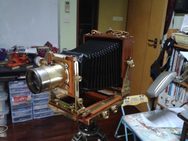

The lens that you saw that morning , is a "copy" Petzval lens.
meaning, the construction of this lens was copied from some branded manufacturer. The lens itself does not carry any brand at all.
There are 3 elements in the lens , and you can interchange their position to create different effects.
The focal length is 8.5" ( about 210mm )
aperture is F/3.7
nothing is written there, you just have to measure all the parameters yourself.
you are right, most Petzval lens does not comes with shutter. I am using lens cap as the shutter itself.
Some Petzval lens comes with "water house", which means , you can insert a card with a hole into the slot to reduce the aperture.
By doing so, the image has longer DOF.

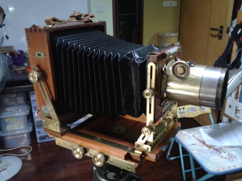

as you can see above, my lens does not comes with a flange, and I have to improvise something to mount the lens onto the lens board.
